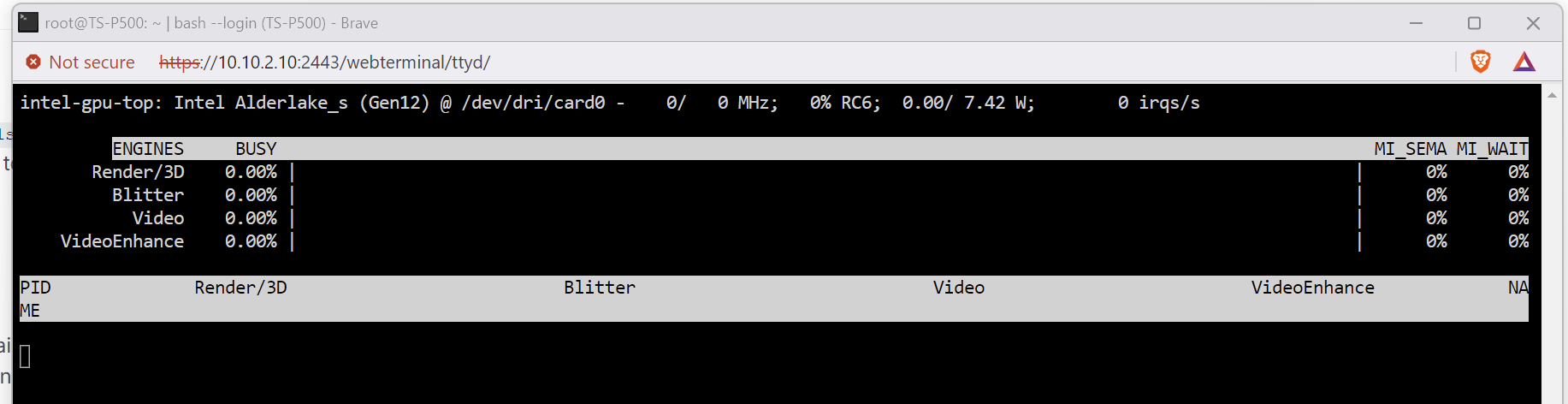

I'm also having the same error as above and changing refresh to 2000 doesn't fix it. I've seen ich777 has updated his intel gpu top plugin but that also hasn't fixed it.
Running the intel_gpu_top command via terminal gives me all the correct information. Do I still need to try updating?

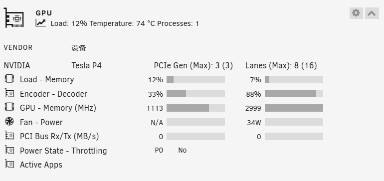

Quesation about GPU Statistics Plugin for nvidia graphic card (tesla p4)
When I am using emby (hardware acceleration), the plugin seems to miss some info such as Active Apps as shown in the graph.
When I use the nvidia-smi command, the terminal shows:
| NVIDIA-SMI 555.58.02              Driver Version: 555.58.02      CUDA Version: 12.5     |
| GPU  Name                 Persistence-M | Bus-Id          Disp.A | Volatile Uncorr. ECC |
| Fan  Temp   Perf          Pwr:Usage/Cap |           Memory-Usage | GPU-Util  Compute M. |
|                                         |                        |               MIG M. |
|   0  Tesla P4                       Off |   00000000:06:00.0 Off |                  Off |
| N/A   81C    P0             32W /   75W |     535MiB /   8192MiB |      9%      Default |
|                                         |                        |                  N/A |
| Processes:                                                                              |
|  GPU   GI   CI        PID   Type   Process name                              GPU Memory |
|        ID   ID                                                               Usage      |
|    0   N/A  N/A     28524      C   /bin/ffmpeg                                   532MiB |
Really appreciate for your help!

4 hours ago, tonywang1201 said:
Active Apps
What is the active app that you are runnig?
Is it just ffmpeg or is it really Emby?
Ut is really hard to detect in case of Emby because it uses ffmpeg.
Did you yet try Jellyfin if it also is the same there?

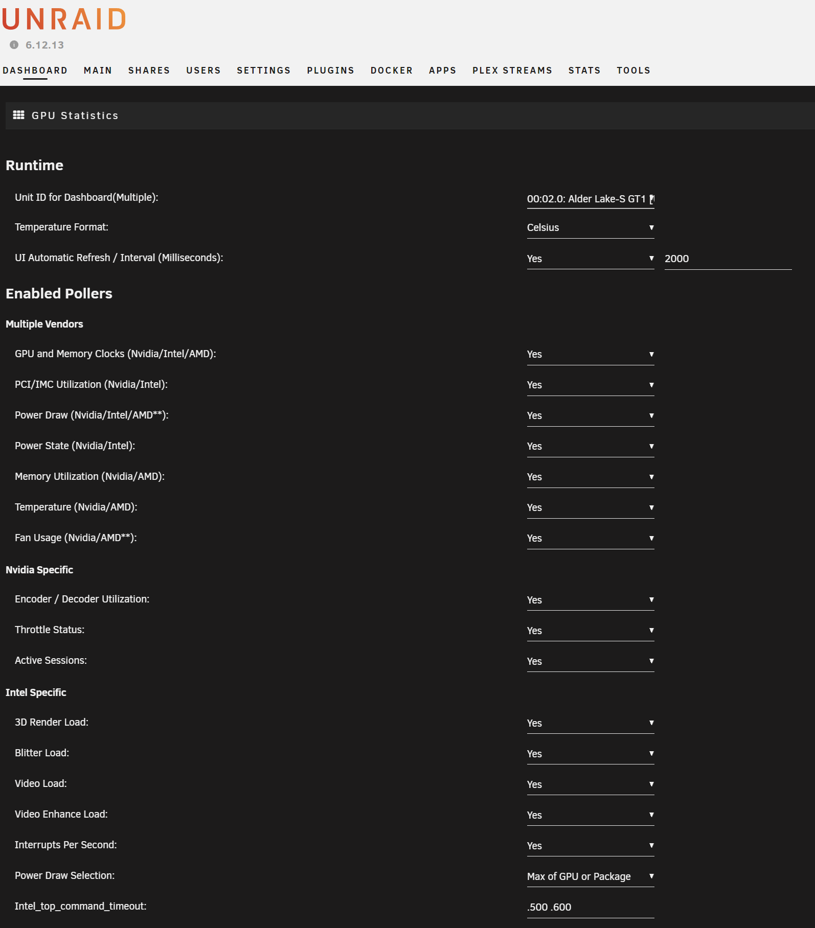

the refresh rate is 2000ms already  but it didnt solve the issue. Prob is my Intel GPU Top was the latest on the community apps. do i need to manually update the reposition?image.thumb.png.2746f39676a1f4a2afdb581b4b6f75bb.png
Change intel top command timeout to .7 1.3

Change intel top command timeout to .7 1.3 and refresh to 2000

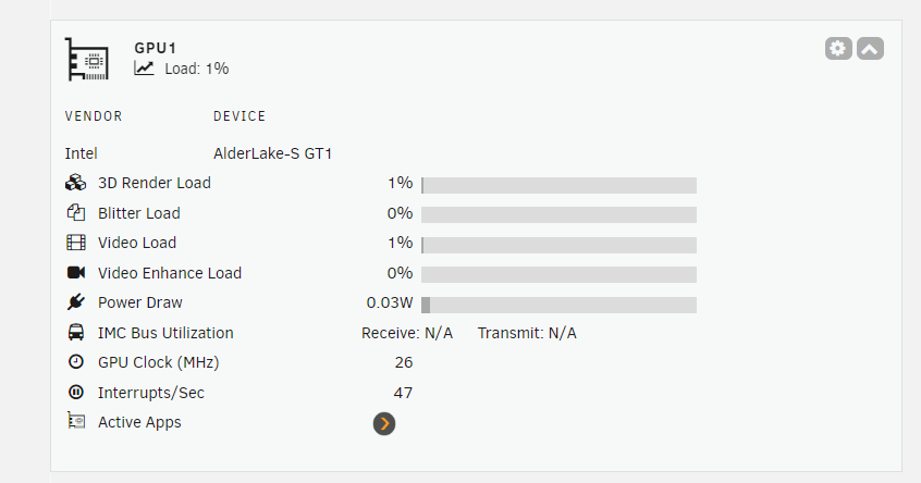

On 10/18/2024 at 7:23 AM, irckenny said:
Increasing values as your suggestion the plugin started working again, except for Power draw graphic section that is always showing 0 value but with full "white" bar after first use of GPU hardware decoding.
This is a long standing issue (...actually caused by Intel-GPU-Top) and the people at intel-gpu-tools couldn't reproduce this either but I assume they don't have their computers running as long as we have our Unraid servers running.
If you reboot the bar will go back to normal but after a few days show exactly the same behaviour.

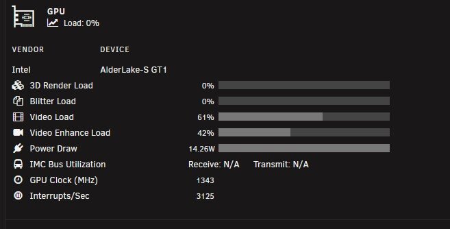

When upgrading today (both GPU stats + intel top) I got same error (cannot parse).
Modifying timeouts to 2000 - .7 .3 seems to fix it, but GPU load is always 0
I don‘t understand, you see in your screenshot you are indeed using the iGPU (Video & Enhance).
Depending on the tsak that you throw at your iGPU you will see different utilisation levels.
I mean the header. I'm pretty sure before was not showing all the time 0% GPU load
Same reproduction in a tiny pc, with an Intel 8th gen:
Load at top is the same as render load.
