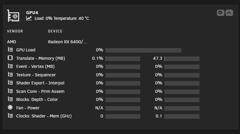

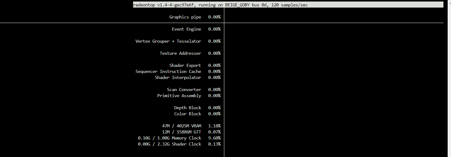

Running unRAID 7.0-beta3 (Beta3 is when the issue started as it was fine with Beta2) with an AMD RX6400 GPU
Dashboard shows 100% load on the GPU when idle
If a docker (Such as Plex) starts using the GPU it will display accurately until it becomes idle again and it will jump back to 100%
radeontop also shows 100% usage

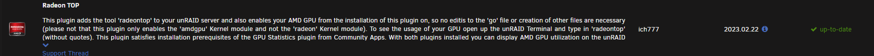

Are you running the latest version of Radeon top plugin? My RX6400 reports ok.
Yes, my radeontop is the latest version.
This morning it was showing 0% load on idle until I did something that required the GPU which also displayed correctly and when it came back to idle it jumped back up to 100%. I'm expecting it'll correct itself throughout the day again if the GPU if left idle long enough.
It doesn't seem to be causing any issues it just seems to be cosmetic.

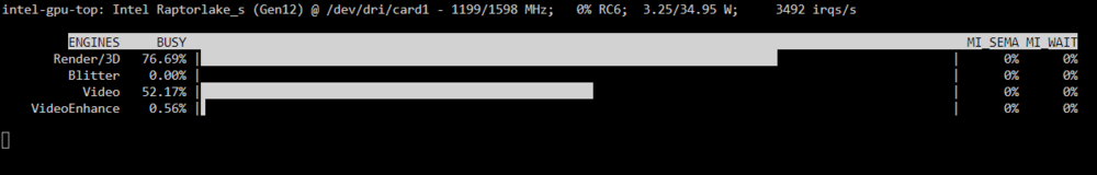

Unraid 6.12.13 / Intel 14700 iGPU detected as Raptorlake / GPU-stat 2024.10.16 / intel-gpu-top 2024.06.27
Unfortunately, the apps aren't displayed for me either.
Frigate and Jellyfin should actually be displayed for me.
With intel-gpu-top, I can see a load of the iGPU, but the data regarding the PID isn't displayed. It's completely missing.
I suspect that's also the error why GPU-stat isn't showing me the apps..?
Is there perhaps a solution for this?
If intel GPU top is not showing Any data in the clients then that will not show in dash board.
Can you provide screen print for intel GPU top?

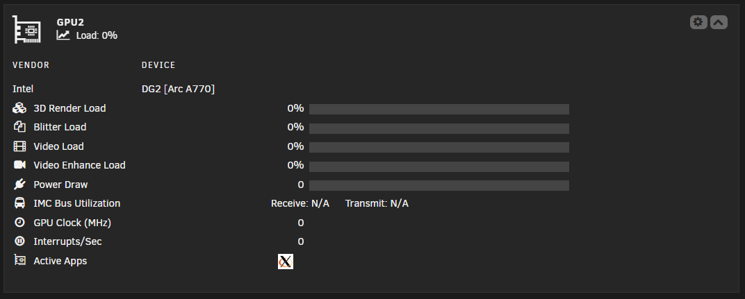

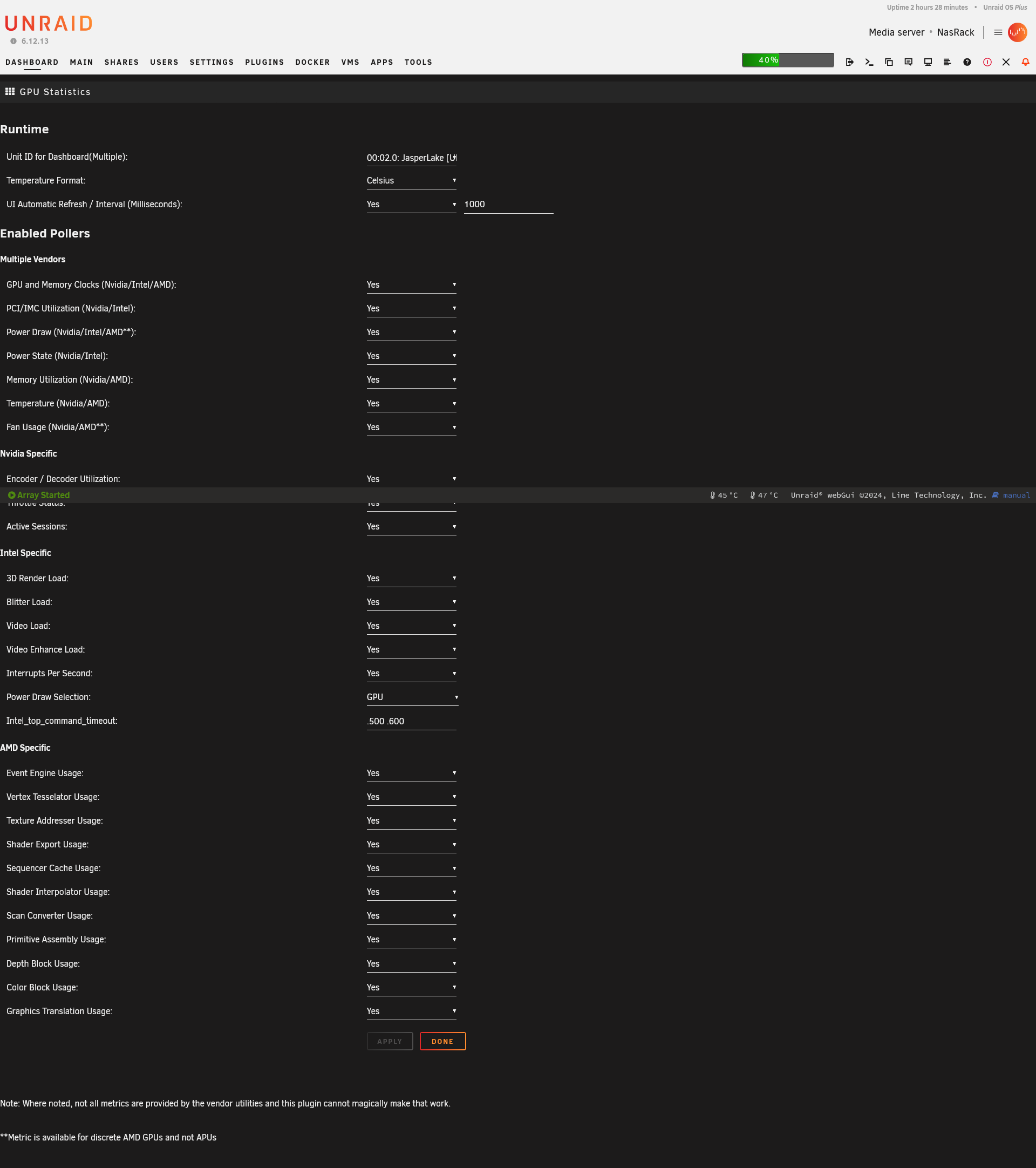

Hi there.
been using gpu stats for quite some time. great plugin.
just wondering, is there no icon when unraid is in GUI Mode?
thanks!

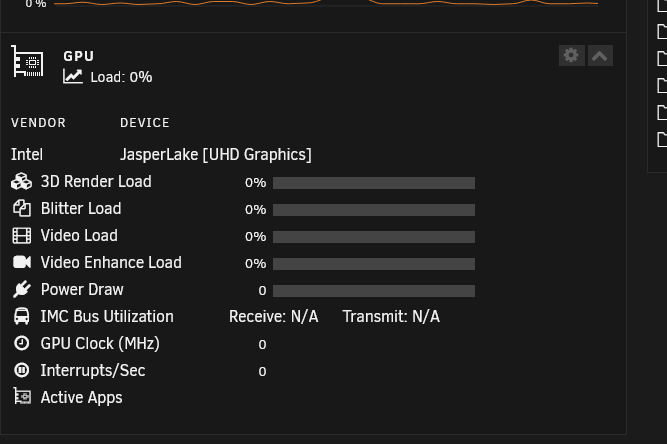

Hi!
Just updated at version dated 2024-10-16 and all data  in dashboard plugin disappeared/stop working: only showing that message
Vendor command returned unparseable data.

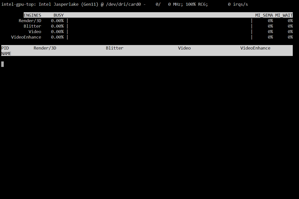

Screenshot2024-10-17at16-32-26NasRack_Dashboard.png.d2a3332090ef10b73e888ede0419be16.png
here my Intel_GPU_top screen print:
Screenshot2024-10-17at16-34-52root@NasRackbash--login(NasRack).thumb.png.fdaa87acd1b4bb854032ec2481ee373a.png
Before the update all was working like expected.
Any suggestion? A way to rollback to previous version?
Thank you in advance.
3 hours ago, i1mran92 said:
Hi there.
thanks!
Xorg is not in the application list will look to add.
What are the timer values in the settings?
Hi, thanks for reply, here screenshot of my plugin settings. I dont see any "timer" item in my setting.
Screenshot2024-10-17at19-35-30NasRack_GPUStatSettings.thumb.png.5821e2c13fb68fd3f1b889cb484c89a6.png
Change refresh to 2000 and see if that works, if still see an error increase intel gpu top to .7 1.3
4 hours ago, i1mran92 said:
Hi there.
thanks!
Will add to the next release, just need to look for at the icon, will show as X due to using xorg.
Increasing values as your suggestion the plugin started working again, except for Power draw graphic section that is always showing 0 value but with full "white" bar after first use of GPU hardware decoding.
Any other tip?
After conbfig modification:Screenshot2024-10-18at07-19-06NasRack_Dashboard.png.fffd449197c1f9b92cba71517db26535.png
After first GPU usage:
Screenshot2024-10-18at07-29-15NasRack_Dashboard.png.93300de04e499ab22b37b0963a3e9a20.png
And just one more information please: what "intel_top_timeout_command" values .7 1.3 means?
Thank you!

It is the internal way the intel_gpu_command has to be run as it does not just output a single JSON with the -j option so to code has to use the timeout function with those values. I will look into the bar issue can you provide the file /tmp/gpujson contents?

On 10/17/2024 at 4:36 PM, irckenny said:
Hi!
I have exactly the same issue with an alderlake cpu.
Have you read the answer to that too:
I did miss the increace. After modifying it, it is working again. Thanks for the help.
