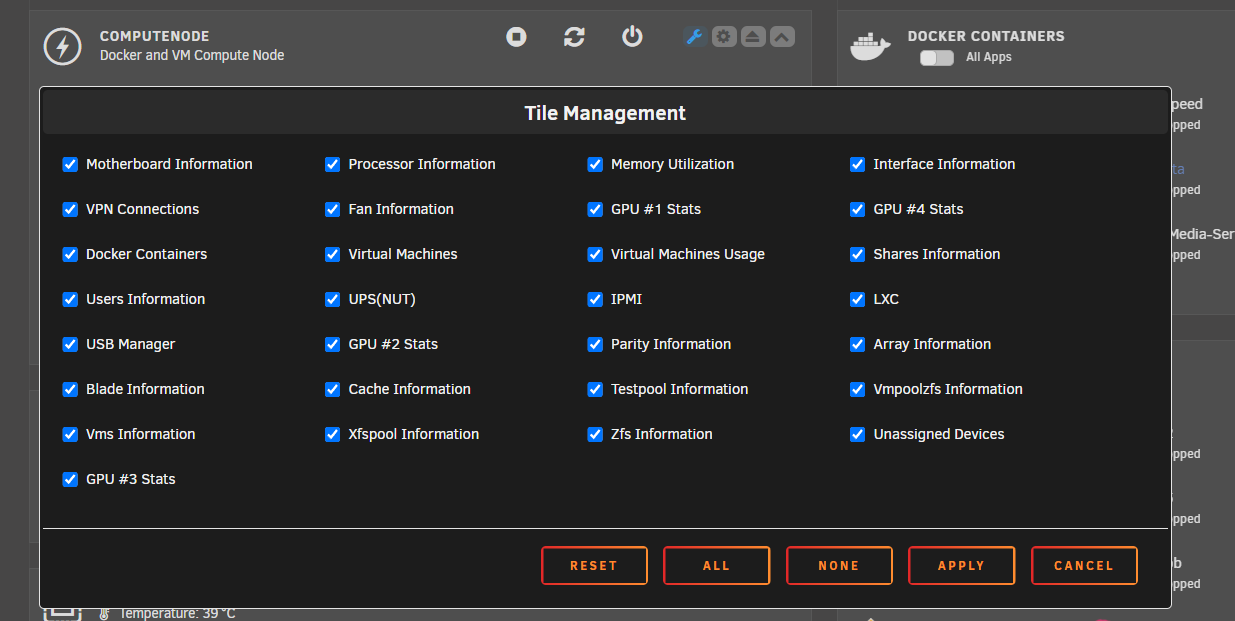

Had two gpu inside and now back to newer single one taking more slot space but after changing the cheack box for the new one had only gpu2 empty in the dashboard after a reboot new gpu still selected in settings but nothing displaying in the dashboard now?
Any ideas?
Any ideas?
Now added a second GPU with the same name and only see GPU2?
Have you hidden the panel. Click on padlock to unlock spanner should appear on the system panel. Click and check panels selected.
Thank you i did even know that was a option.  Not sure how that happenend but it fix it.
again thank you!

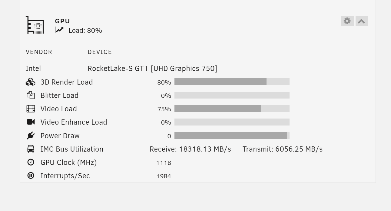

Hello,
does anyone know why PowerDraw always displays a zero? I've had this problem since I changed my CPU. Before it was a UHD 630, now it's a UHD 750. Before it showed me values there. I tried several options in the settings, reinstalled it etc. but it does not fix my problem.
Thank you.

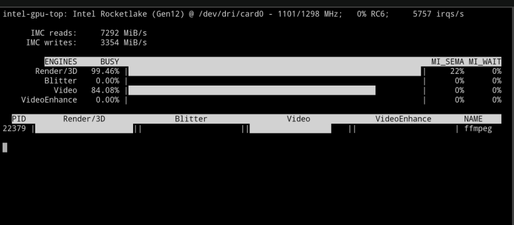

Not all iGPUs support displaying the power draw, please open up a Unraid terminal and issue: intel_gpu_top and take a screenshot.
Thats how it looks if I my igpu transcode
Your „new“ iGPU doesn‘t provide the power draw.
Okay strange. But it is what it is I guess :D
2 minutes ago, donniedarko83 said:
Okay strange.
Nothing too strange since if you read the last few pages back a few people reporting the same with newer iGPUs.

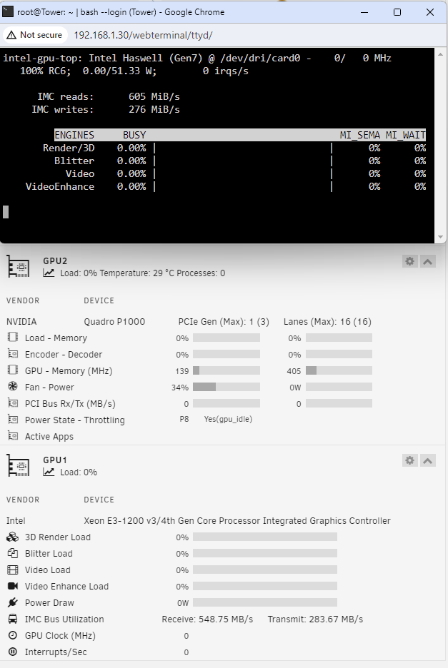

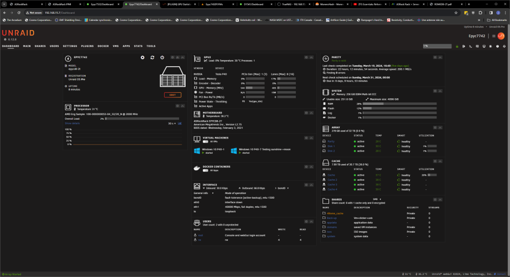

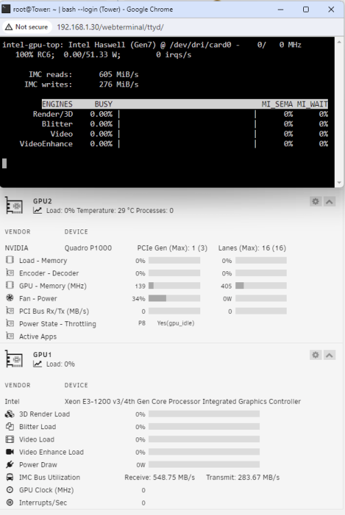

I've skimmed through most of this thread and am having similar issues - GPU stats dashboard frozen. It's been a bit on/off - like it works for about 5 minutes after I updated to 6.12.9, but just stopped at some point and haven't been able to get it working since. Tried all the high-level trouble-shooting I've read in this thread - making sure it's the newest CA version, uninstall/reinstall, browser cache/cookies removed etc.
Dashboard screens were take while I was playing a plex video that has used GPU trancoding in the past.
GPU is just a little Quadro P1000.
Have tried to attach as much as I could - hopefully enough there to help diagnose.
NB: The CPU in this system is an i7-4790. The Processor widget on the dash recognises this correctly, so unsure why the GPU Stats widget is registering a Xeon E3-1200? Unless it's just the same tag of the E3 and 4th gen intels?
tower-diagnostics-20240406-1412.zip cat tmp gpujson.txt intel_gpu_top -J -d pci slot=0000 00 02 0.txt timeout -k .500 .600 intel_gpu_top -J -s 250 -d pci slot=0000 00 02 0.txt dmesg grep i915.txt timeout -k .500 .400 intel_gpu_top -J -s 250.txt cat gpustat.cfg.txt nvidia-smi -q -x -g GPU-0bdaba85-62de-f0c2-97a7-0f305cdc625e.txt
Edited by CouchPawTayTow
re: Xeon mentioned in GPU stat widget

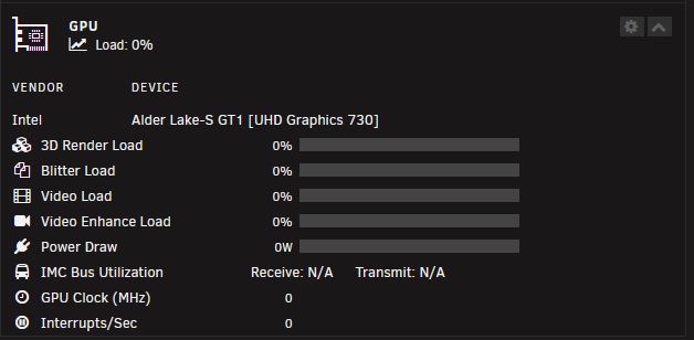

My Gpu Stats are closing right after I've opened them. Everything is up to date, only Unraid is on 6.12.8 because I tried if it is working when I go back. It shows me, that the "Gpu not available bound to Vfio or in use in a VM" I have no VM running and it is not bound in VFIO. Is there a workaround to get this fixed? I reinstalled everything more than once but the issue still exists.
Can you provide the results of
cat /tmp/gpujson
Here is the result:
Time = Fri, 12 Apr 2024 17:59:00 +0200
{"00:02.0":{"clock":0,"fan":"N\/A","memclock":"N\/A","memutil":"N\/A","memused":"N\/A","power":"0W","powermax":"N\/A","rxutil":"N\/A","txutil":"N\/A","temp":"N\/A","tempmax":"N\/A","util":"0%","vendor":"Intel","name":"Alder Lake-S GT1 [UHD Graphics 730]","3drender":"0%","blitter":"0%","interrupts":1,"powerutil":"0%","video":"0%","videnh":"0%","vfio":false,"vfiochk":false,"vfiochkid":"0000:00:02.0","panel":1}}
1 hour ago, Chriss_93 said:
Here is the result:

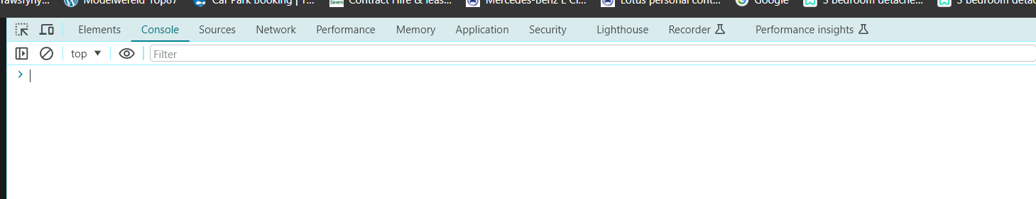

The data is correct that message should be seen, If you press F12 do you see any errors in console.
