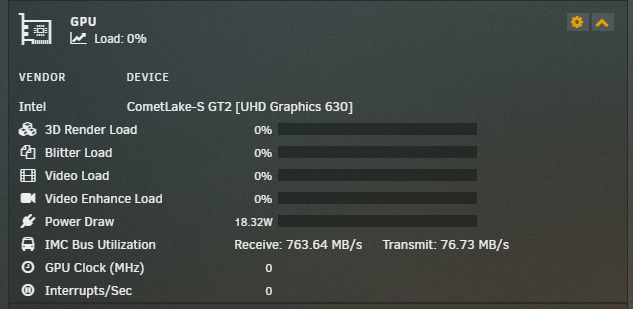

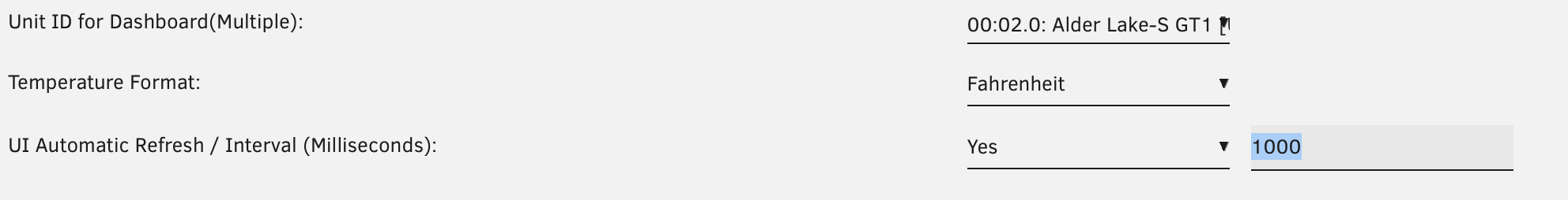

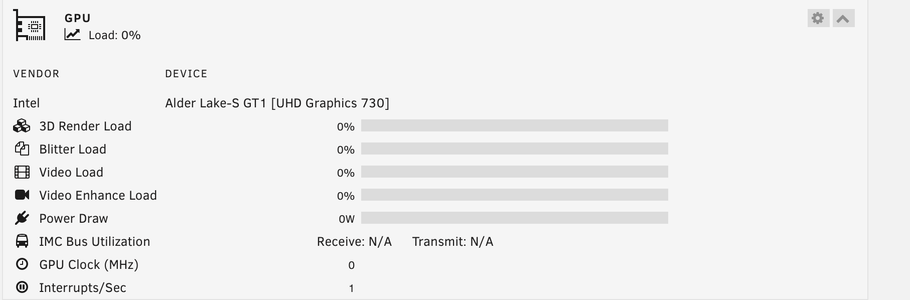

GPU Stat lets me select my Intel 730 i915 CPU from my I5 12000, but the choice doesn't stick.  When I go to the Dashboard, it says that I haven't selected my GPU.  Any ideas what can cause this?
The minimum inrerval is 2000ms not 1000ms
Wow, that fixed it - thanks so much!  It's weird that the default is 1000ms - I didn't change that field.
One last thing - although it shows up in the Dashboard now, I notice that there are no statistics - as though it's not updating.  Does it only show activity when it's transcoding?
Edited by mklcolvin
Additional issue to original post
Yes because otherwise the iGPU is idle as you can see in your screenshot.

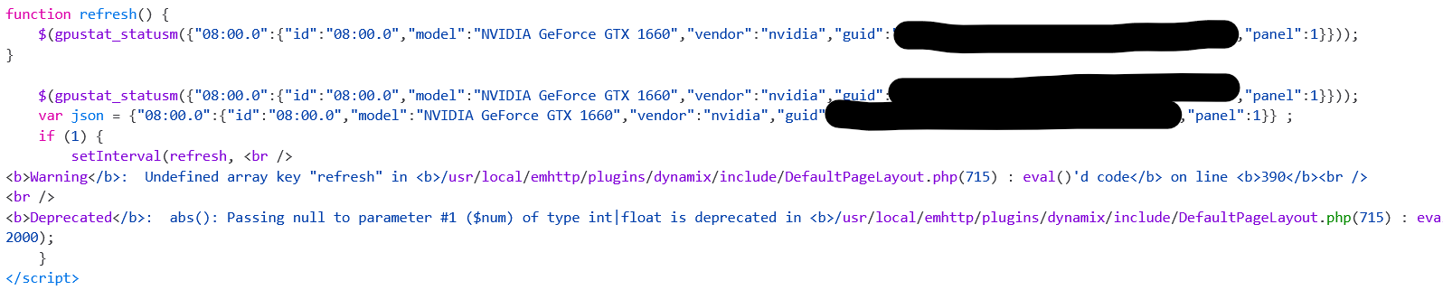

Hey Simon, I'm getting a couple of these warnings when on the frontpage dashboard:
[23-Jun-2024 14:04:29 Europe/Berlin] PHP Warning:  Undefined array key "refresh" in /usr/local/emhttp/plugins/dynamix/include/DefaultPageLayout.php(715) : eval()'d code on line 390
[23-Jun-2024 14:04:29 Europe/Berlin] PHP Deprecated:  abs(): Passing null to parameter #1 ($num) of type int|float is deprecated in /usr/local/emhttp/plugins/dynamix/include/DefaultPageLayout.php(715) : eval()'d code on line 390
I think they are coming from this line (it maybe needs a check if $display['refresh'] exists before doing max/abs) https://github.com/SimonFair/gpustat-unraid/blob/8b3fd1f2631dd9891aa1224ebec5df3d0df8bc0b/src/gpustat/usr/local/emhttp/plugins/gpustat/gpustatus.page#L359 - thanks! ;-)
Edited by Rysz
Thanks will take a look. Which vers is that on?
2024.06.21 🙂

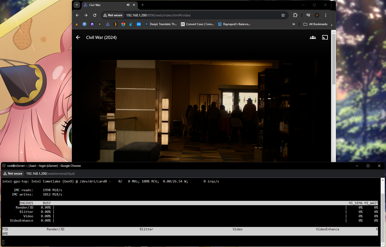

please help i cant get render information from gpu statistics for my intel gpu. nvidia work perfectly.
Thats because nothing is actually transcoding and it seems you are using direct play so nothing wrong… 😅
Try to force a transcode by clicking the gear icon in the lower right corner in the Jellyfin player, select Quality and set it to something lower than the input media.
3 hours ago, ich777 said:
Thats because nothing is actually transcoding and you are using direct pkay. so nothing wrong… 😅
alright. my bad
Any news on this? 🙂
The GPU dashboard is broken for me right now because of PHP warnings:
It only works when setting the PHP error reporting level to "All Categories" so PHP errors are not shown on the screen, as opposed to the default PHP error reporting level where it displays them on the screen.

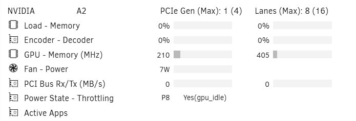

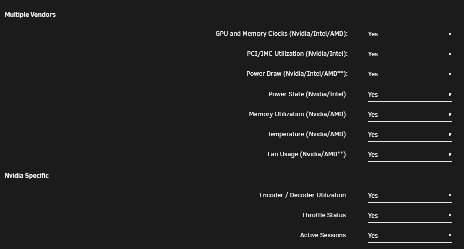

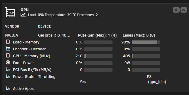

Hi, I was curious why the active apps seems to be always empty on the dashboard.
If I run nvidia-smi -q I get a process list with the application and vram in use.
I have everything enabled in the nvidia section and general
Thanks!
in your current screens it doesnt look like anything is currently using de/encoder ...
may rather post a screen while you transcode and what should be shown ? plex, emy, jelly, ffmpeg, ...
On 8/14/2024 at 3:11 PM, Rysz said:
Any news on this? 🙂
Sorry for the delay Rysz, this is fixed in 2024.08.26.
