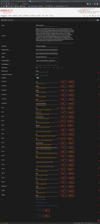

I triple-checked the settings and posted screenshots. After doing some research, I found that others were having this problem specifically when routing through deluge. Attempting to connect through "192.168.0.22:8080"

that's correct. I posted a screenshot of the added port in deluge as well, but the post strangely only shows it if you open the 1st screenshot and navigate to the right ">"
regardless I'll put it here as well

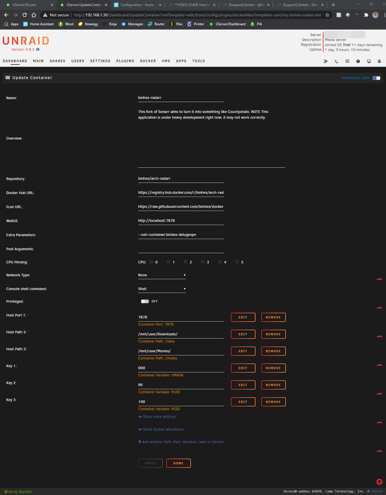

17 minutes ago, touz said:
thank you for the quick reply! yes i did
Post the docker run commands for both containers, redacting passwords if applicable.

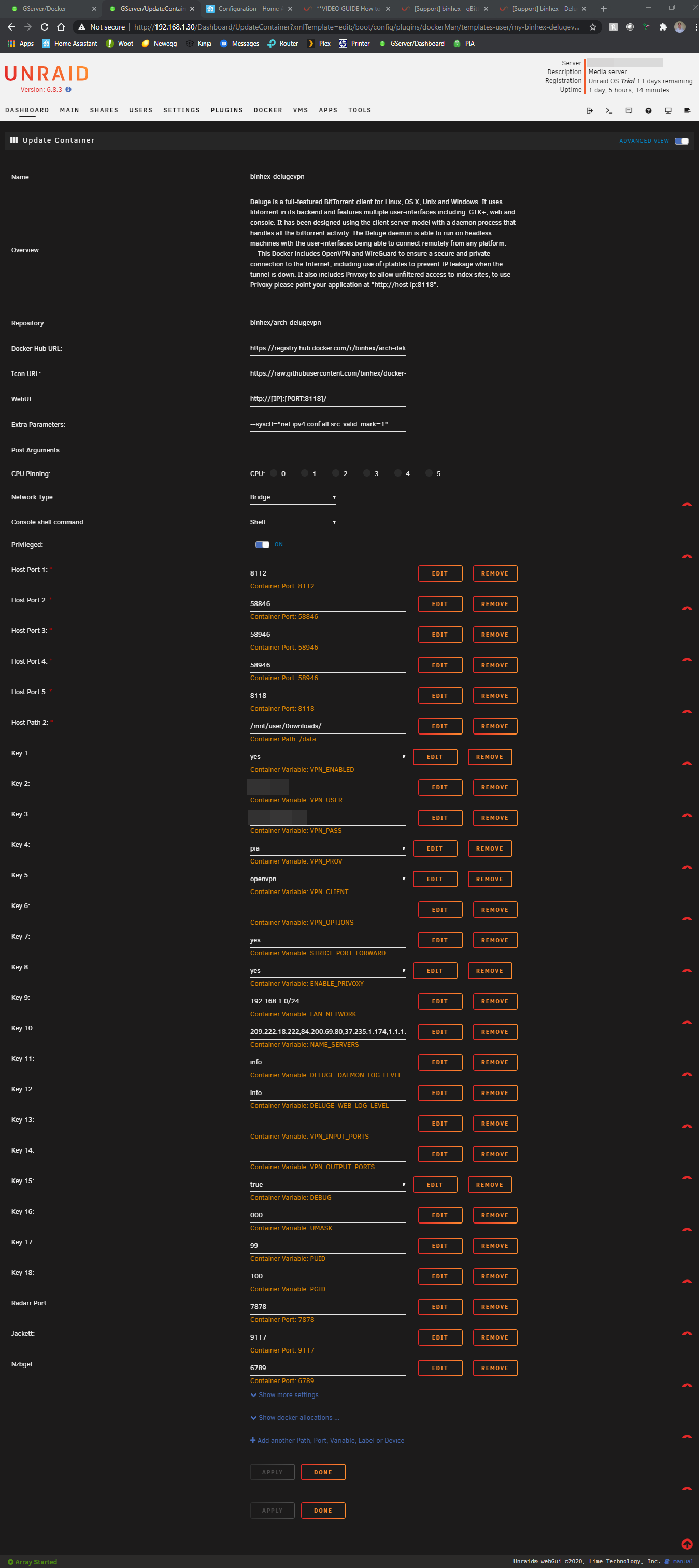

Here is a Screenshot of my Deluge (they are Up-to-Date at the moment) and Radarr config (I hope I don't show anything I shouldn't :D).
To update to docker container, you should first check for the updates under Docker -> Check for Updates (button below the dockers).
314880201_2021-03-1310_08_54-Window.thumb.png.e9c34be9b08efbeb17d86169257206d0.png622783441_2021-03-1310_11_10-Window.thumb.png.b18bb660a04b26f9011544af2d18cb9b.png
And Radarr
I hope this helps.
Edit: The Open WebUI dropdown selection isn't available, when you are using this passtrough. For me, to open for example the Radarr WebUI I am going over the URL http://myserverIP:7878/, where myserverIP is the IP adress of my server. for example 192.168.1.30:7878 in your case (if you are using port 7878 for radarr). Then I added this URL as a Bookmark for ease of access. Plex is http://myserverIP:32400/web/index.html
Edit 2: After it is running and you can access Radarr for example, you need to change (for the passtrhough VPN containers) all the written down server IP adresses to "localhost". here my example of Radarr Download client (don't forget the indexers, there you have to change it too):
You need to change it everywhere in the dockers, which are running through your vpn deluge docker. I've seen you are using Jackett, so there too.
