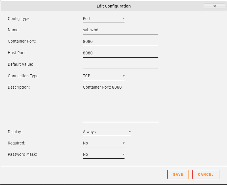

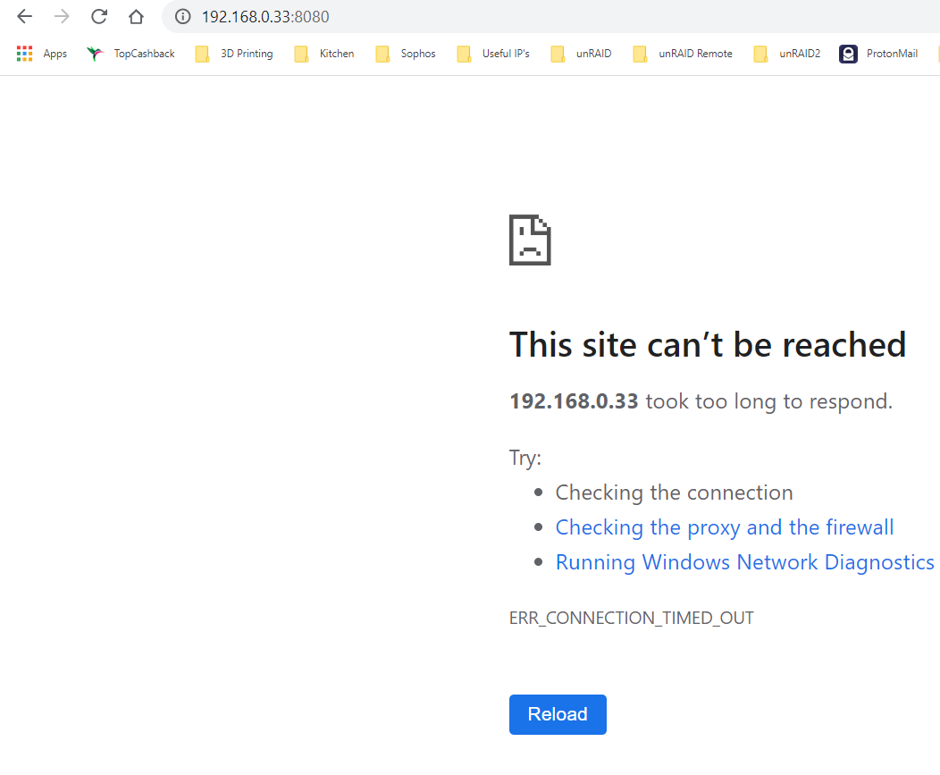

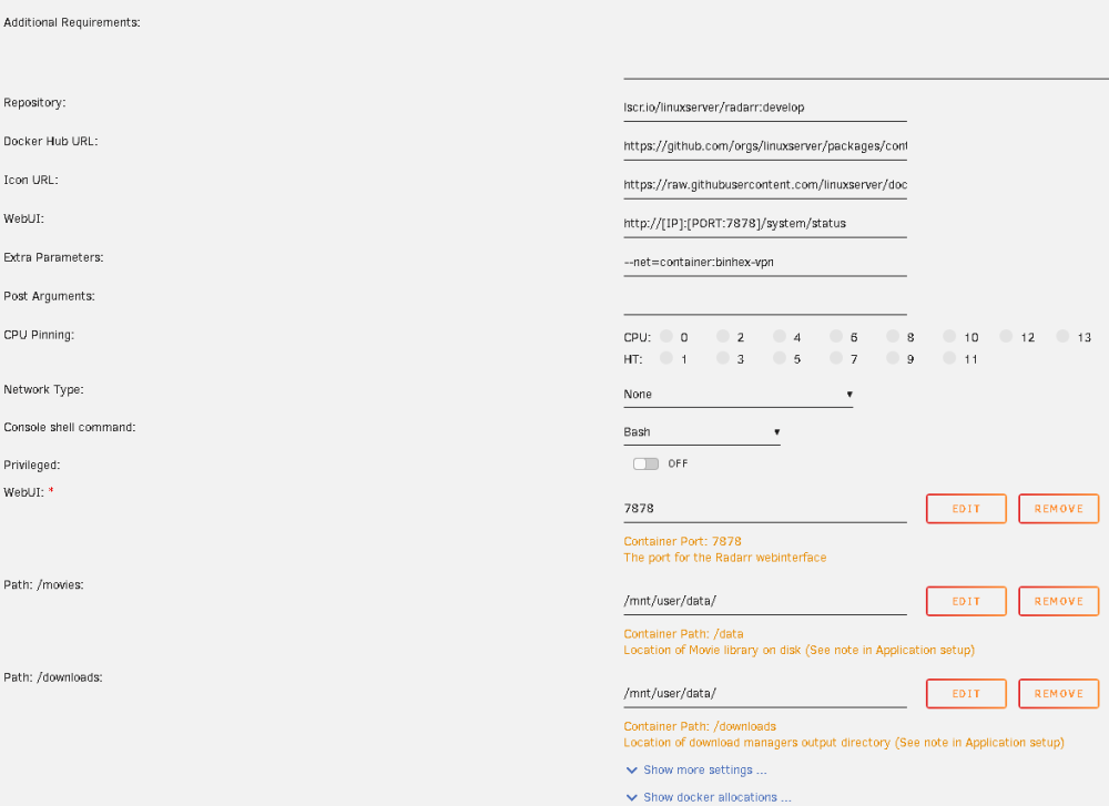

Hi @SpaceInvaderOne
Again, thanks so much for this video! as well as all the others! 😄 I would be lost without them!
I am sure I am doing something wrong but for the life of me cannot see it?
I have entered this in my binhex-delugevpn which is running in bridge mode
this is my sabnzbd docker which has network type set to none
but all I get is this
Any suggestions? 🙂 Thank you and keep safe!
