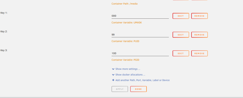

On 3/13/2021 at 1:20 AM, Doublemyst said:
Hi Jayg37
I am using Unraid 6.9 right now. Maybe the missing information comes from different unraid versions (I don't know, I am a newbie). The Unraid 6.9 Version is now the official release, as much as I know and you can update your Server over Tools -> Update OS. Just make a Backup of your thumb drive first .. Just in case. For me the update went smooth as butter :).

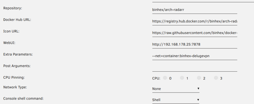

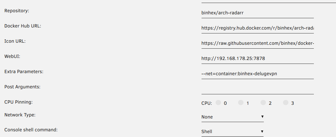

Here is a Screenshot of my Deluge (they are Up-to-Date at the moment) and Radarr config (I hope I don't show anything I shouldn't :D).
To update to docker container, you should first check for the updates under Docker -> Check for Updates (button below the dockers).
314880201_2021-03-1310_08_54-Window.thumb.png.e9c34be9b08efbeb17d86169257206d0.png622783441_2021-03-1310_11_10-Window.thumb.png.b18bb660a04b26f9011544af2d18cb9b.png
And Radarr
I hope this helps.
Edit: The Open WebUI dropdown selection isn't available, when you are using this passtrough. For me, to open for example the Radarr WebUI I am going over the URL http://myserverIP:7878/, where myserverIP is the IP adress of my server. for example 192.168.1.30:7878 in your case (if you are using port 7878 for radarr). Then I added this URL as a Bookmark for ease of access. Plex is http://myserverIP:32400/web/index.html
Edit 2: After it is running and you can access Radarr for example, you need to change (for the passtrhough VPN containers) all the written down server IP adresses to "localhost". here my example of Radarr Download client (don't forget the indexers, there you have to change it too):
You need to change it everywhere in the dockers, which are running through your vpn deluge docker. I've seen you are using Jackett, so there too.

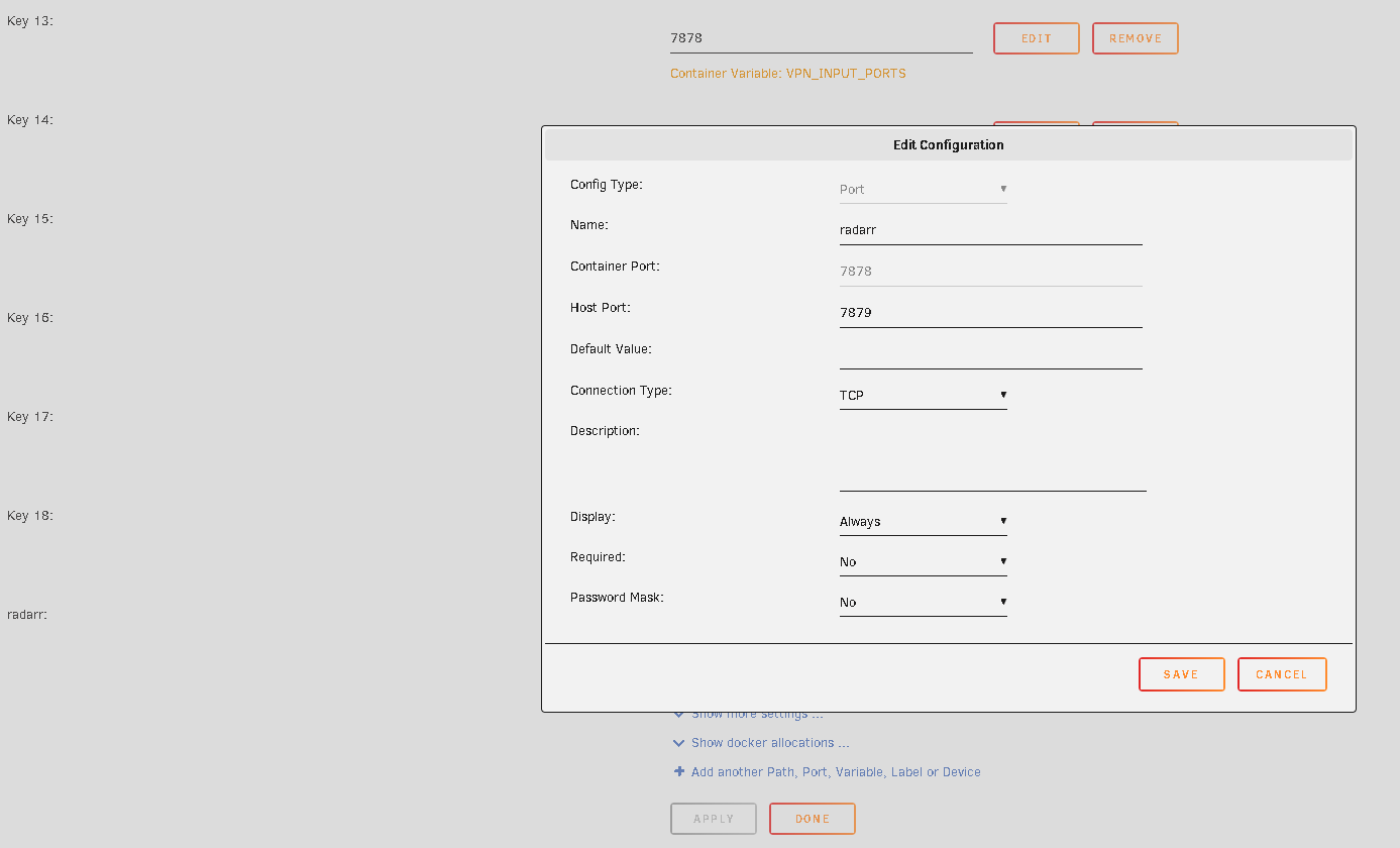

I followed your example and it worked great!  I am on 6.9.2 now and ADDITIONAL_PORTS key is no longer there.  What you see is
VPN_INPUT_PORTS instead.  I entered in all of the ports I need to open up....  same way I would with ADDITIONAL_PORTS.  Thanks!

I have been trying to get traffic routing through vpn-containers to work for several months now and have followed numerous guides and used many different vpn-containers. I can get the routed container to get the correct ip most of the times but I have never been able to access the webui of any routed container.
Is there any special instructions when using a vpn-container that uses wireguard ? I suspect that I need to modify the PostUp/PreDown settings in the wireguard conf.
No. I suspect you have not completed the container firewall port modifications. I suggest reading through binhex's VPN FAQ on github.

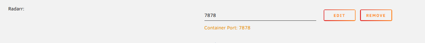

Radarr Settings:
Deluge_vpn (same as privoxyvpn)

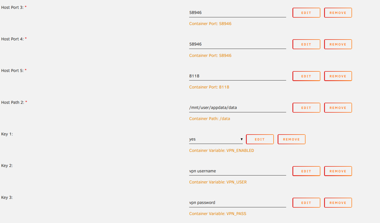

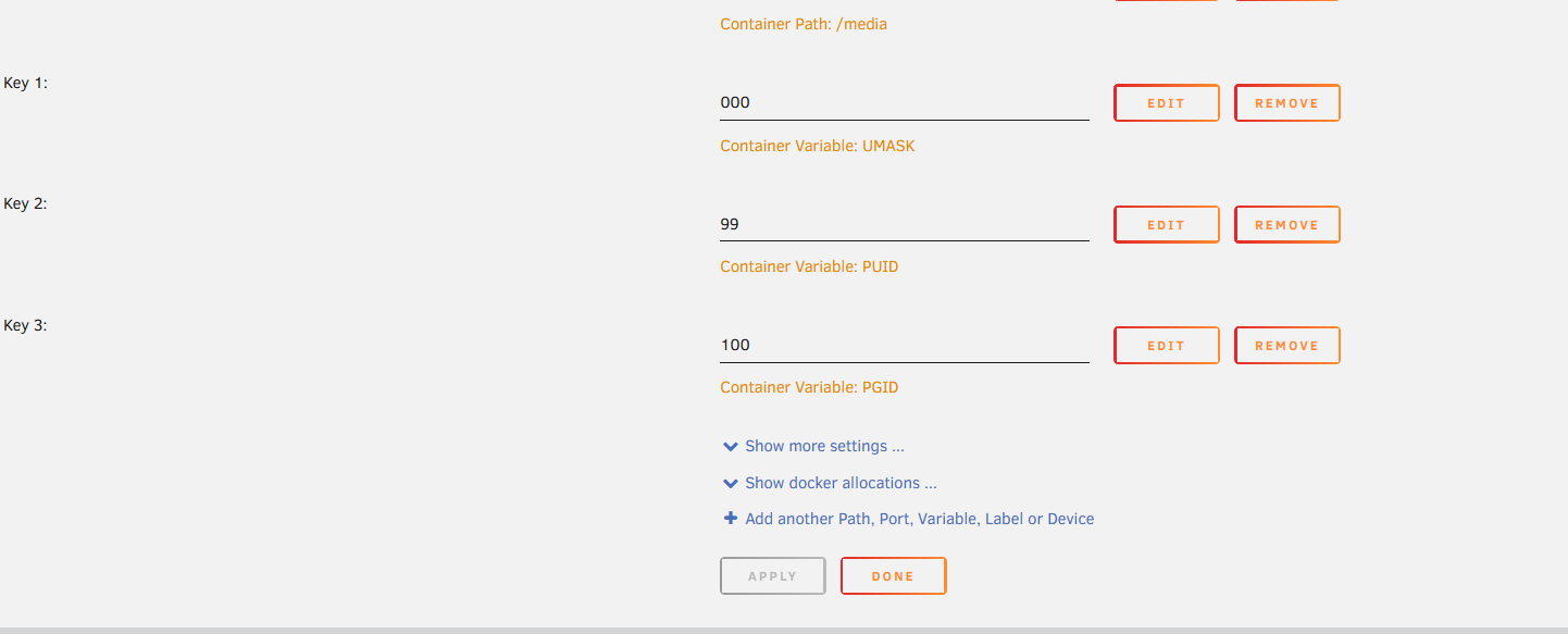

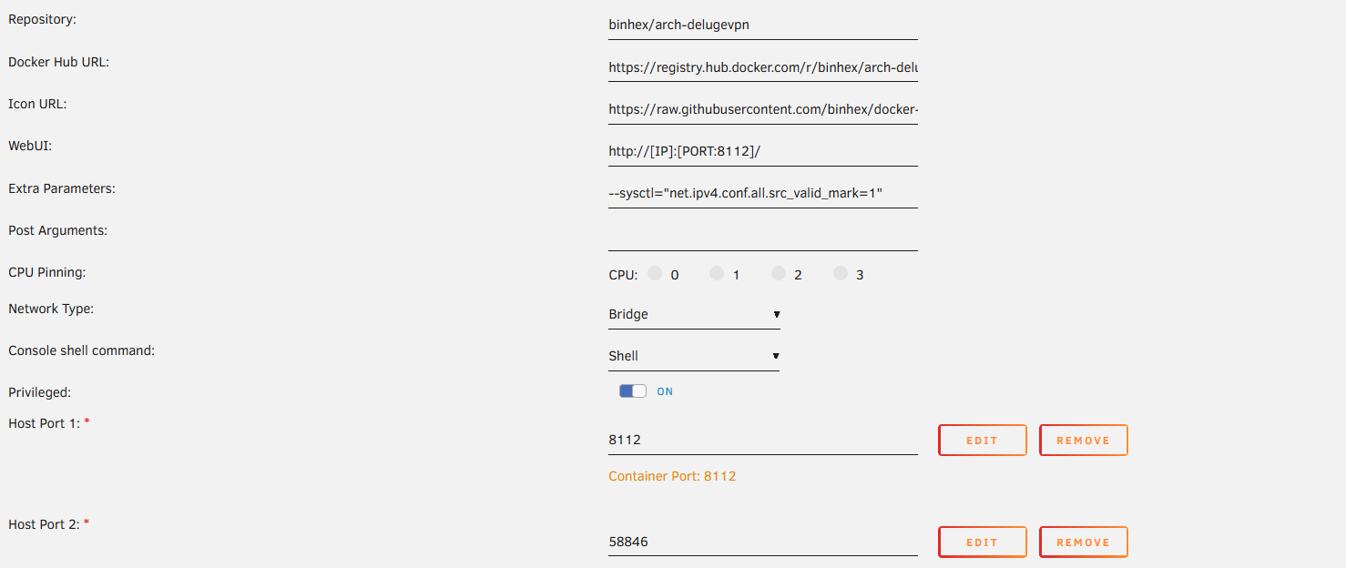

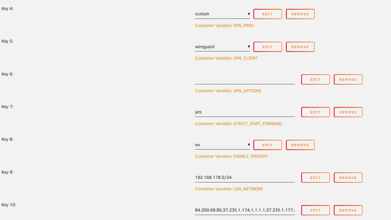

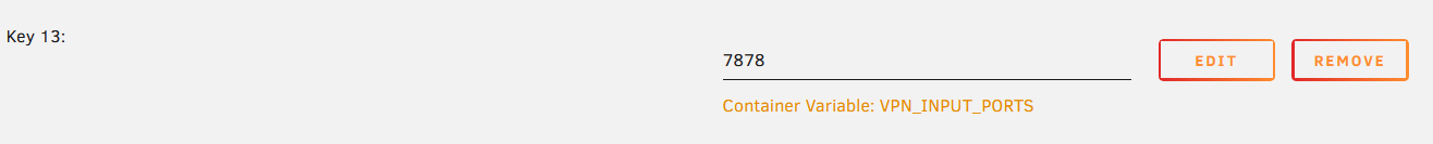

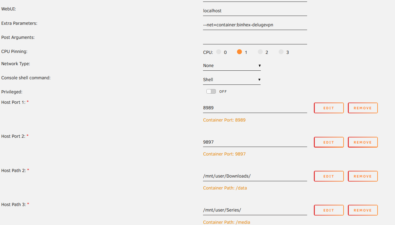

Hi thanks for your input, I have spend last 3 hours rereading this topic and try all options, but to no avail. To recap what I have tried and done,  and for example to run Sonarr (port 8989) through VPN (I have tried Radarr and SABNZB as well):
1. I have tried both binhex-DelugeVPN and binhex-PrivoxyVPN)
2. Once setup as per Spaceinvaders video I do get the VPN IP address when testing through console curl ifconfig.io (both Sonarr & Deluge/Privoxy)
3. Sonarr docker: I added to 'extra parameters': --net=container:binhex-delugevpn
4. Sonarr docker: network type: none

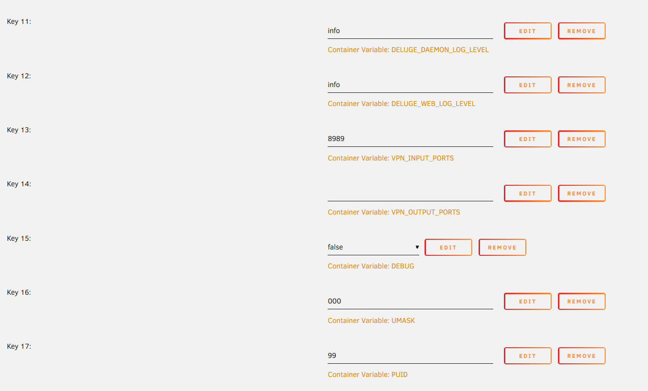

5. VPN docker: I added 8989 to key 13 'VPN input ports' in Deluge/Privoxy

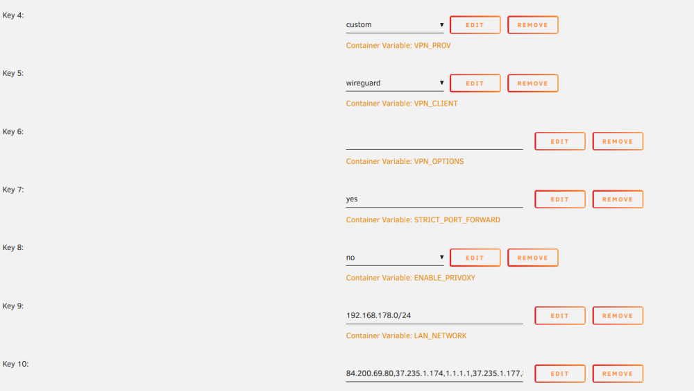

6. VPN docker: I checked key 9 'LAN_NETWORK' and set to 192.168.178.0/24. My router provides IP's (DHCP) to 192.168.178.x where server is .25 and router .1
7. I do run from remote desktop (WAN via VPN via wireguard), all files and dockers accessible without running through Deluge/Privoxy. To be complete I opened port 8989 on my router, but no difference.
8. FYI: I do have  a NAT loopback restriction: Modem doesn't support NAT loopback so Home Assistant runs DNSMasq to handle internal DNS requests
9. As stated before, I believe Sonarr works with VPN setup as I can see the load in dashboard, and confirming with curl ifconfig.io I get a VPN IP. I am just limited accessing the Webgui.
As I can't access webgui through IP address (192.168.178.25:8989, https://192.168.178.25:8989 and/or http://192.168.178.25:8989) there is no point trying to add localhost to settings in Sonarr
I am not sure how to run a Docker run command (what syntax do I use, I have tried a few things, nothing sensible comes out?), but if I get a hint I'll upload my log.
Any idea how I can further troubleshoot and come back with more information to paint a full picture?

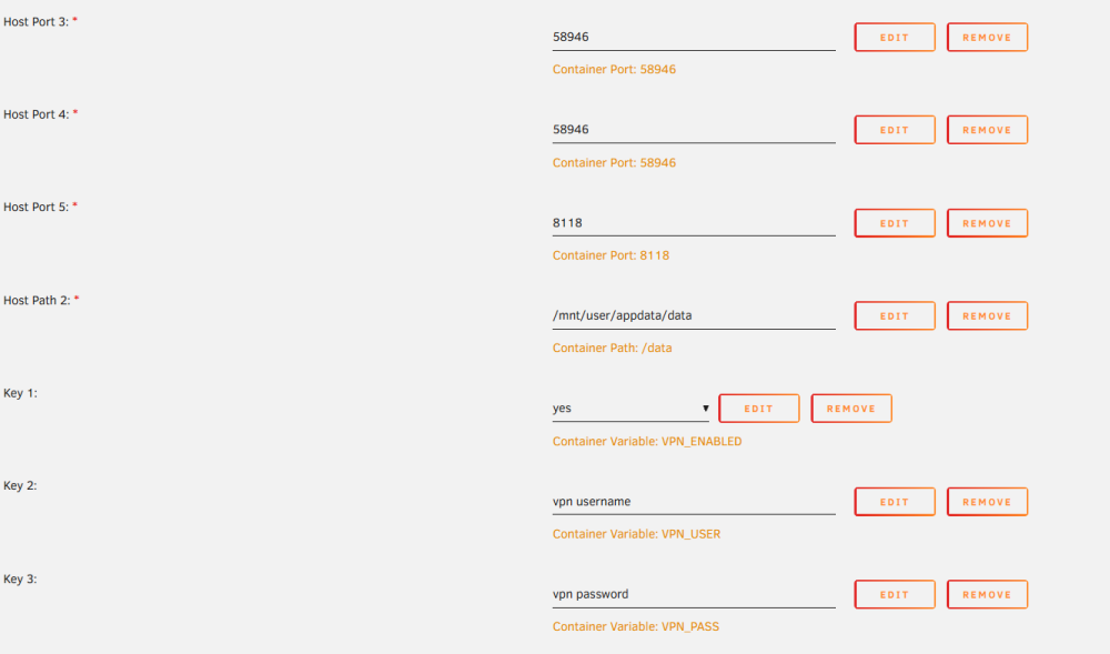

Please find printscreens of my settings, perhaps I am thick as mince and making a very stupid mistake I fail to recognize:
Sonarr prtsc 1 &2:
DelugeVPN:
image.thumb.png.a03c48e9714f59058ad1a794463cf3e6.pngimage.thumb.png.0011143e2a96bfcfc44d02402f921430.pngimage.thumb.png.e79b7d0519fd66ea1e4a735fcf9d5645.png

I do doubt, Space invader adds a port in VPN manually near end of video, but if I do that I get an orphaned docker image. Is this proceeded by the 'VPN_INPUT_PORTS"?
I've been having the same issues and I found an answer in the Binhex Documentation. Starting at Q24.
These are the steps I took using binhex-privoxyvpn as the container I wanted to route my applications through.
I'm using Radarr for this example. To start in privoxyvpn, I added port 7878 (Radarr's port) into VPN_INPUT_PORT. I then added a custom port with Radarr's port again, and a different port that will be used to access the WebUI. I just added one to my port and made it 7879.
I then set up Radarr as usual and added the --net=container:<container name> into the Extra parameters field.
After applying these settings, I was able to access my WebUI again through serveraddress:7879
