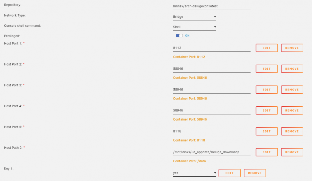

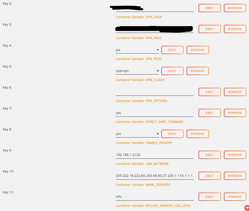

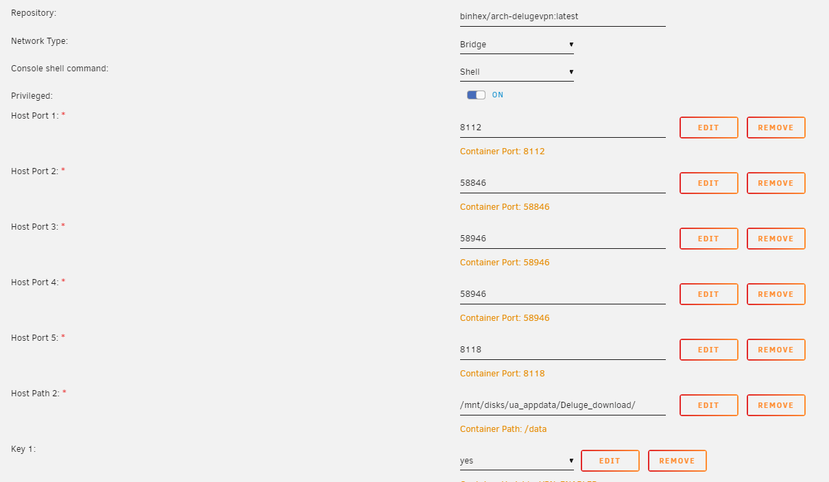

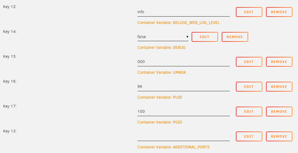

I updated my DelugeVPN docker container awhile back and Sonarr/Radarr will no longer connect when the VPN is turned on within the DelugeVPN container settings. I can connect to the DelugeVPN docker webui just fine with the VPN feature enabled, but Sonarr/Radarr cannot reach it unless the VPN feature is turned off. Please help. I don't want to be unprotected!
Does anyone know how to fix this?
I am also having issues with my deluge
I just check it and it looks like it hasn't been running for the pass few days.
I am using this version: binhex/arch-delugevpn:latest
my VPN still works
webGUI = This site can't be reached
can anyone see why this has started to happen or do I need to look at the first sticker post about IP Leakage
Update: .  I just look at the IP Table Q&A and I am loss
I route my Sonarr, Radarr, Jackett through delugeVPN so I am guesting that I need to look at Q27
and as I am using delugevpn I will need to add the following to the other contactors ?
VPN_OUTPUT_PORTS = 58946
I am also having issue with access the GUI to conform that my VPN is working so I am looking at Q25 and this is where I am confused,  can someone please help me on working this all out.
docker settings.

2021-04-05 12:12:02,141 INFO Set uid to user 0 succeeded
2021-04-05 12:12:02,167 INFO supervisord started with pid 6
2021-04-05 12:12:03,169 INFO spawned: 'shutdown-script' with pid 186
2021-04-05 12:12:03,170 INFO spawned: 'start-script' with pid 187
2021-04-05 12:12:03,171 INFO spawned: 'watchdog-script' with pid 188
2021-04-05 12:12:03,172 INFO reaped unknown pid 7 (exit status 0)
2021-04-05 12:12:03,208 DEBG 'start-script' stdout output:
[info] VPN is enabled, beginning configuration of VPN
2021-04-05 12:12:03,209 INFO success: shutdown-script entered RUNNING state, process has stayed up for > than 0 seconds (startsecs)
2021-04-05 12:12:03,209 INFO success: start-script entered RUNNING state, process has stayed up for > than 0 seconds (startsecs)
2021-04-05 12:12:03,209 INFO success: watchdog-script entered RUNNING state, process has stayed up for > than 0 seconds (startsecs)
2021-04-05 12:12:03,275 DEBG 'start-script' stdout output:
[info] Adding 209.222.18.222 to /etc/resolv.conf
2021-04-05 12:12:03,278 DEBG 'start-script' stdout output:
[info] Adding 84.200.69.80 to /etc/resolv.conf
2021-04-05 12:12:03,283 DEBG 'start-script' stdout output:
[info] Adding 37.235.1.174 to /etc/resolv.conf
2021-04-05 12:12:03,288 DEBG 'start-script' stdout output:
[info] Adding 1.1.1.1 to /etc/resolv.conf
2021-04-05 12:12:03,292 DEBG 'start-script' stdout output:
[info] Adding 209.222.18.218 to /etc/resolv.conf
2021-04-05 12:12:03,297 DEBG 'start-script' stdout output:
[info] Adding 37.235.1.177 to /etc/resolv.conf
2021-04-05 12:12:03,302 DEBG 'start-script' stdout output:
[info] Adding 84.200.70.40 to /etc/resolv.conf
2021-04-05 12:12:03,306 DEBG 'start-script' stdout output:
[info] Adding 1.0.0.1 to /etc/resolv.conf
2021-04-05 12:12:04,263 DEBG 'start-script' stdout output:
[info] Attempting to load iptable_mangle module...
2021-04-05 12:12:04,265 DEBG 'start-script' stderr output:
modprobe: FATAL: Module iptable_mangle not found in directory /lib/modules/5.10.21-Unraid
2021-04-05 12:12:04,265 DEBG 'start-script' stdout output:
[warn] Unable to load iptable_mangle module using modprobe, trying insmod...
2021-04-05 12:12:04,267 DEBG 'start-script' stderr output:
insmod: ERROR: could not load module /lib/modules/iptable_mangle.ko: No such file or directory
2021-04-05 12:12:04,267 DEBG 'start-script' stdout output:
[warn] Unable to load iptable_mangle module, you will not be able to connect to the applications Web UI or Privoxy outside of your LAN
[info] unRAID/Ubuntu users: Please attempt to load the module by executing the following on your host: '/sbin/modprobe iptable_mangle'
[info] Synology users: Please attempt to load the module by executing the following on your host: 'insmod /lib/modules/iptable_mangle.ko'
2021-04-05 12:12:04,802 DEBG 'start-script' stdout output:
[info] Default route for container is 172.17.0.1
2021-04-05 12:12:04,881 DEBG 'start-script' stdout output:
[info] Docker network defined as 172.17.0.0/16
2021-04-05 12:12:04,888 DEBG 'start-script' stdout output:
[info] Adding 192.168.1.0/24 as route via docker eth0
2021-04-05 12:12:04,890 DEBG 'start-script' stdout output:
[info] ip route defined as follows...
2021-04-05 12:12:04,892 DEBG 'start-script' stdout output:
default via 172.17.0.1 dev eth0
172.17.0.0/16 dev eth0 proto kernel scope link src 172.17.0.4
192.168.1.0/24 via 172.17.0.1 dev eth0
broadcast 127.0.0.0 dev lo table local proto kernel scope link src 127.0.0.1
local 127.0.0.0/8 dev lo table local proto kernel scope host src 127.0.0.1
local 127.0.0.1 dev lo table local proto kernel scope host src 127.0.0.1
broadcast 127.255.255.255 dev lo table local proto kernel scope link src 127.0.0.1
broadcast 172.17.0.0 dev eth0 table local proto kernel scope link src 172.17.0.4
local 172.17.0.4 dev eth0 table local proto kernel scope host src 172.17.0.4
broadcast 172.17.255.255 dev eth0 table local proto kernel scope link src 172.17.0.4
2021-04-05 12:12:05,408 DEBG 'start-script' stdout output:
[info] iptables defined as follows...
2021-04-05 12:12:05,410 DEBG 'start-script' stdout output:
-P INPUT DROP
-P FORWARD DROP
-P OUTPUT DROP
-A INPUT -s 172.17.0.0/16 -d 172.17.0.0/16 -j ACCEPT
-A INPUT -s 84.17.60.211/32 -i eth0 -j ACCEPT
-A INPUT -s 84.17.60.212/32 -i eth0 -j ACCEPT
-A INPUT -i eth0 -p tcp -m tcp --dport 8112 -j ACCEPT
-A INPUT -i eth0 -p udp -m udp --dport 8112 -j ACCEPT
-A INPUT -s 192.168.1.0/24 -d 172.17.0.0/16 -i eth0 -p tcp -m tcp --dport 58846 -j ACCEPT
-A INPUT -s 192.168.1.0/24 -d 172.17.0.0/16 -i eth0 -p tcp -m tcp --dport 8118 -j ACCEPT
-A INPUT -p icmp -m icmp --icmp-type 0 -j ACCEPT
-A INPUT -i lo -j ACCEPT
-A INPUT -i tun0 -j ACCEPT
-A OUTPUT -s 172.17.0.0/16 -d 172.17.0.0/16 -j ACCEPT
-A OUTPUT -d 84.17.60.211/32 -o eth0 -j ACCEPT
-A OUTPUT -d 84.17.60.212/32 -o eth0 -j ACCEPT
-A OUTPUT -o eth0 -p tcp -m tcp --sport 8112 -j ACCEPT
-A OUTPUT -o eth0 -p udp -m udp --sport 8112 -j ACCEPT
-A OUTPUT -s 172.17.0.0/16 -d 192.168.1.0/24 -o eth0 -p tcp -m tcp --sport 58846 -j ACCEPT
-A OUTPUT -s 172.17.0.0/16 -d 192.168.1.0/24 -o eth0 -p tcp -m tcp --sport 8118 -j ACCEPT
-A OUTPUT -p icmp -m icmp --icmp-type 8 -j ACCEPT
-A OUTPUT -o lo -j ACCEPT
-A OUTPUT -o tun0 -j ACCEPT
2021-04-05 12:12:05,412 DEBG 'start-script' stdout output:
2021-04-05 12:12:05,413 DEBG 'start-script' stdout output:
[info] Starting OpenVPN (non daemonised)...
2021-04-05 12:12:05,830 DEBG 'start-script' stdout output:
2021-04-05 12:12:05 DEPRECATED OPTION: --cipher set to 'aes-128-cbc' but missing in --data-ciphers (AES-256-GCM:AES-128-GCM). Future OpenVPN version will ignore --cipher for cipher negotiations. Add 'aes-128-cbc' to --data-ciphers or change --cipher 'aes-128-cbc' to --data-ciphers-fallback 'aes-128-cbc' to silence this warning.
2021-04-05 12:12:05 WARNING: file 'credentials.conf' is group or others accessible
2021-04-05 12:12:05 OpenVPN 2.5.1 [git:makepkg/f186691b32e68362+] x86_64-pc-linux-gnu [SSL (OpenSSL)] [LZO] [LZ4] [EPOLL] [PKCS11] [MH/PKTINFO] [AEAD] built on Feb 24 2021
2021-04-05 12:12:05 library versions: OpenSSL 1.1.1j 16 Feb 2021, LZO 2.10
2021-04-05 12:12:05 NOTE: the current --script-security setting may allow this configuration to call user-defined scripts
2021-04-05 12:12:05,831 DEBG 'start-script' stdout output:
2021-04-05 12:12:05 CRL: loaded 1 CRLs from file -----BEGIN X509 CRL-----
MIICWDCCAUAwDQYJKoZIhvcNAQENBQAwgegxCzAJBgNVBAYTAlVTMQswCQYDVQQI
EwJDQTETMBEGA1UEBxMKTG9zQW5nZWxlczEgMB4GA1UEChMXUHJpdmF0ZSBJbnRl
cm5ldCBBY2Nlc3MxIDAeBgNVBAsTF1ByaXZhdGUgSW50ZXJuZXQgQWNjZXNzMSAw
HgYDVQQDExdQcml2YXRlIEludGVybmV0IEFjY2VzczEgMB4GA1UEKRMXUHJpdmF0
ZSBJbnRlcm5ldCBBY2Nlc3MxLzAtBgkqhkiG9w0BCQEWIHNlY3VyZUBwcml2YXRl
aW50ZXJuZXRhY2Nlc3MuY29tFw0xNjA3MDgxOTAwNDZaFw0zNjA3MDMxOTAwNDZa
MCYwEQIBARcMMTYwNzA4MTkwMDQ2MBECAQYXDDE2MDcwODE5MDA0NjANBgkqhkiG
9w0BAQ0FAAOCAQEAQZo9X97ci8EcPYu/uK2HB152OZbeZCINmYyluLDOdcSvg6B5
jI+ffKN3laDvczsG6CxmY3jNyc79XVpEYUnq4rT3FfveW1+Ralf+Vf38HdpwB8EW
B4hZlQ205+21CALLvZvR8HcPxC9KEnev1mU46wkTiov0EKc+EdRxkj5yMgv0V2Re
ze7AP+NQ9ykvDScH4eYCsmufNpIjBLhpLE2cuZZXBLcPhuRzVoU3l7A9lvzG9mjA
5YijHJGHNjlWFqyrn1CfYS6koa4TGEPngBoAziWRbDGdhEgJABHrpoaFYaL61zqy
MR6jC0K2ps9qyZAN74LEBedEfK7tBOzWMwr58A==
-----END X509 CRL-----
2021-04-05 12:12:05 TCP/UDP: Preserving recently used remote address: [AF_INET]84.17.60.212:1198
2021-04-05 12:12:05 UDP link local: (not bound)
2021-04-05 12:12:05 UDP link remote: [AF_INET]84.17.60.212:1198
Edited by chris_netsmart
updated log file
It says in your logs why you are unable to access it through the web browser. You should reference Q2 in the below documentation to make it persist through reboot. Just be sure you have your "LAN_NETWORK" variable correctly identified in the container. Also, you should change your PIA password, it's in the logs.
https://github.com/binhex/documentation/blob/master/docker/faq/vpn.md
On 4/1/2021 at 2:53 AM, PeterB said:
HELP!
I was trying to get binhex-couchpotato to connect through binhex-delugevpn once again.  I made edits as described in Q24, but couldn't find the 'VPN_INPUT_PORTS' env var.  I believed that I had to delete the delugevpn container and re-install it, and tha this would pick up my old settings again.
However, now when I go to the unRAID 'Docker' page I simply see a never-ending hourglass and there is no delugevpn showing.
Oh, and binhex-couchpotato always says 'rebuilding' under the version column.
What do I need to do to get delugevpn back (with all my settings)?
Edit:
I managed to get into couchpotato settings and blank the 'Extra Parameters'.  This seems to have fixed the hourglass problem.
I now seem to be in a position to re-install delugevpn with my original settings ....  I will carry on and see where I get to .......
Further Edit:
Ah, but I still don't have VPN_INPUT_PORTS ....  still stuck ....
... and no, I don't have a container version specified in the repository.
You can download the app again from the APPS tab and just point the config path to your last Deluge appdata folder. It will overwrite your old template as long as it is named the same. You should have the VPN_INPUT_PORTS and VPN_OUTPUT_PORTS variables in the template again. You can also just add the variables to your template, as long as the you have the VPN_INPUT_PORTS and VPN_OUTPUT_PORTS as the "Key" and your ports as the "Value".
thanks @Roudy
ok before I do this as the last thing I want to f*&^ my server
reading Q2 it reference - access the deluge from outside my LAN, which is I don't want to do - only from my lan, but I am guesting that this covers both LAN and external connecting ?
also it takes about SSH onto the unraid server, and running the comments,   I am guesting this a basic SSH into a terminal and running ?
and I can also confirm that my LAN_NETWORK is right
  You shouldn't need it if you are on the same LAN... Is your computer in the 192.168.1.0/24 network? Is it connected to a VPN or Proxy by chance? You can run the command either way to see if it fixes the issue for you.
  Yes, you will have to SSH into unraid itself to run the command. You can use the little terminal icon in the upper right have corner of the webpage for easy access.
@Roudy many thanks I have my deluge back,    now onto the next issue, is that Sonarr and Radarr are not able to see deluge,  looking at Q24, Q25.
fun times 😞 over
