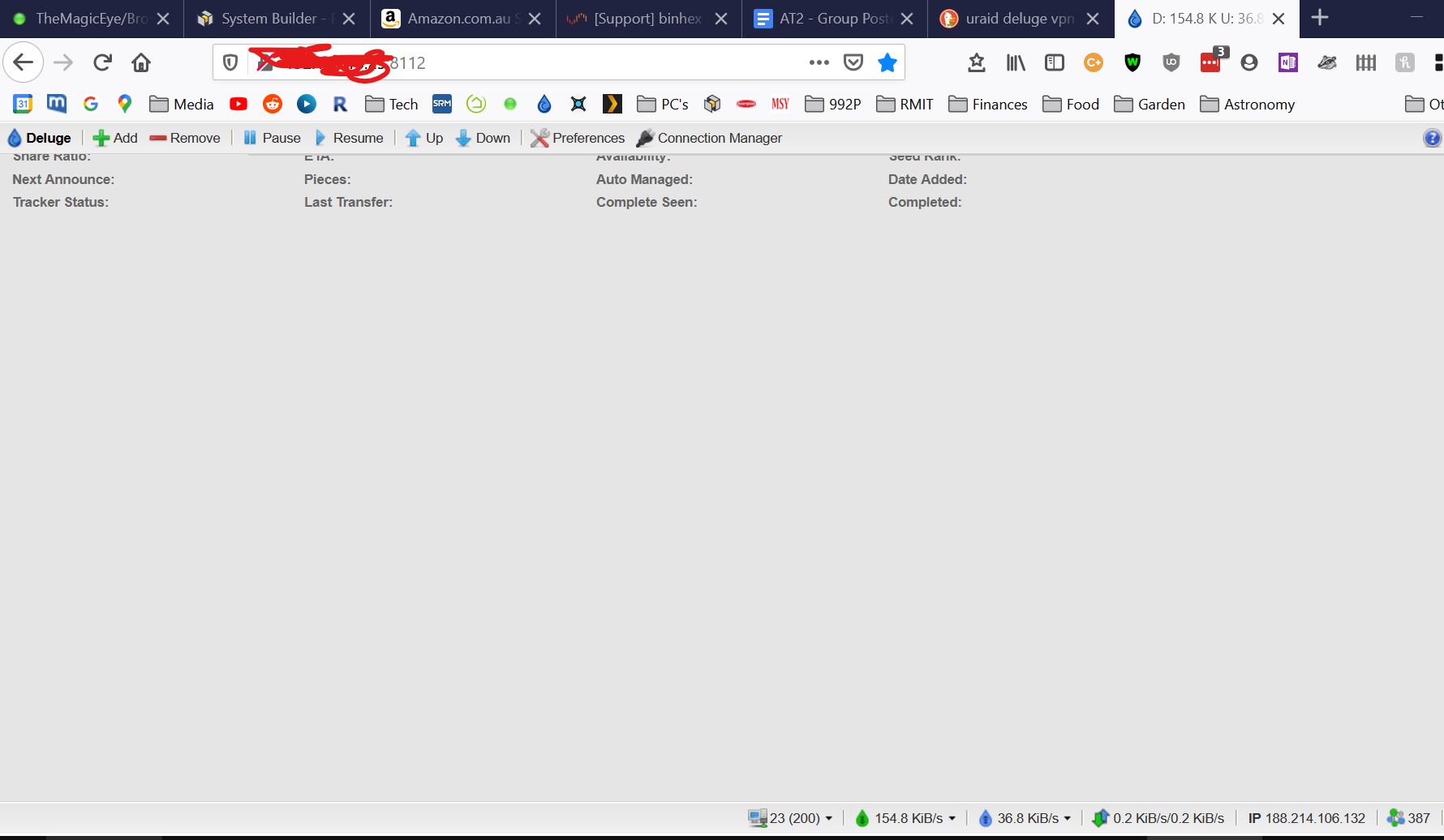

Hi there, in the last few weeks the WebUI for DelugeVPN has been displaying itself incorrectly on an intermittent basis. See the screen shot below, where it appears that the bottom of the GUI is now right up at the top with nothing below it. There is also no scrolling available so I can't just navigate upwards to solve the problem.
I have been using Firefox for years, and have had no issues in the last 3 months since setting up UnRaid - until now. I do have UBlock Origin, DuckDuckGo privacy essentials and Privacy badger added as extensions, but these all have my Unraid Server IP whitelisted. I also use the LastPass extension (for now anyway, lol). Not sure what else it could be, as when I open up Chrome on the same PC there are no issues whatsoever. Super not keen to use Chrome though.
Anyone have any thoughts?
