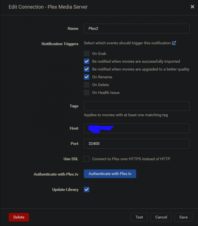

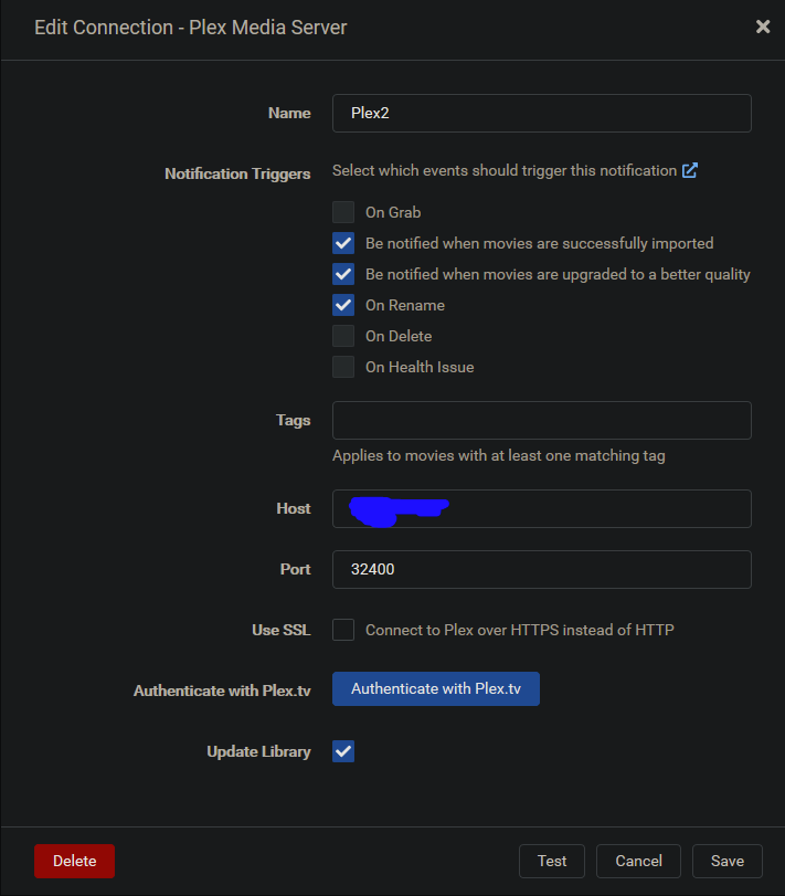

59 minutes ago, Ericjr said:
no resolution on how to get Radarr/Sonarr to talk to plex
I am a bit confused.  Radarr and sonarr don't talk to plex.
It can if you go to Settings>Connect settings>Plex Media Server.
1 hour ago, Trenta27 said:
Learn something new every day.

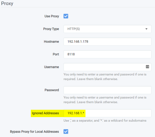

17 hours ago, Ericjr said:
I have deluge up and running with the new version. Sab/Radarr/Sonarr can all communicate and I changed everything to local host and added the additional ports. All good. I run curl they all come out of the VPN. Containers are connected to Deluge with --net=container:Delugevpn. I saw some other posts but no resolution on how to get Radarr/Sonarr to talk to plex  for media updates that are not running through a VPN. I would prefer not to have plex run through the VPN. Any advice out there?
My solution to this is to keep running the privoxy until a solution is developed. You can do this with the new version of Deluge, you just need to add your network IP range to the 'Ignored Addresses' parameter in Radarr/Sonarr.
Outstanding. I had read previous posts about using the ignored address but I hadn’t needed it until now. Worked great.👍

55 minutes ago, MothyTim said:
Hi, so a few hours of reading and trying things out leads me to think that privoxy is broken!
This is not accurate.  I have everything still running under the privoxy setup.  The change that is needed though is you need to add your network IP range into the 'Ignored Addresses' parameter in Radarr/Sonarr.  There is not an option in Jackett for this that I found.
