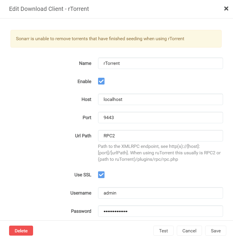

can you screenshot the config in sonarr for the 'download client'
edit - just checked this by routing sonarr through rtorrentvpn (should be the same as delugevpn) and after setting the sonarr download client settings correctly it tests fine, see screenshot below for my config, note the host should be localhost (on the same network) and port should be the container side port for the web ui or api:-

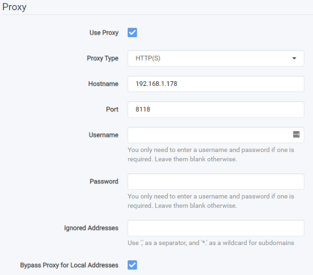

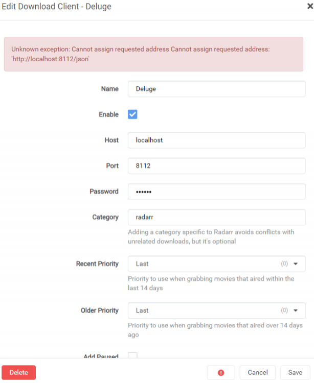

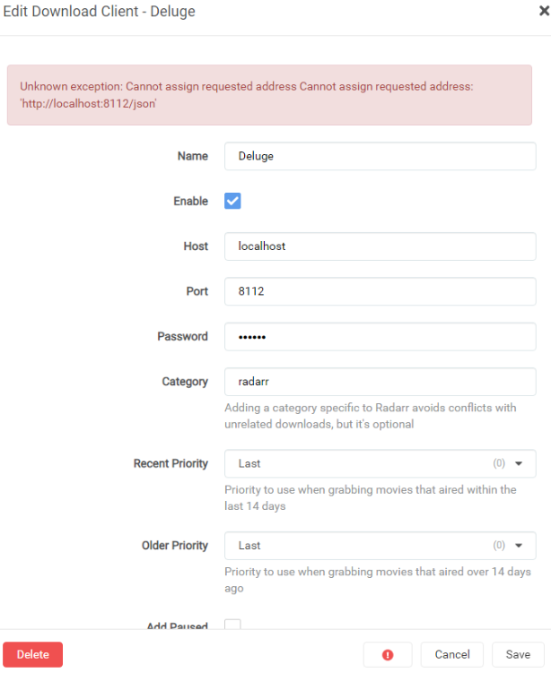

Is this only for the new updated Deluge setup?
I was trying to use 'localhost' before I updated Deluge and I get an error, but when I specify the IP 192.168.0.178 it tests good.  I understand what you are saying about it being inefficient, and would like to make it more so.  The screens show my setup in Radarr.  It doesn't show in the bottom option in the download client setup, but I don't have 'Use SSL' checked.
