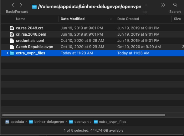

Overnight I got issues with accessing the WebUI. Last night I had no problems, but today it refuses to work. I tried restarting the docker, rebooting Unraid, rebooting my router, updating the VPN server list and disabling the VPN option. Nothing works. I also tried to access the Webui from different PCs.
The log stops at: "Waiting for Deluge process to start listening on port 58846..."
I think the only thing I did yesterday was add the 'labels' plugin. I don't think It has anything to do with this or how to disable it outside of the WebUI.
Does anyone have an idea how to fix this? I couldn't find any working solutions in this thread. Maybe I've overlooked somthing. 😔

Changind Remote server
I search to this topic but i don't find. It's possible to change Remote server for changing my external Ip adress?
I trying to add this variable to my Docker but is not working.
VPN_REMOTE_SERVER: nl.privateinternetaccess.com
Thanks for your help
You need to edit your .ovpn file.
https://github.com/binhex/documentation/blob/master/docker/faq/vpn.md
Scroll down to Q20.
If you only want to use one endpoint you could also just replace your ovpn file with the correct one for that endpoint.

In my docker folder DelugeVPN/openvpn i have many *ovpn file. In my case the armenia.ovpn have recent modified date and time.  I have only credential.conf with this *.ovpn.
Thanks for your help.
You should only place one ovpn file in this folder, the file that corresponds to the server you wish to use. If you want, you can place the other files in a subfolder (see screenshot) for possible future need.
