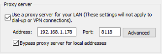

I also setup my Windows 10 VM to use the DelugeVPN connection by setting it up according to Spaceinvader's video.  Is there a way to route the VM through the DelugeVPN with this new update?  I was not sure if I needed to add a port to the 'ADDITIONAL_PORTS' var and if so what port.
Image from Internet Options > Connections tab > LAN settings inside my Win 10 VM.

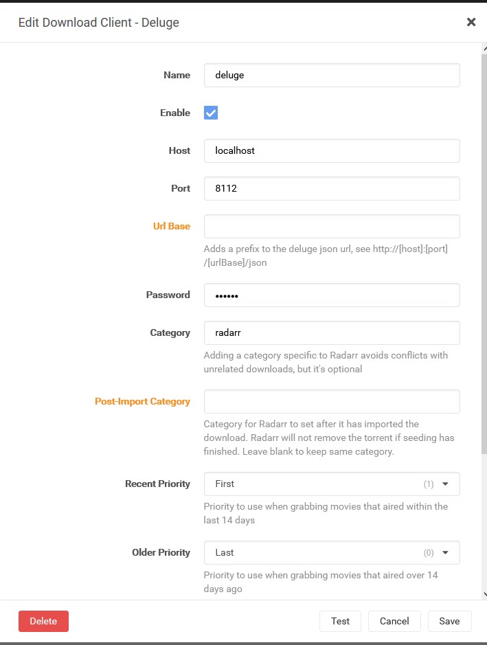

I'm also unable to use "localhost" in Sonarr/Radarr/etc. Setting them to the app IP of 172.17.x.x works. I'm also still having DNS leaks with a Firefox proxy pointing at DelugeVPN as detailed here. Everything, including DelugeVPN, is set to Network type = Bridge in the container settings. Sonarr, Radarr, NZBHydra2, Jackett, etc., are all using HTTP proxy with 172.17.x.x:8118 and "bypass local network" turned on. This may be the wrong way to use DelugeVPN with other containers, I'm not sure.

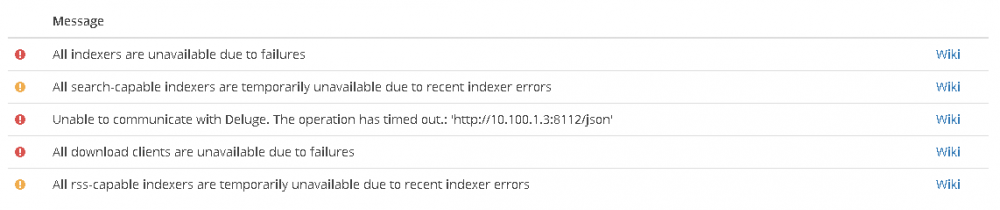

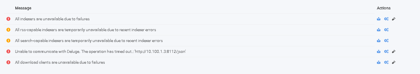

I just updated this container, and now I cannot connect Unraid local IP or to any of my dockers running on Unraid using the IP/port combo when I have DelugeVPN set as my proxy address/port. This worked right before the update.
Is there something I need to update/change?
EDIT: I'm also getting errors in Sonarr and Radarr that it can't connect to Jackett:
What's interesting is I can use public IPs and resolve public domains just fine using the proxy. It's just local addresses.

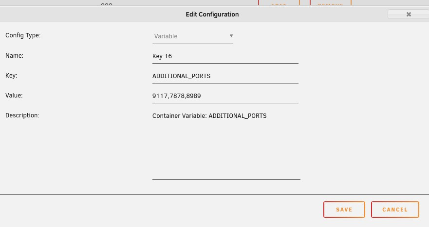

EDIT 2: I'm pretty sure I've added all the corrected settings, but it's still not working. Any ideas? If I can't fix it, can anyone tell me how to roll it back to the previous version? If I set my PC to use the deluge proxy, I can't even connect to the Unraid web UI anymore.
ADDTIONAL_PORTS:

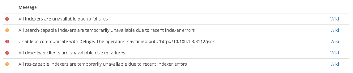

Hi, sorry another person getting stuck with this new update here. Not really that great with unraid so guessing something maybe setup wrong in the first place which is why its not not working. (but has been fine for 2 years ish)
Didn't have additional_ports so added this:
Assume that's correct?

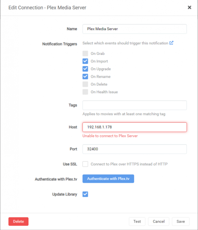

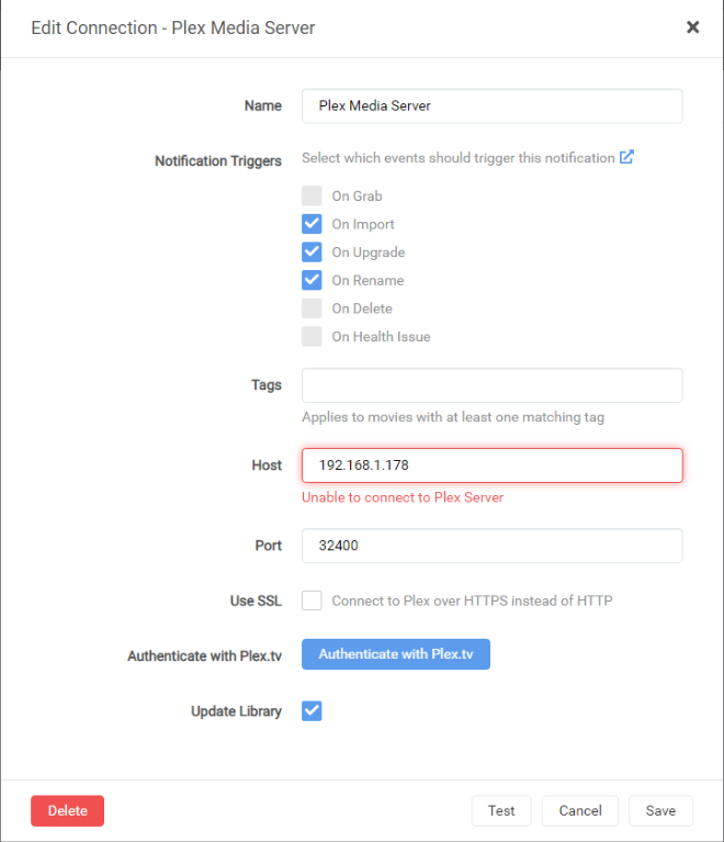

I got it to work thanks to Spaceinvader's Video and the VPN FAQ Instructions Q24 at the bottom.  Essentially I followed the video, added the 'ADDITIONAL_PORTS' variable, and then just updated the settings inside Radarr for example to be 'localhost' for Download Clients (Deluge) and Indexers (Jackett).
One thing I am noticing is that the containers I change will not connect to Plex Media Server any more.  This makes sense since all the dockers using the VPN have an IP address outside my network now, when I use 'curl ifconfig.io' in their consoles.  For those that have this setup working, do you have an issue with containers not connecting to others not using the VPN?
This is my setup for Plex in Radarr, under the Connect settings.  I could route my Plex container through the VPN but then I am guessing anything I direct play will go out through the VPN and back to my TV.

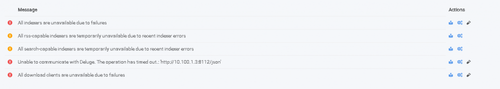

I posted screenshots of my setup a few posts up. Please let me know if you need more screenshots
1. Yes, I am routing Radarr, Sonarr and Jackett through DelugeVPN using the web GUI settings for each docker to point to the deluge container IP/port (10.100.1.3:8118). I tried using "localhost" too, but it wouldn't connect.
2. Yes, my unraid server IP is 10.100.1.3, and my LAN_NETWORK is defined as 10.100.1.0/24.
3. Yes, I have a couple containers set with static IPs (pihole and guacamole) that I can no longer access when I point a physical device to the deluge proxy. Containers using my "proxynet" vlan work fine. When I try to connect to the Unraid web gui using a physical device pointed to the proxy IP/port, it gives me a privoxy error.
I will try to go through it again and get more screenshots of all of the errors, but tempted to just wait.

I tried those steps, but they didn't work for me. See screenshots in a few posts above.
Also, when I point any physical device to the DelugeVPN proxy, I cannot connect to the Unraid web UI on that device.

The part that is really killing me, is the physical device pointed through the proxy IP/port part. If I do that, I cannot access the Unraid web GUI, nor any of my dockers running in bridge or custom IP on that device. I can only access dockers running on my "proxynet" VLAN using the fully qualified public domain name, which is going out and back in using DNS resolution and Swag (i'm guessing).
EDIT: Just to clarify, I point my physical laptop, desktop and mobile phone through DelugeVPN proxy, but the above issue is what happens when I do it with the latest update. Here's my proxy settings on my desktop PC:
Edited by carnivorebrah
21 minutes ago, MammothJerk said:
1. I'm only using the delugevpn privoxy for sonarr.
2. 192.168.1.0/24 and my server address is 192.168.1.105
3. sonarr and delugevpn are both running bridged.
delugevpn settings:
Sonarr settings
With the latest delugevpn container sonarr can only connect to deluge download client if the host is set to 172.17.0.9. localhost or 192.168.1.105 does NOT work.
Same story with the proxy under general > proxy.
downgrading to the previous container i have no issues.
How do you downgrade? I am having the same issue as you.
