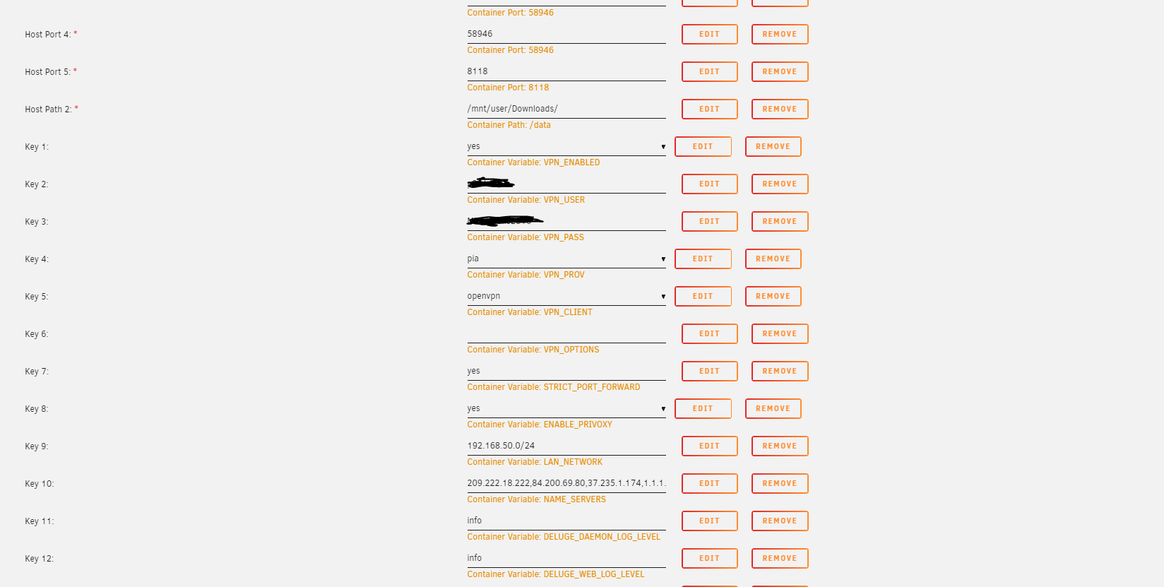

Hello,
I'm trying to get delugevpn to work on my unraid server.
I'm not sure what I'm doing wrong, but deluge is not browseable at x.x.x.x:8112 and the container wont stay running.
I have also checked my openvpn settings but they appear accurate (using PIA and replaced the ovpn file with the one I want to use for my vpn connection).
You should attach your supervisord log to your next post. Redact users and passwords.

I'm trying to get Delugevpn set up on my second unraid server that is just a media server. With this new version of the container, it is requiring openvpn. I put in the client.ovpn file in the openvpn folder of the appdata folder for delugevpn, but when I try to run the webui, I get a this site can't be reached error. Not sure what I am doing wrong. Here is the log file from the container:
2021-01-24 14:00:01 SIGHUP[soft,ping-restart] received, process restarting

I am wondering is I am missing something to make this work. Here is the set up file:
Thanks in advance.

Hello!
I've spent the better part of this weekend trying to get all this set up and I feel like I'm | | this close to it, lol.
I have DelugeVPN installed on my FreeNAS machine using RancherOS as my VM. I'm using PIA for my VPN with port forwarding turned on.
I have the container installed and the webui launches fine but when I go to add a torrent to test things out (I just grabbed the Night of the Living Dead one from the internet archive), I can click the add button over and over but nothing happens. I also tried the URL option and it says "Failed to download torrent."
I'm sure it's something stupid like a checkbox left unchecked but any help would be appreciated.
Edit: I fixed the issue. I found this link where someone had the same issue. Torrents added weren't working but magnet links would start but then do nothing.
I went through this user's steps and realized I didn't have the user permissions for my data folder set up correctly.
It's always the user permissions.
Everything is working fine now.
