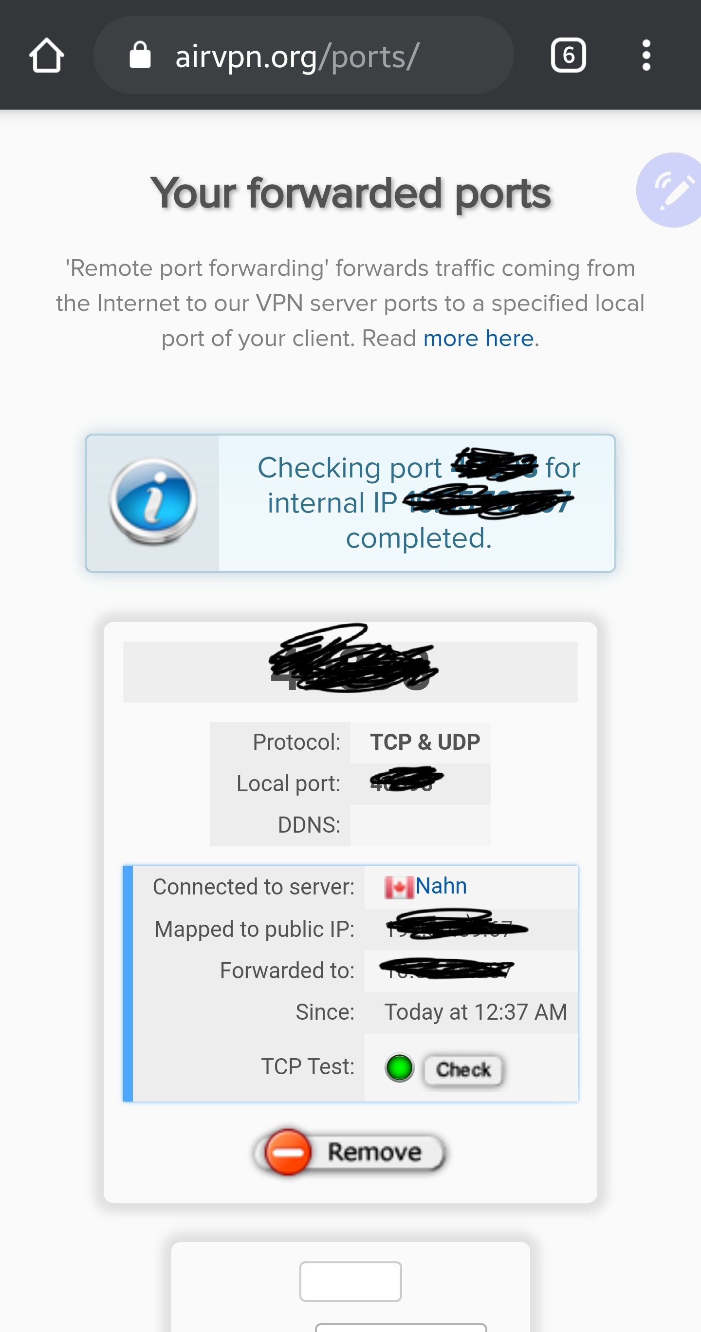

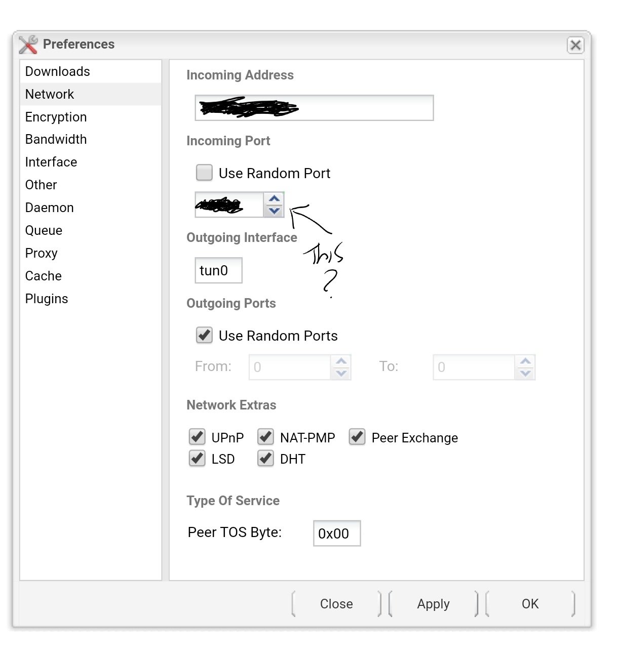

Ok like said I am running this Docker but I don't understand the port Forwarding?   I am with Airvpn, welll ar least until March.
what dont you understand about it?, its simply a port that is supplied by your vpn provider that you configure the app to use as the 'incoming port'
When you generate the openvpn config at Airvpn it selects 443 but is that different than the forwarded port?  On Airvpn I already had the forwarded port setup from before.
I put the port in Deluge.

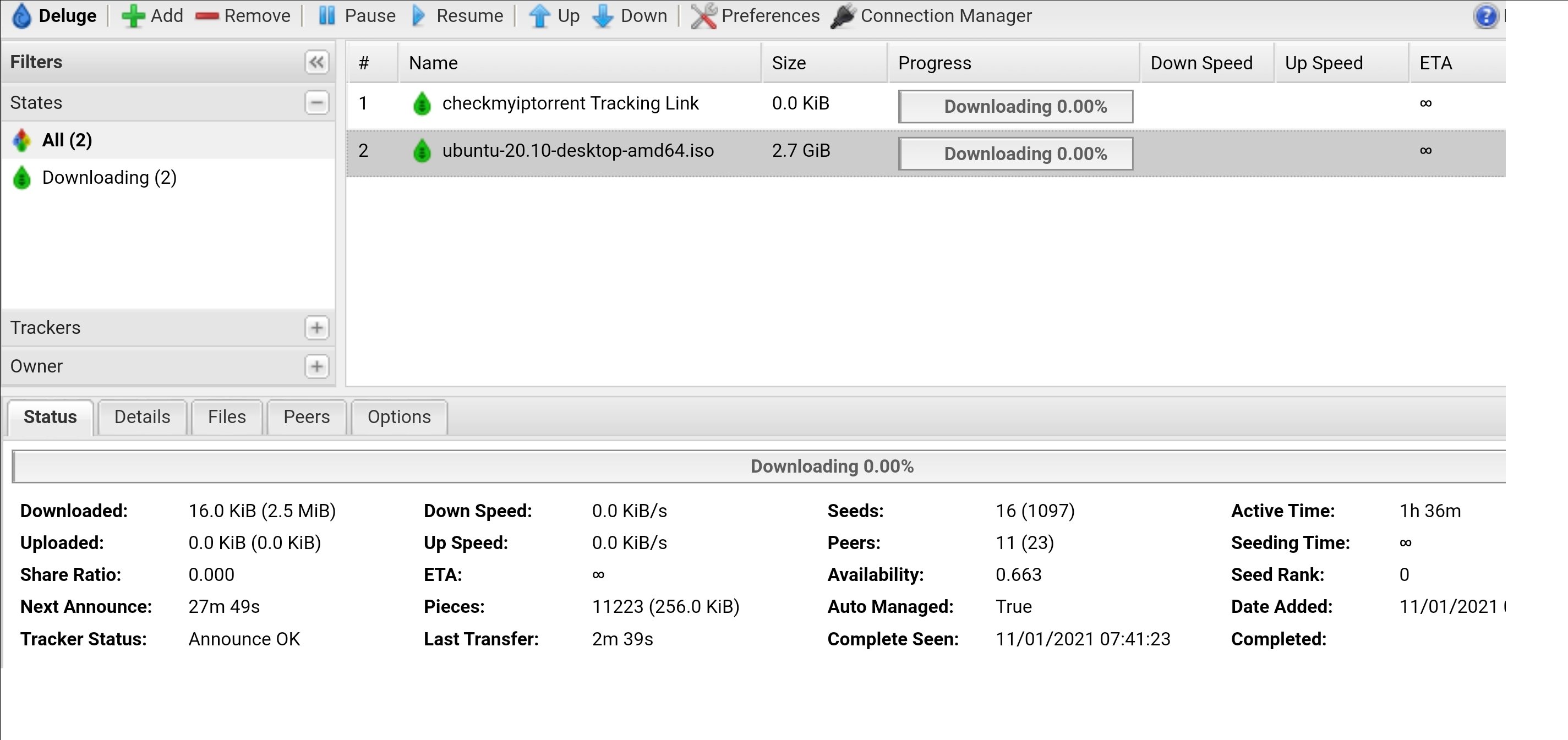

Not downloading on a test Ubuntu torrent.
This is from Airvpn forwarded ports page.
yes, port 443 will be the port used to connect to airvpn NOT the port forward.
I see these 2 addresses in the logs.
I deleted the port forward at Airvpn and requested a new one, updated Deluge incoming port then the download started then speed went lower until it stopped.

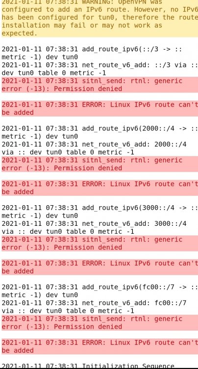

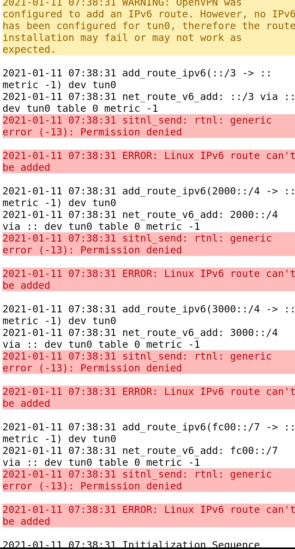

Here is part of the logs:
i woldnt be too concerned with this, if you can see the web ui for deluge then the vpn is up and running, and yes ipv6 is blocked via iptables in any case to prevent ipv6 leakage.
