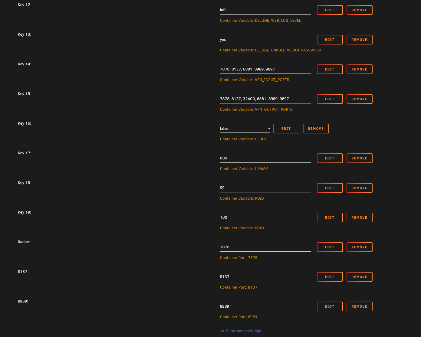

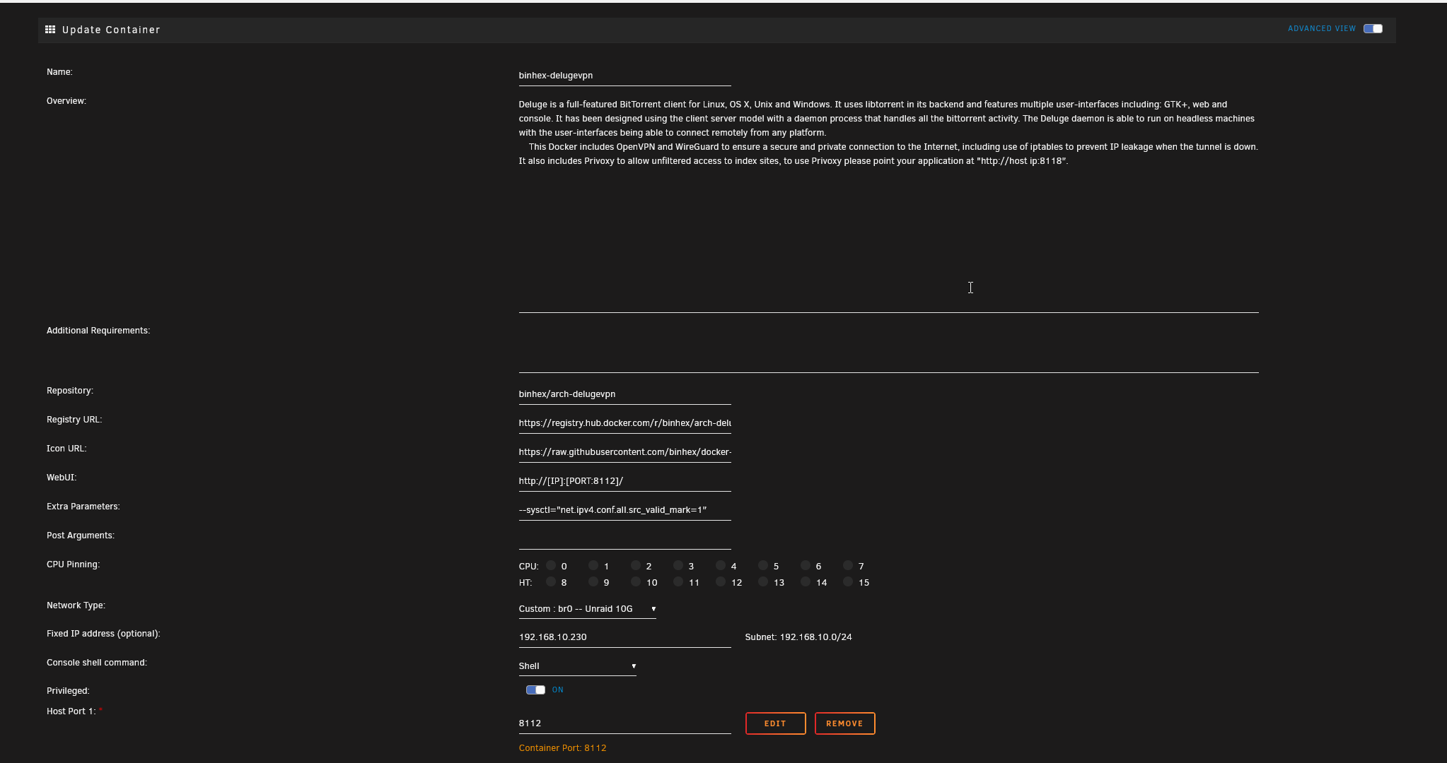

For some reason that I cannot fathom I'm unable to get Sonarr to route through Deluge VPN however, I've managed to get Radarr working through it fine. Below are steps that i've done.
1. Gone to the Sonarr docker image, and under extra params added `--net=container:binhex-delugevpn`
2. Under the same Sonarr docker image, I've set the network type to `none`
3. Gone to the deluge vpn docker image, edited it and added port `8989` under `VPN_INPUT_PORTS` & `VPN_OUTPUT_PORTS`
4. Added another port for `TCP` under the same deluge vpn docker for port `8989`
When i visit the deluge vpn image ip address followed by `:8989`, it simply refuses to load. But when i do `:7878` (used by Radarr) for which i've followed the same process for as the above four steps it works. Its simply Sonarr that doesn't want to talk to the vpn image. FWIW I'm of-course using all binhex images for sonarr, radarr and deluge-vpn.
Any help would be appreciated. Thank you!
If you set the network to bridge without changing anything else, does it work as expected, other than not running through the vpn?
Hi :)
Yes when i removed `--net=container:binhex-delugevpn`, and set the network to bridge, it works fine and goes through the first time setup.
Show a screenshot of that in advanced view.
Advanced view for the VPN image.chrome_3ofkJf4KAD.thumb.png.dc23017f584664e5a4abe4db97e5038f.png

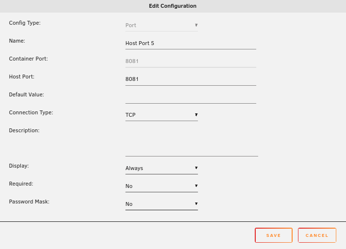

click edit on the 8989 entry and post just that part.

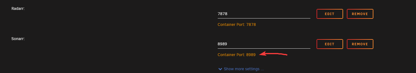

2 minutes ago, Inch said:
Try deleting that and entering it again. It's missing the container port entry for some reason.
Tried that, still doesn't show it. The same applies to the 7878 port that i added to the container for Radarr and thats working fine. It is showing container port under it though.
Probably because you are using a custom network for delugevpn instead of the default bridge. Binhex doesn't support anything but plain bridge. Doesn't mean you can't make it work, but it can be challenging.
Maybe the radarr port was added while you were in plain bridge mode?
I've tried plain bridge mode and custom network with the same results. I've just switched back to bridge, readded the sonarr port (specified 8989 in both) and it still doesn't work yet Radarr does still.
Strange. I'm out of things to try at this point. Maybe someone else will have some ideas.
Np, thanks for trying!
