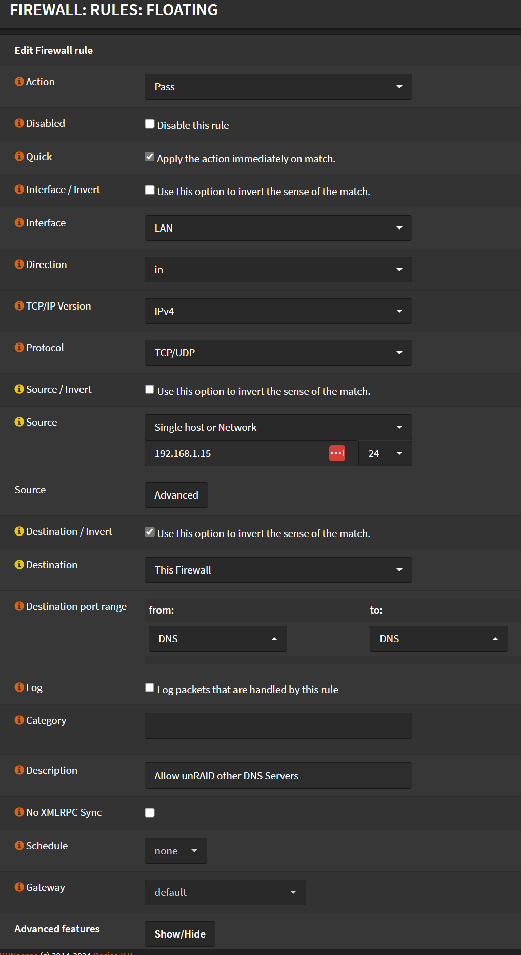

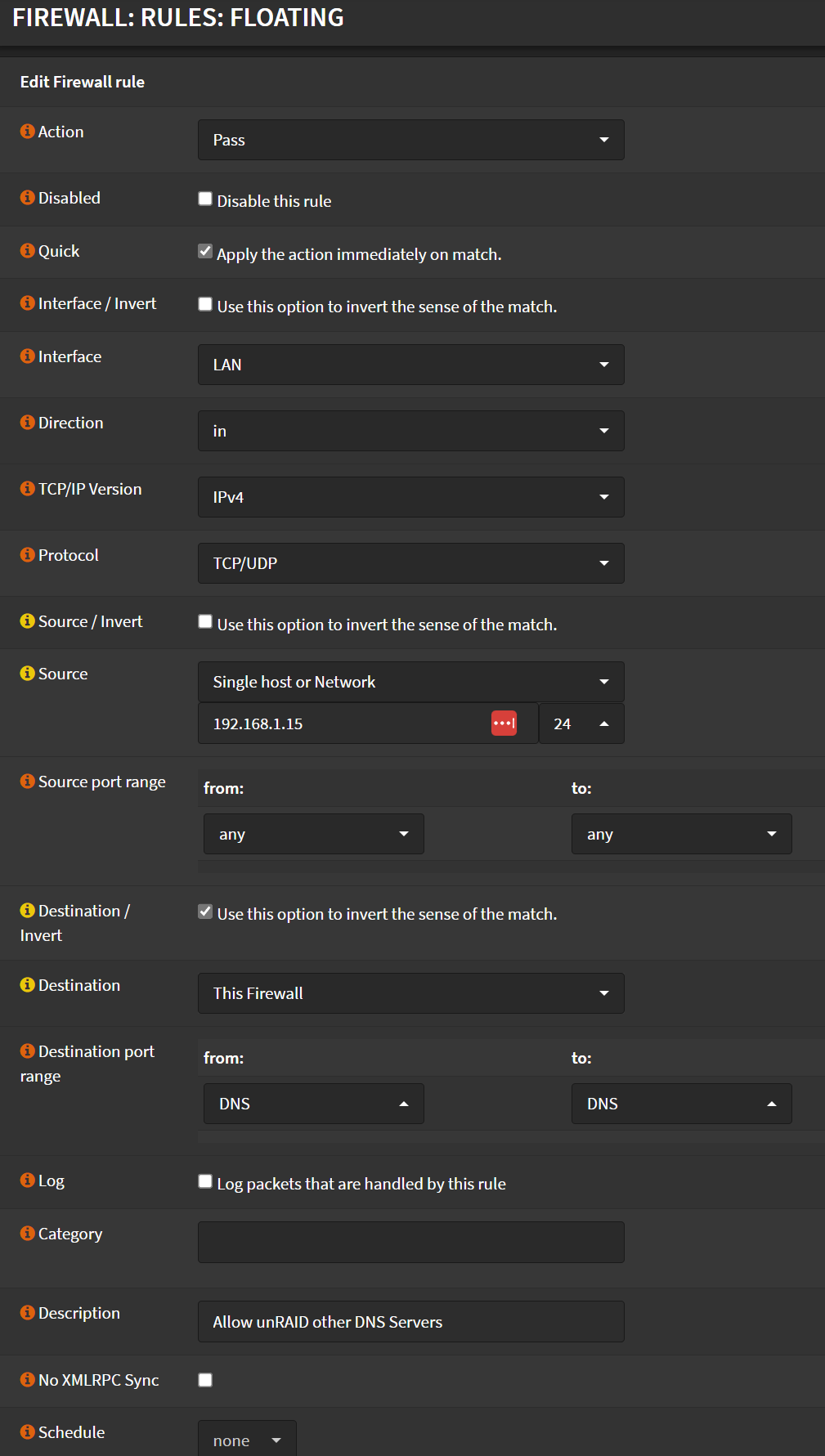

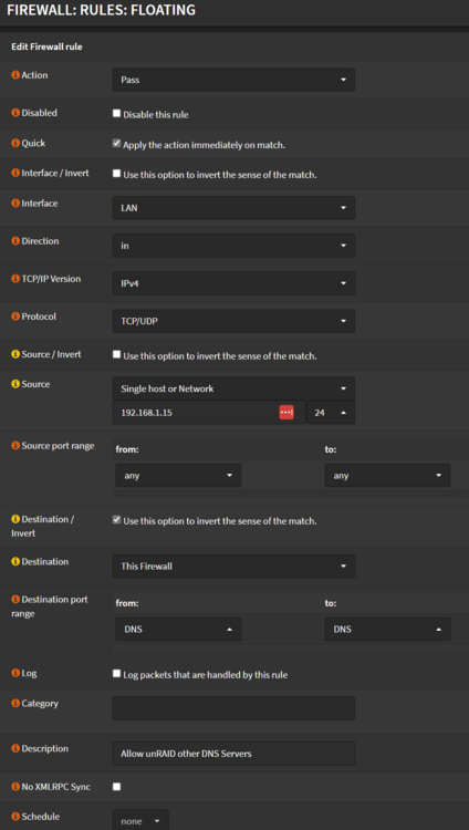

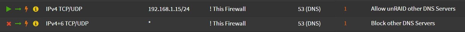

Tried changing my DNS:
2024-07-03 08:45:27,752 DEBG 'start-script' stdout output:
2024-07-03 08:45:27 NOTE: the current --script-security setting may allow this configuration to call user-defined scripts
2024-07-03 08:45:27 TCP/UDP: Preserving recently used remote address: [AF_INET]149.88.97.241:1198
2024-07-03 08:45:27 UDPv4 link local: (not bound)
2024-07-03 08:45:27 UDPv4 link remote: [AF_INET]149.88.97.241:1198
2024-07-03 08:45:30,315 DEBG 'start-script' stdout output:
2024-07-03 08:45:30 [toronto402] Peer Connection Initiated with [AF_INET]149.88.97.241:1198
2024-07-03 08:45:30,345 DEBG 'start-script' stdout output:
2024-07-03 08:45:30 TUN/TAP device tun0 opened
2024-07-03 08:45:30 net_iface_mtu_set: mtu 1500 for tun0
2024-07-03 08:45:30 net_iface_up: set tun0 up
2024-07-03 08:45:30 net_addr_v4_add: 10.21.112.9/24 dev tun0
2024-07-03 08:45:30 /root/openvpnup.sh tun0 1500 0 10.21.112.9 255.255.255.0 init
2024-07-03 08:45:30,355 DEBG 'start-script' stdout output:
2024-07-03 08:45:30 Initialization Sequence Completed
2024-07-03 08:46:27,525 DEBG 'start-script' stdout output:
[info] DNS failure, creating file '/tmp/dnsfailure' to indicate failure...
2024-07-03 08:46:27,528 DEBG 'start-script' stdout output:
[info] Attempting to get external IP using 'http://checkip.amazonaws.com'...
2024-07-03 08:46:27,563 DEBG 'start-script' stdout output:
[info] Failed on last attempt, attempting to get external IP using 'http://whatismyip.akamai.com'...
2024-07-03 08:46:27,573 DEBG 'start-script' stdout output:
[info] Failed on last attempt, attempting to get external IP using 'https://ifconfig.co/ip'...
2024-07-03 08:46:27,583 DEBG 'start-script' stdout output:
[info] Failed on last attempt, attempting to get external IP using 'https://showextip.azurewebsites.net'...
2024-07-03 08:46:27,593 DEBG 'start-script' stdout output:
[warn] Cannot determine external IP address, performing tests before setting to '127.0.0.1'...
[info] Show name servers defined for container
2024-07-03 08:46:27,594 DEBG 'start-script' stdout output:
nameserver 192.168.1.1
[info] Show contents of hosts file
127.0.0.1	localhost
::1	localhost ip6-localhost ip6-loopback
fe00::0	ip6-localnet
ff00::0	ip6-mcastprefix
ff02::1	ip6-allnodes
ff02::2	ip6-allrouters
172.17.0.3	8258d56b9091
191.96.36.104	ca-toronto.privacy.network
104.18.36.183	www.privateinternetaccess.com
104.19.240.167	serverlist.piaservers.net
2024-07-03 08:46:27,596 DEBG 'start-script' stdout output:
[info] Script started to assign incoming port for 'pia'
[info] Port forwarding is enabled
[info] Checking endpoint 'ca-toronto.privacy.network' is port forward enabled...
2024-07-03 08:46:27,710 DEBG 'start-script' stdout output:
[info] Sending SIGTERM (-15) to 'openvpn' due to dns failure...
2024-07-03 08:46:27,764 DEBG 'start-script' stdout output:
2024-07-03 08:46:27 event_wait : Interrupted system call (fd=-1,code=4)
2024-07-03 08:46:27 net_addr_v4_del: 10.21.112.9 dev tun0
2024-07-03 08:46:27,787 DEBG 'start-script' stdout output:
2024-07-03 08:46:27 /root/openvpndown.sh tun0 1500 0 10.21.112.9 255.255.255.0 init
2024-07-03 08:46:27,804 DEBG 'start-script' stdout output:
2024-07-03 08:46:27 SIGTERM[hard,] received, process exiting
2024-07-03 08:46:27,810 DEBG 'start-script' stdout output:
[info] Starting OpenVPN (non daemonised)...
2024-07-03 08:46:27,833 DEBG 'start-script' stdout output:
2024-07-03 08:46:27 DEPRECATED OPTION: --cipher set to 'aes-128-cbc' but missing in --data-ciphers (AES-256-GCM:AES-128-GCM:CHACHA20-POLY1305). OpenVPN ignores --cipher for cipher negotiations.
2024-07-03 08:46:27 WARNING: file 'credentials.conf' is group or others accessible
2024-07-03 08:46:27 OpenVPN 2.6.11 [git:makepkg/ddf6bf6d2a135835+] x86_64-pc-linux-gnu [SSL (OpenSSL)] [LZO] [LZ4] [EPOLL] [PKCS11] [MH/PKTINFO] [AEAD] [DCO] built on Jun 20 2024
2024-07-03 08:46:27 library versions: OpenSSL 3.3.1 4 Jun 2024, LZO 2.10
2024-07-03 08:46:27 DCO version: N/A
2024-07-03 08:46:27,834 DEBG 'start-script' stdout output:
2024-07-03 08:46:27 NOTE: the current --script-security setting may allow this configuration to call user-defined scripts
2024-07-03 08:46:27,836 DEBG 'start-script' stdout output:
2024-07-03 08:46:27 TCP/UDP: Preserving recently used remote address: [AF_INET]104.18.159.201:1198
2024-07-03 08:46:27 UDPv4 link local: (not bound)
2024-07-03 08:46:27 UDPv4 link remote: [AF_INET]104.18.159.201:1198
Edited by craigr
shrank
And now it just connected... using my local unbound DNS 192.168.1.1
Edited by craigr
It did not connect

"So the fix - permit outbound name resolution on OPNSense"
@binhexCan you please provide some more details the right way to do this on what interface? I only need access on the same VLAN. Thx

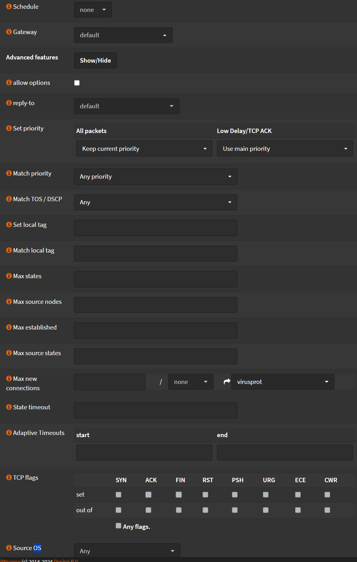

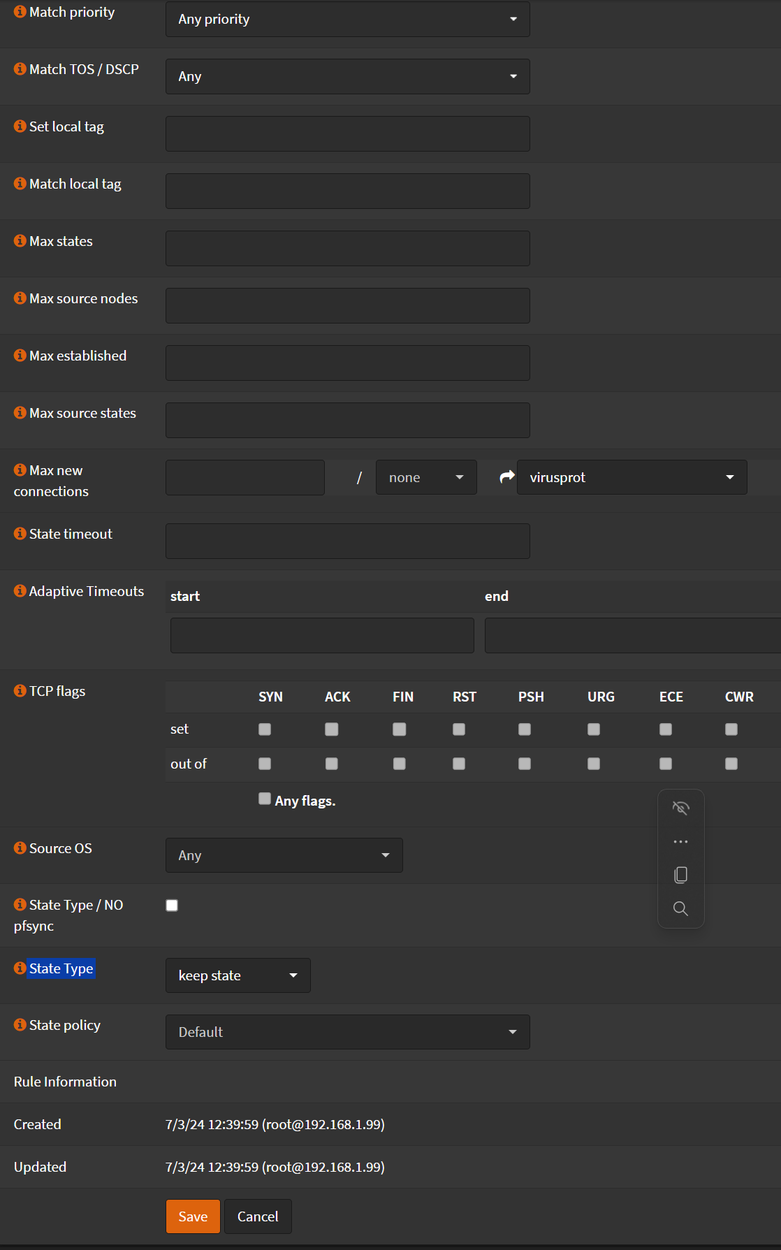

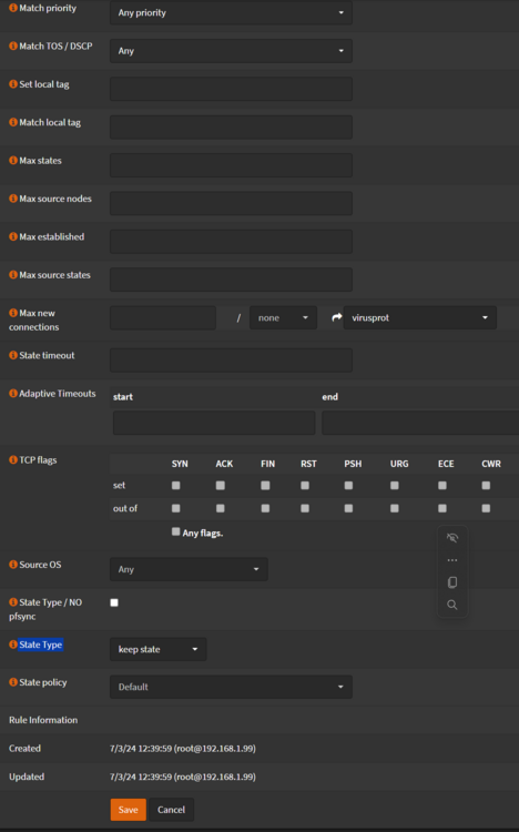

Here is my FLOATING rule.  Could you not just put the IP of your client in regardless of vlan?  Not sure, just woke and am very foggy.
Edited by craigr

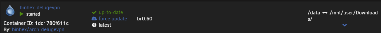

I am having a similar issue to the above. I am running a custom br network for my containers. Now my deluge container is not showing any container IPs or port mappings. I have restarted, redownloaded the image etc. and no luck. When i change the network type to bridge everything works likes normal. When I chnage it back, issue returns. This is causing issues accessing the webUI. Any suggestions? Been using this container for awhile now with no issues and this just started.
Thanks.
I tried with client IP but get blocked "Default deny / state violation" rule.  Thanks for sharing - this will help me sort out my opnsense rules. I will get to it later when I find time. It's just access to the WebUI that gets blocked.
