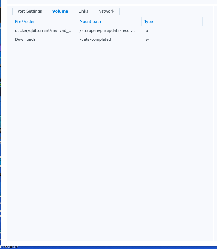

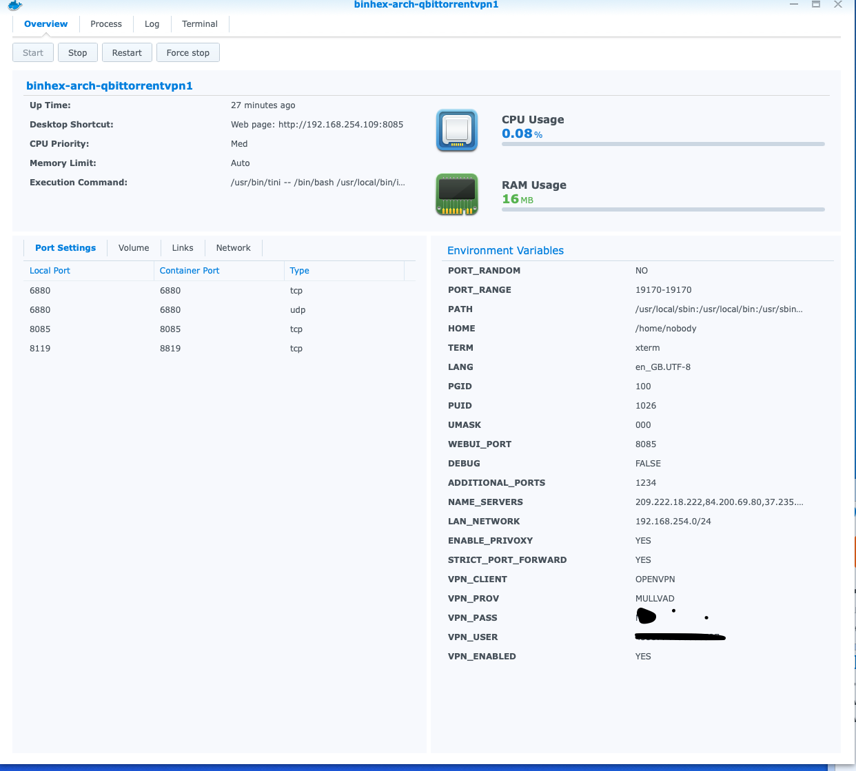

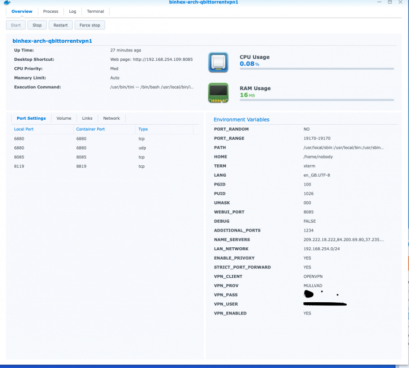

Hey Binhex. Quick question. I re-did this docker yesterday and got it to work, However, when deludge has completed downloading the file. Does it move the file or is Sonarr and Radarr that moves the file? I know this is not Sonarr or Radarr but wanted to see if Deludge is the one who perform this action?
My docker doesn't restart but I keep getting an error and I cant open the webui.
1064072147_ScreenShot2021-01-14at5_21_18PM.thumb.png.81717972efe4829e9daea720e8eb99d8.png
842702302_ScreenShot2021-01-14at5_34_05PM.thumb.png.facb92f4417fe1fd6101efd20d58bb9b.png

2021-01-14 21:39:57.829539 [info] System information Linux binhex-arch-qbittorrentvpn1 4.4.59+ #25426 SMP PREEMPT Mon Dec 14 18:53:21 CST 2020 x86_64 GNU/Linux
stdout
21:39:57
2021-01-14 21:39:57.872548 [info] OS_ARCH defined as 'x86-64'
stdout
21:39:57
2021-01-14 21:39:57.913983 [info] PUID defined as '1026'
stdout
21:39:57
2021-01-14 21:39:57.957521 [info] PGID defined as '100'
stdout
21:39:58
2021-01-14 21:39:58.144039 [info] UMASK defined as '000'
stdout
21:39:58
2021-01-14 21:39:58.186140 [info] Permissions already set for volume mappings
stdout
21:39:58
2021-01-14 21:39:58.229370 [info] Deleting files in /tmp (non recursive)...
stdout
21:39:58
2021-01-14 21:39:58.276966 [info] VPN_ENABLED defined as 'yes'
stdout
21:39:58
2021-01-14 21:39:58.321762 [info] VPN_CLIENT defined as 'OPENVPN'
stdout
21:39:58
2021-01-14 21:39:58.363485 [info] VPN_PROV defined as 'MULLVAD'
stdout
21:39:58
2021-01-14 21:39:58.404981 [info] LAN_NETWORK defined as '192.168.254.0/24'
stdout
21:39:58
2021-01-14 21:39:58.447030 [info] NAME_SERVERS defined as '209.222.18.222,84.200.69.80,37.235.1.174,1.1.1.1,209.222.18.218,37.235.1.177'
stdout
21:39:58
2021-01-14 21:39:58.489440 [info] VPN_USER defined as '4558774458688527'
stdout
21:39:58
2021-01-14 21:39:58.530778 [info] VPN_PASS defined as 'M'
stdout
21:39:58
2021-01-14 21:39:58.572328 [info] ENABLE_PRIVOXY defined as 'YES'
stdout
21:39:58
2021-01-14 21:39:58.614404 [info] ADDITIONAL_PORTS defined as '1234'
stdout
21:39:58
2021-01-14 21:39:58.656800 [info] WEBUI_PORT defined as '8085'
stdout
21:39:58
2021-01-14 21:39:58.697753 [info] Starting Supervisor...
