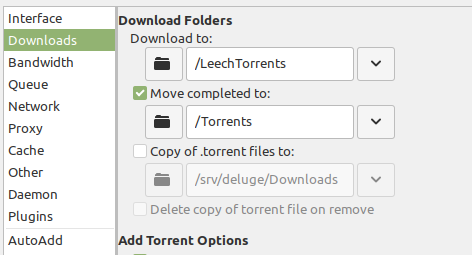

Deluge has a very functional "move on completion" facility.  Look in Deluge -> Preferences -> Downloads. No script required.  Doing the move from deluge ensures that the torrent continues to seed.
It works for me!
/LeechTorrents is a 'cacheonly' share. /Torrents is a normal, protected, share.
It works for me!
this is certainly one way of doing it, but for me this wouldnt work too well as i have split tv/movie collections, so i use the more granular control you get with sonarr to ensure the right file goes in the right location and is also post processed for filename changes and crud removal.
It works for me!
I see this option. The only thing is, there is no option on deluge that says SOnarr move/copy to TV Shows and Radarr move/copy to Movies. If that was an option, this would resolve the issue.
But @binhex on the above comment said that sonarr or radarr are the ones who copy the files. My problem is, that it does not copy all of the files over to the TV Shows or Movies. It works for some but now all, which is very weird.
I always post-process my downloads, for instance, to add subtitles into the mkv or change parameters, synchronise tracks - that's when I make a copy of the mkv in my Movies or Series shares.
In any case, I wouldn't want to upload from the same location as my library.
Yes there is, you have to use lables. When you hare created labels you can right click the label and go to label options. There you set the path to Tv shows and Movies.

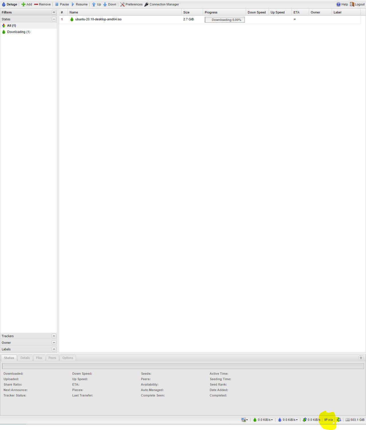

Hey @binhex
I'm currently running the 'latest' image with IvacyVPN and none of my torrents seems to start. I'm currently attempting to download te ubuntu 20.11 torrent for a solid test. And it never starts. Strangely my VPN IP address dosn't show up in the WEBUI but there are no errors about it in the log, picture attached to show what i mean.
The log shows that deluge gets the IP Address and that privoxy starts, No errors. I've turned off port forwarding as i don't pay for it with Ivacy. I tried using Amsterdam as my endpoint and have just tested it using Germany-Frankfurt but nothing changes.
Can you advise? I've obscured my log file below so you can see the log bootup process, nothing sinister that i can see!
2021-01-15 20:10:49,598 DEBG 'watchdog-script' stdout output:
[info] Attempting to start Deluge...
[info] Removing deluge pid file (if it exists)...
2021-01-15 20:10:50,081 DEBG 'watchdog-script' stdout output:
[info] Deluge key 'listen_interface' currently has a value of '141.xxx.xxx.xxx<obscured>'
[info] Deluge key 'listen_interface' will have a new value '46.xxx.xxx.xxx<obscured>'
[info] Writing changes to Deluge config file '/config/core.conf'...
2021-01-15 20:10:50,384 DEBG 'watchdog-script' stdout output:
[info] Deluge key 'outgoing_interface' currently has a value of 'tun0'
[info] Deluge key 'outgoing_interface' will have a new value 'tun0'
2021-01-15 20:10:50,647 DEBG 'watchdog-script' stdout output:
[info] Deluge key 'default_daemon' currently has a value of 'c911ba00193<obscured>'
[info] Deluge key 'default_daemon' will have a new value 'c911ba0019354f<obscured>'
[info] Writing changes to Deluge config file '/config/web.conf'...
2021-01-15 20:10:51,153 DEBG 'watchdog-script' stdout output:
[info] Deluge process started
[info] Waiting for Deluge process to start listening on port 58846...
2021-01-15 20:10:51,484 DEBG 'watchdog-script' stdout output:
[info] Deluge process listening on port 58846
2021-01-15 20:10:54,450 DEBG 'watchdog-script' stdout output:
[info] No torrents with state 'Error' found
2021-01-15 20:10:54,451 DEBG 'watchdog-script' stdout output:
[info] Starting Deluge Web UI...
[info] Deluge Web UI started
2021-01-15 20:10:54,452 DEBG 'watchdog-script' stdout output:
[info] Attempting to start Privoxy...
2021-01-15 20:10:55,456 DEBG 'watchdog-script' stdout output:
[info] Privoxy process started
[info] Waiting for Privoxy process to start listening on port 8118...
2021-01-15 20:10:55,460 DEBG 'watchdog-script' stdout output:
[info] Privoxy process listening on port 8118

In your downloads settings in deluge change the download to path to /data
I also recommend having a complete an incomplete folders. So consider changing the download to path to /data/Incomplete and check the move completed to and add the path /data/Complete. Feel free to use any folder names you want, mine was just an example but /data is a must have since in your template have mapped /data to /media/Plex/Inprogress
Much better to define new container paths, then you have more control of where the various folders are.
I have my 'incomplete' on a cache-only share and my 'complete' on a protected share.
Edited by PeterB
Most people have sonarr/radarr/medusa do the moving and post-processing. That's the easiest way to do it. You end up with the same result, incomplete on cache and complete where they should be on the array. If you do the volume mapping right.
So I do not agree with you that is best to "set up new container paths". At least for new users, they should use the default until they are comfortable with volume mappings. This is also because users often use more containers from the same author and they tend to use the same container paths. So using the default is way easier then to make new ones for all of the containers.
I don't see how defining new container paths gives you more control? They are just mappings to where you have your data. Your data will end up where you want anyway, if you do it right. Creating new ones will confuse new users even more then it needs to.
