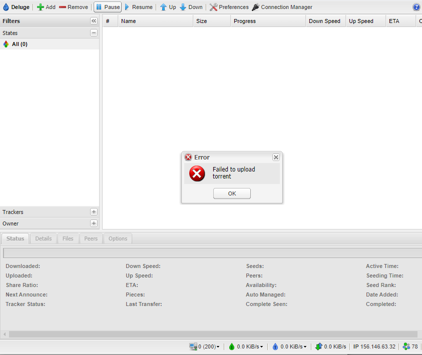

Hello All!  first time posting here.  Thanks in advance!
I tried to setup DelugeVPN and its not wanting to load the webui when the vpn is set to ON.  I went through the config settings and put the cert+vpn list in the openvpn directory just like spaceinvaderone did in the demo but it won't work.  I start the console on Deluge and run the curl ifconfig.io and it gives me a different public ip, so something is working.  I go through the same steps with qbit and it seems to work but would rather not use that client.
What files do I need to look at for logging?  Anyone have suggestions?

I've tried using one country file (netherlands), i've tried using the list that SI1 displays, i've tried using all of them.  I restarted it several times out of frustration and the webui works now.  Does that seem very stable?
Now I go to do a test torrent (ubuntu) and get the message Failed to Upload Torrent.  same torrent worked in qbit.

I get the webui, but still get this failed to upload torrent message.
at the bottom right of the deluge webui, do you see the new ip address given by the vpn provider ?

I get the new public IP, everything looks great but I get this message when I go to test the torrent.

It started working, but whenever I go to start a torrent it throws that error message. Failed to Upload Torrent

Initially the WebUI wouldn't load.  Some how that self-resolved.
Now, the WebUI starts up, I'm able to login to it, has the public IP.  But when I submit a torrent to download it throws the error.  Am I missing something?
Have you tried a different browser. Google shows a lot of these occurrences using chrome.

I switched from Chrome to Edge, that fixed it.  Now I let Sonarr load the downloads in.
