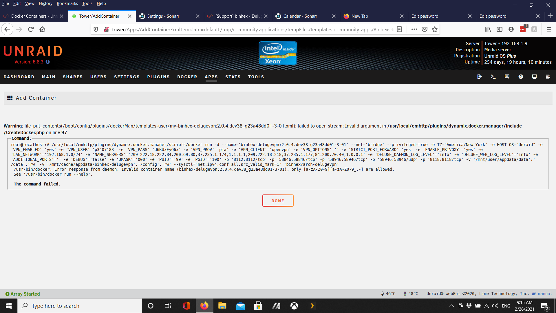

9 hours ago, gordonempire said:
To roll back, I changed the repository from:
binhex/arch-delugevpn
To:
binhex/arch-delugevpn:2.0.4.dev38_g23a48dd01-3-01
2 minutes ago, strahd_zarovich said:
How do you downgrade? I am having the same issue as you.
See above to roll back.

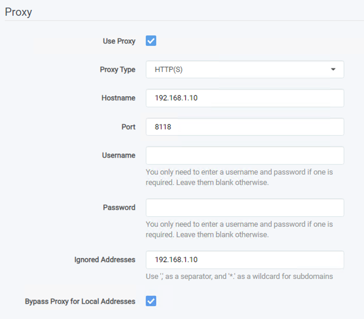

ok thats fine, so you are using privoxy in this case and NOT network binding multiple containers.
so good news, at long last i am able to replicate one of the issues here, so if i set sonarr to point at privoxy running in delugevpn and then add in deluge as a donwload client in sonarr and click on the test button it fails.
the reason it fails is that the proxy settings in sonarr are by default set to route everything via the proxy, this causes a problem when attempting to connect to deluge, as the connection will go as follows:-
sonarr container outbound to privoxy > outbound to lan network (ip is unraid host on lan range) > re-routed back to delugevpn container > and then finally connect to deluge, and then traverse all the way back again to reach sonarr.
in short the solution to this is to set sonarr not to use the proxy for local network addresses, this does indeed fix the issue, this is done in sonarr by doing the following, note the 'ignore addresses' field, the below is a single ip, but if you want you can do your whole network using wildcards, e.g. 192.168.1.*
The alternative to this approach is simpler, you create a jackett container, you set jackett to use privoxy and then you set sonarr etc to use jackett, this negates the requirement of setting a proxy on sonarr, radarr or any other indexer, as jackett is doing routing for you via privoxy (how i have mine setup).

Okay, looks like adding my network "10.100.1.*" to "Ignored Addresses" in both Sonarr and Radarr fixed the connections issues between them, Jackett and DelugeVPN. It looks like just checking the box "Bypass Proxy for Local Addresses" will not work on its own. Thank you so much.
This is also true for any physical devices I use, aka laptop, desktop, mobile device:
You have to specify the IP addresses or entire subnet that you want to bypass the proxy for. Checking the box alone doesn't work.
All issues resolved! Thank you!!!
