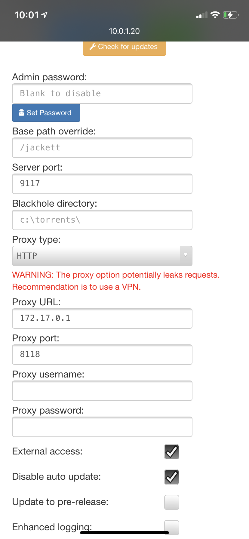

2 minutes ago, wgstarks said:
It works for me using the IP of the docker network. docker0 in my case.
Ah, interesting. Could you share a screenshot of the Jacket proxy settings?
Is that a 172.x.x.x IP?
Sorry, I can’t remember the terminal command to lookup the IP.
No terminal command required, it's shown on the docker page in unraid:
One thing to keep in mind if you go down this route (pun intended) is that the docker IP is dynamcially assigned and could change on restart of containers or the unraid server. If things always start in the same order it probably won't, but just be aware of it if things suddenly stops working again.

In Jackett proxy config you should use the 172.17.x.x IP of the DelugeVPN container. I think this also assumes that both Jackett and DelugeVPN containers are using the same docker network, which is bridge by default:
Right, thanks. I tried that - no dice.
