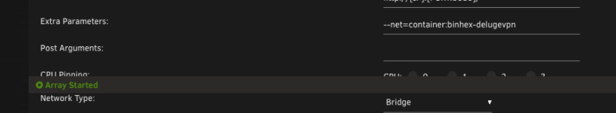

12 minutes ago, helpermonkey said:

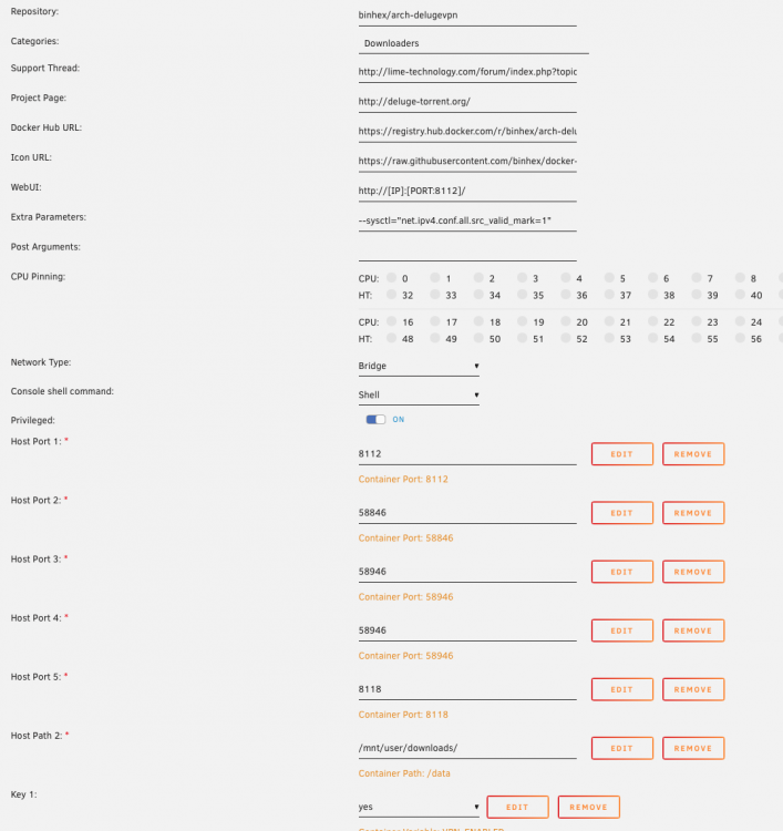

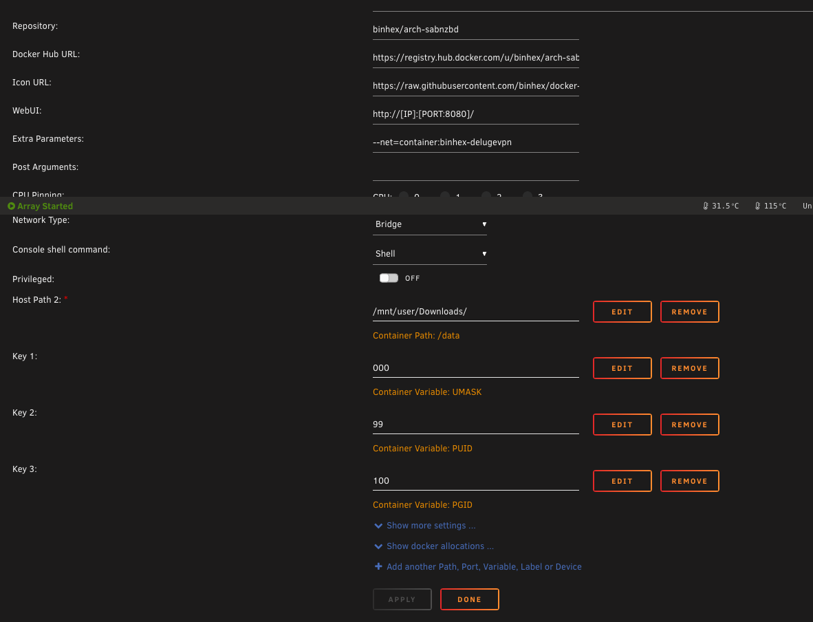

Okay - attached are screen shots of SAB & Deluge (taken before i turned debug on in deluge) as well as the log files per those instructions.
you have not set sabnzbd correctly, see below:-
note the fact you have set the extra parameters correctly BUT network type is still set to bridge, this needs to be set to 'none'.
see Q24:- https://github.com/binhex/documentation/blob/master/docker/faq/vpn.md

ah whoops - yes sorry that was something i tried and forgot to switch it back. FYI - i havej sut switched it back and i'm still not able to access Deluge or SAB gui.

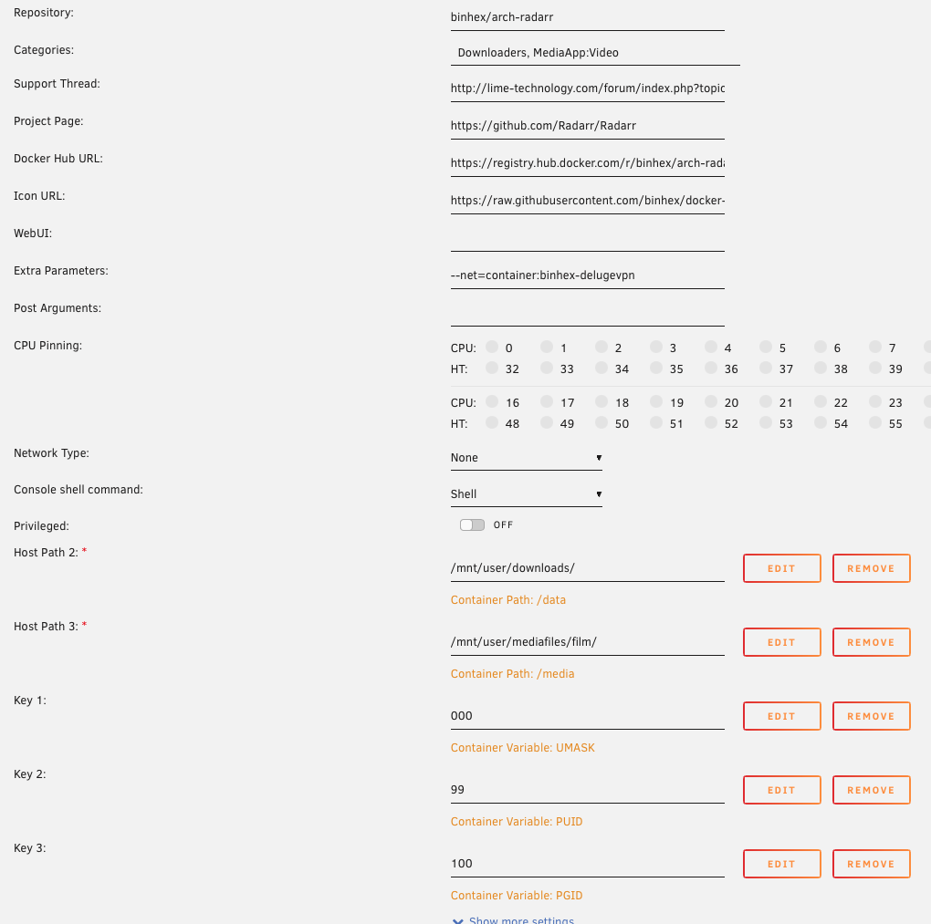

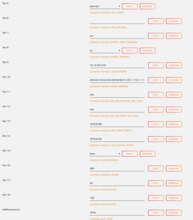

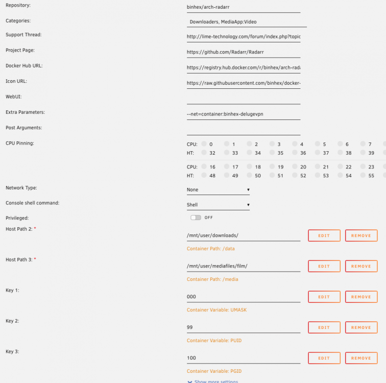

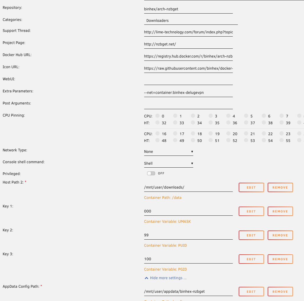

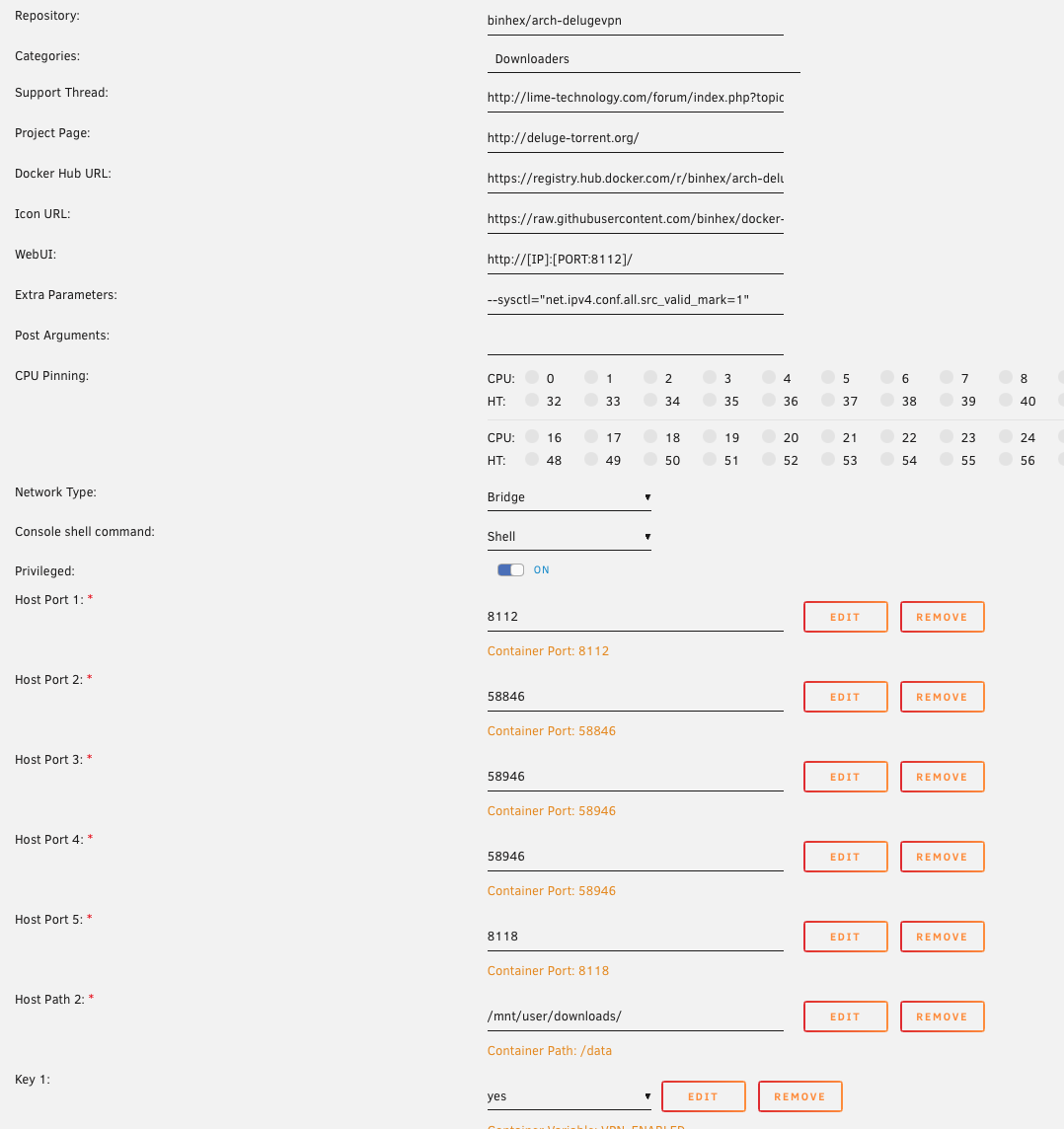

Dear Binhex,
I am kind of lost finding a solution, and I am most grateful if you find time to help me. I want to run b-nzbget and b-radar thru b-delugevpn. Delugevpn is running and I can connect to WebUI. Nzbget is running, no log error. But I can not connect to WebUI, "server:6789".
Binhex-radar is running and I can connect to WebUI. Testing indexer and download clients = ok, but downloads and media library do not work.
Setup pictures are attached. Happy for any help.
Cheers,
Frode

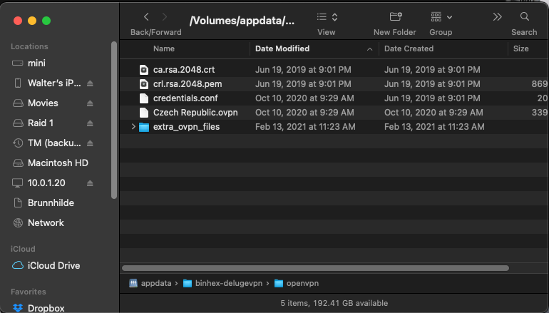

Is there a way to specify which PIA server to use? My firewall blocks many countries, and I've had connections issues with port forwarding inside this docker as a result. Would like to choose a server in the whitelist...
You specify the server by which ovpn file you place in the openvpn folder.
In this example I'm connected to the Czech Republic server.
OK, thanks. I'm running the Wireguard version. Is there a like setting for that?
