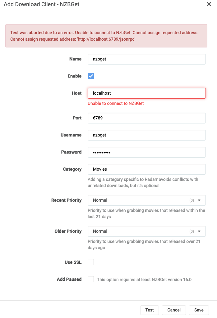

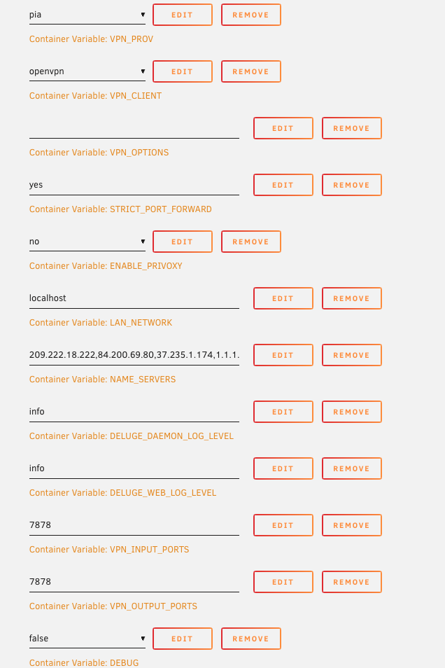

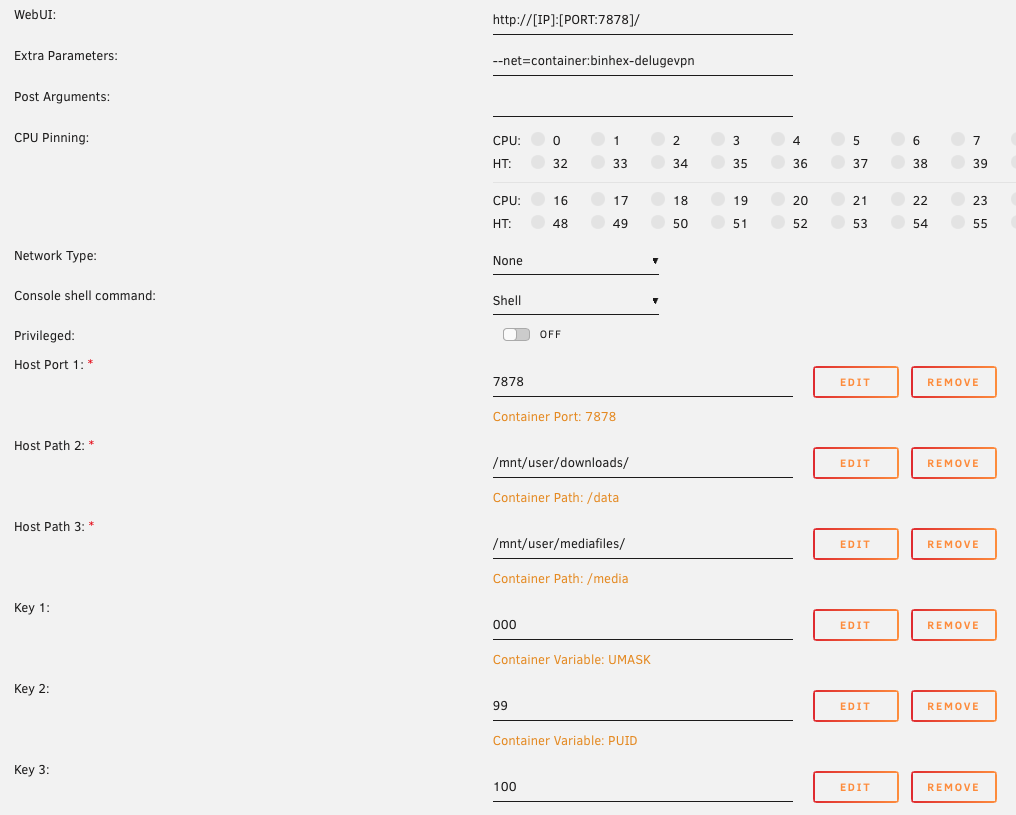

Binhex-radarr thru binhex-delugevpn is mostly up and running, but I can not get the nzbget client to work. Deluge downloader client is fine. I have added setup pictures.
And, Q24 bullet 4 in the VPN Docker FAQ says
Container to route through VPN
4. Remove all ports defined (no ports required as we will be accessing it via the vpn container).
Should radar docker WebUI and Host Port 1 be deleted?
yes, it says delete ALL ports, if nzbget is NOT part of the vpn network then see Q27 from the recommended post at the top of the screen.

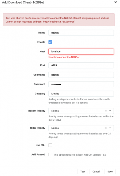

Thanks,
All ports in radarr deleted, and added 6789 as described in A27. Still not nzbget client running. Ran the nzbgetvpn docker default LAN_NETWORK or "localhost".
