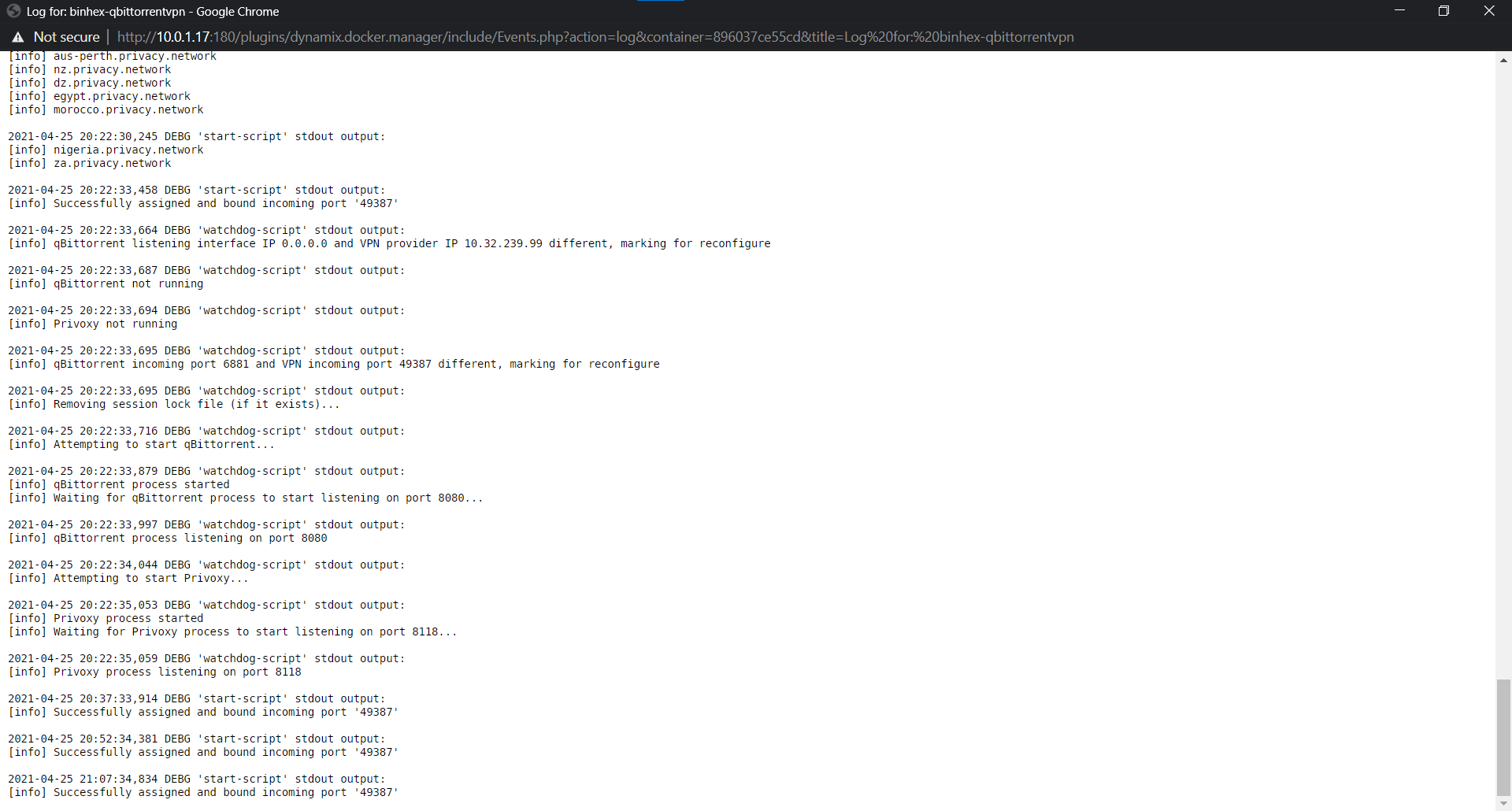

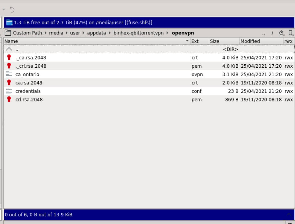

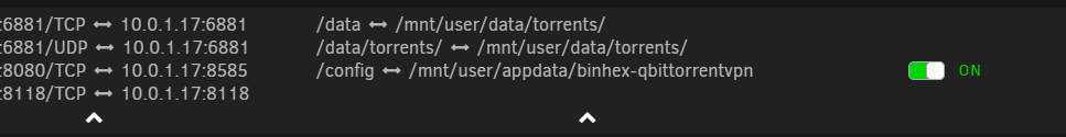

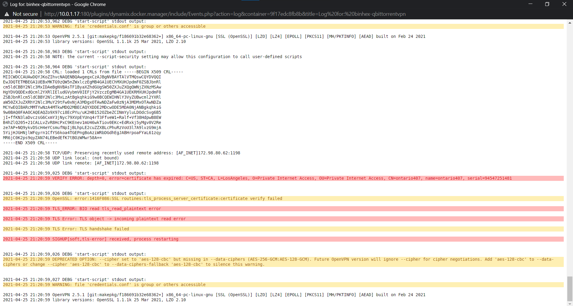

So I feel like other people have been having the same issue, but I've tried some of the fixes in this and the qbittorrent thread to no luck. I use PIA and recently the WebUI of deluge and qbittorrent won't load when I enable the VPN in the container settings, but it will when I disable it. I downloaded the most recent OpenVPN config files from PIA, with no luck. I also changed the files from Toronto to Ontario, as someone mentioned in this thread, also to no luck. Removing the container image and deleting all files with the CA cleanup utility and starting fresh also did nothing. Before the issue, I had set VPN client to OpenVPN in the settings, which seemed to cause a lot of errors in the logs when I noticed the WebUI stopped working (first image). Changing the client to Wireguard stopped the errors, but didn't fix the issue (2nd screenshot). I only had the chance to grab screenshots from qbittorrent, but everything's the same in my deluge container and only this thread has mentioned the issue so far.
Run Command:
root@localhost:# /usr/local/emhttp/plugins/dynamix.docker.manager/scripts/docker run -d --name='binhex-qbittorrentvpn' --net='bridge' --privileged=true -e TZ="America/Chicago" -e HOST_OS="Unraid" -e 'VPN_ENABLED'='yes' -e 'VPN_USER'='p9059745' -e 'VPN_PASS'='Pchmielparry1' -e 'VPN_PROV'='pia' -e 'VPN_CLIENT'='openvpn' -e 'VPN_OPTIONS'='' -e 'STRICT_PORT_FORWARD'='yes' -e 'ENABLE_PRIVOXY'='yes' -e 'WEBUI_PORT'='8080' -e 'LAN_NETWORK'='10.0.0.0/24' -e 'NAME_SERVERS'='209.222.18.222,84.200.69.80,37.235.1.174,1.1.1.1,209.222.18.218,37.235.1.177,84.200.70.40,1.0.0.1' -e 'VPN_INPUT_PORTS'='' -e 'VPN_OUTPUT_PORTS'='' -e 'DEBUG'='false' -e 'UMASK'='000' -e 'PUID'='99' -e 'PGID'='100' -p '6881:6881/tcp' -p '6881:6881/udp' -p '8585:8080/tcp' -p '8118:8118/tcp' -v '/mnt/user/data/torrents/':'/data':'rw' -v '/mnt/user/data/torrents/':'/data/torrents/':'rw' -v '/mnt/user/appdata/binhex-qbittorrentvpn':'/config':'rw' --sysctl="net.ipv4.conf.all.src_valid_mark=1" 'binhex/arch-qbittorrentvpn'
9f17edc8fb8baa0a4136f909c6f274d3830d8042a5733616e7cb2a580d09f054
The command finished successfully!
I also attached pics of the ports and OpenVPN within Appdata. This is probably a pretty minor issue with something that I'm overlooking.
image.thumb.png.39c832e2be8c3c52ef1ec1c4b962bd2e.pngimage.thumb.png.4cfa5a1ece26516e0cbda3a8510401f6.pngimage.png.b54a9d8b1c7f5387f751d4369dfd4c43.pngimage.png.6dee7210b225745af00c86263579c43e.png
home-diagnostics-20210425-2215.zip
Edited by AlphaOmegaKappa
the cert looks to be invalid, re-download the .crt file from pia, also delete the files that start with '._' they might be causing issues.
