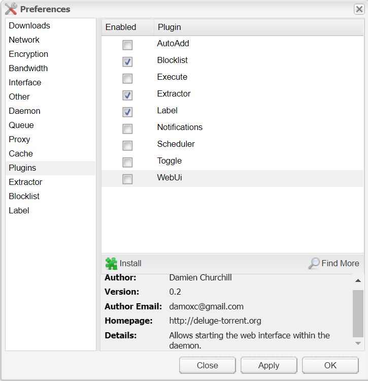

On 5/5/2021 at 1:41 PM, tetrapod said:
Also posted this to Organizr thread
Having problems with getting organizr to communicate with deluge docker (using binhex-delugevpn). I have followed the instructions and downloaded the egg file WebAPI-0.4.0-py3.7.egg for Deluge. Renamed it WebAPI-0.4.0-py3.9.egg and installed it. I can however not tick the box to enable the plugin and I'm getting API Error (no. 2) when testing the connection from Organizr.
I also can not find out how to remove the plugin from Deluge to start over again 😐
Is this something I can not do in this container?
Got an answer from @ados in another thread.
On 5/6/2021 at 1:18 PM, ados said:
The main issue with that application is support which has decreased over time.
You need to stay on older versions if you wish to have plugin support.
Keeping it short as this belongs over on the Deluge forum, you need to be on a 2.0.X version. 2.0.4 is a good one. 😉

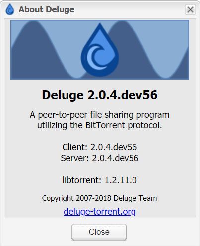

...and this container show deluge as being om 2.0.4?
Now, I have never handled plugins for Deluge befor so it could very well be me who is doing something stupid (again).
There the plugin is, but I can't Enable it and I do not know how to remove it.

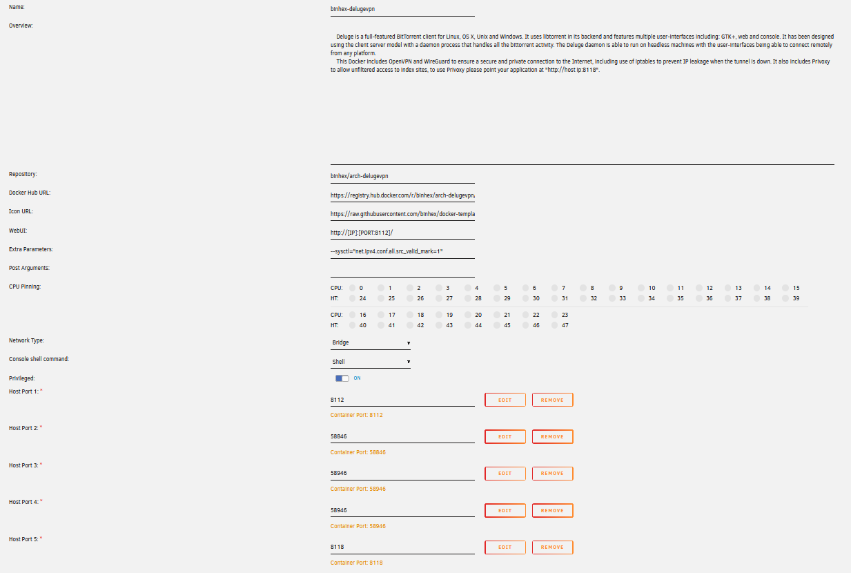

Ok, just my 5 cents here, because I'm no expert at this. But, shouldn't the Deluge port be added to VPN_INPUT? And, I don't think that you should have the same port in VPN_output - I'm sure that is adding confusion
See my config here:

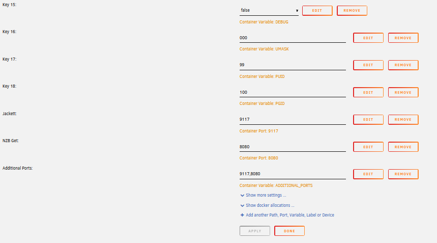

Now, I don't have the same setup as you, but before I got NZBHydra added I only had Jacket routed through Deluge and Jacket do not need to access to any containers (except Deluge), it's just the arrs that need access to Jacket. Configured like that I didn't need any port configured for VPN_OUTPUT
When I added NZBHydra, that container needed access to the arrs and then I had to add these ports in VPN_OUTPUT
I hope that can help a little.

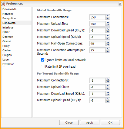

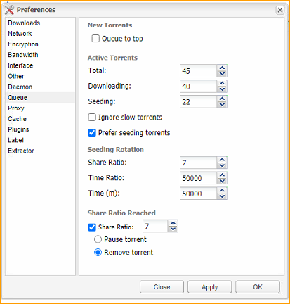

I have an odd issue i cant seem to find a fix for. I'm not really seeding anymore, use PIA and go through IPTor. Currently have the top 10 most leeched items in deluge just sitting there with no seeding. I am getting seeding on some items from time to time but its like they stop seeding way quick.
Facts:
1. Downloads are perfectly fine and run at very good connection speeds
2. Torrents do show up in IPTor peers list but with 0 seed time, 0 ratio etc etc.
3. After disabling privoxy some connections would come through but still nowhere near where traffic used to be (56kbps or less for less than 1 minute each connect)
4. Connection speed available is 1000mbps up / 45mbps down
5. running these on a windows computer through deluge yields normal results (seeds properly, shows up in IPTor, seeds at good speeds of mbps instead of kbps) all on the same network.
Steps I've taken to remedy
1. Redownloaded PIA certs and changed to Czech
2. Changed queue settings and even went to high numbers just to see if there was any change
3. Also changed Bandwidth preferences... no change
4. Restarted server, rebooted modem/router and even factory restored both and updated firmware with no change on all
5. Setup unraid as DMZ to ensure there was no port issues (no change) and setup Port Forwarding also with no change
6. Tried with and without Privoxy setting being on (I'm not currently using privoxy). Without would let some connections happen on restart but after a minute or two they would all stop seeding again.
33 minutes ago, Remamian said:

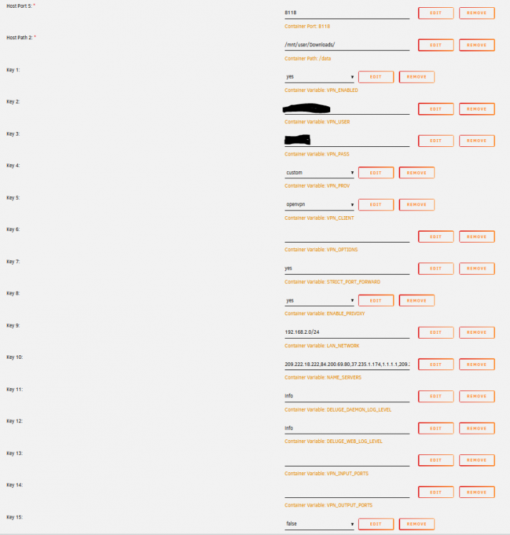

Im running delugevpn - All is working fine but the torrents themselves are not downloading. The dht seems to work and I can see traffic flowing there. The downloads are added etc and I can reach the console. Not seeing anything odd in the logs either. I started openvpn and the connection is established.
The setup is somewhat advanced since its docker in lxc on proxmox...
Anyone has a clue how to start figuring it out?
/M
/M
This sounds like a volume mapping issue or a wrong path in the downloads section in deluge. Post your docker run command and a screenshot of the downloads section in deluge.

Yes - Think so too. Changed to 777 and it started working so Ill need to test so I can change back. Thought it was something with the tun device but obviously not :)
Facts:
To add, the torrents DO show peers connecting, just no bandwidth being used.

At first I suspected my VPN provider (PureVPN) and there outdated OPENVPN files, however, downloading from SAB I get the 4-5MB/s that I would expect from my ISP (I live in Australia), so the VPN is not causing a bottleneck.
Deluge torrents either don't download at all (no peers, just no activity at all) or it is extremely slow. Switch the vpn off and I can get the speeds I would expect.
Things I've tried:
Wiped Deluge, SAB and Jacket (including appdata files) and started again.
Installed Binhex qbittorrentvpn - same behaviour.
Tried running qbittorrent (without vpn) through deluge (mimicking SAB) - same behaviour.
PureVPN on windows or Kali work fine and I get expected speeds using speedtest.net
I'm at the point of setting up a Kali VM just for the torrent side of things, but that is presenting a whole different set of issues.
Any help is greatly appreciated.

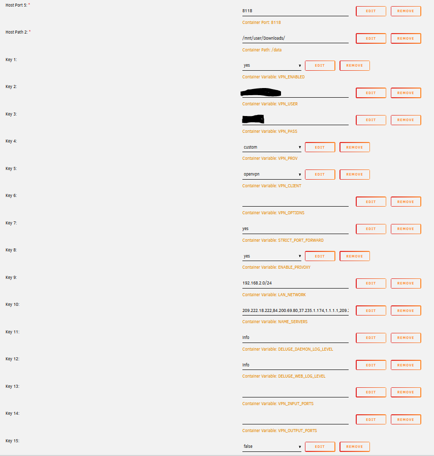

1 hour ago, Philby1975 said:
This is really starting to do my head in.
I have DelugeVPN setup and everything is working fine except for the torrents themselves.
All containers (SAB and Jacket) running through Deluge have the correct external IP and are accessible from the webui so I'm pretty sure I have done everything required from the Feb IP tightening; and pretty sure the torrents were working when this was done.
Things I've tried:
First of all, you need to change your password asap, as it's in the log you posted.
Second, set the STRICT_PORT_FORWADING to no, this setting only applies to PIA users.
You need to have an open incoming port to get good speed. Have you port forwarded a port? It's unclear to me if purevpn offers port forwarding or not. In a quick google search, their website talks about port forwarding and what it is, but I can't see anything about if they offer port forwarding or not. I saw something about you need to download their app maybe?
Are you on a private tracker? If so most of them require an open incoming port. And if you don't have it they won't let you download or it will be very slow. Try to download a well-seeded torrent on a public tracker, like a ubuntu ISO or something. Then you should at least be able to download, but the speed will be much slower than with an open incoming port. If you can download it on a public tracker you know it's definitely a port forwarding issue that's causing you to not be able to download on your private tracker.
And there's no point in testing the speed on speedtest.net, that only works for web browsing and web downloads. The speed you get on torrents has nothing to do with your web browsing/web download speed as many factors are taken into account with torrenting. The only thing speedtest.net will tell you is that you MAYBE can get that speed, if all the conditions are right.
Have edited and blocked it out. I'm guessing the worst anyone can do is use my VPN to download some stuff so this isn't urgent ??
Will sort it out in the morning and try the other stuff you suggested. Thanks so much for your response Strike.
I seem to have lost access to the docker GUI and not sure how to resolve it.
Everything was working OK, but I recently got improved broadband so I was tweaking my preferences in the web GUI to reflect my better download/upload speeds.
I reloaded the page but now the web GUI won't load, and I'm not sure what to do to get it back. I tried restarting the docker and rebooted unraid to see if that resolved it but no dice.
The settings I changed in preferences were:
Network extras - just enabled DHT and Peer exchange
Bandwidth - changed max download and upload speeds; changed max hal-open connections
Queue - changed total active, total active downloading and total active seeding, enabled do not count slow torrents
That's it. I can't see how changing any of those would break it to the point I can't access the web GUI, so I can only assume it's just a coincidence and something else is afoot.
Can anyone help me get the web GUI back? TIA
EDIT: Thanks to Idaho121 below I know this is now a VPN issue associated with PIA not working

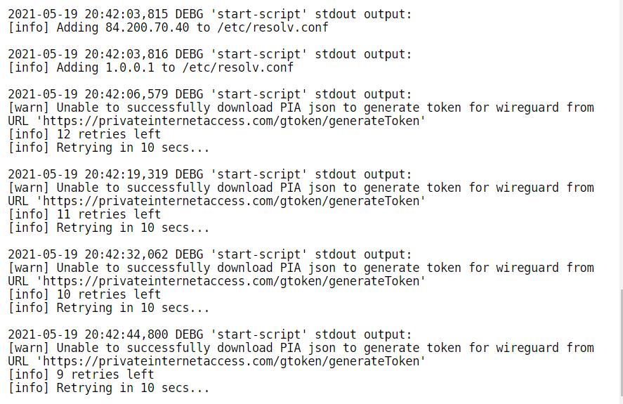

Everything was working fine until a few days ago. Then, Deluge stopped auto-loading/deleting torrent files from the relevant folder. Then, after I restarted to see if that would fix it, I can't get into the WebUI and I'm getting the following errors when loading:
2021-05-19 14:24:15 DEPRECATED OPTION: --cipher set to 'aes-128-cbc' but missing in --data-ciphers (AES-256-GCM:AES-128-GCM). Future OpenVPN version will ignore --cipher for cipher negotiations. Add 'aes-128-cbc' to --data-ciphers or change --cipher 'aes-128-cbc' to --data-ciphers-fallback 'aes-128-cbc' to silence this warning.
[warn] Unable to successfully download PIA json to generate token from URL 'https://privateinternetaccess.com/gtoken/generateToken'
[info] 10 retries left
[info] Retrying in 10 secs...
I downloaded new files from PIA and have tried a few different of their endpoints that are on the list and that others who have had this issue noted as working.
Any thoughts on what else to try?
Thanks!
Thanks!
Thanks! I just checked my log and I have the same error. Turned off the VPN and my web GUI is back - so mine was a PIA issue.
It looks like PIA is borked in the docker at the moment then
I am getting an error while trying to start the docker.
I got this problem before but a reboot of the docker or even the complete system would restart it. Turning off the vpn starts the dockers.
I use PIA and wireguard. It worked until a few hours ago and after I restarted my dockers it doesn't want to start.
Starting the VPN client in Windows works just fine.
Same error for me.  Following thread for a solution.
