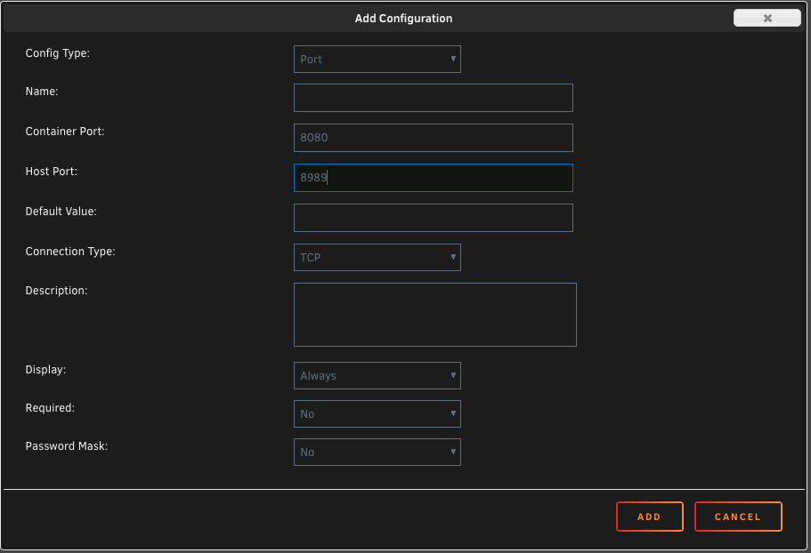

My apologies if this is an issue that has been dealt with but, scanning back through the past few pages I haven’t come across a solution. However it is similar to many issues.
I set up delugevpn per spaceinvaderone’s video on How to route any docker container through a VPN.
I am trying to route my binhex-sabnzbd through deluge. I followed his steps and I can `curl ifconfig.io` to see that binhex-sabnzbd is in fact routing through the VPN properly.
Now I can’t see the WebUI. I came across the Q&A and tried to follow Q25-27 and set up the containers according. But I still have no luck. My first question is what do you mean to set the VPN container to localhost instead of Lan IP? How is that accomplished? I have deluge set to Bridge. If I set it to host it returns an error about the extra parameters not being allowed.
Network is 192.168.4.0/24
Server is
I have deleted the port:8989 (had to change from 8080 due to conflicts) from my  binhex-sabnzbd container and added --net=container:binhex-delugevpn and made the network None.
In deluge I have privoxy Yes, I added 8989 to VPN_INPUT_PORTS and added a port variable at the end for 8989.
When I try and access <server-ip>:8989 with another pc on the network I get a 503 splash screen. Says the privoxy on (172.17.xx.xx) port 8118 enabled. Then it says the connection could not be established.
I feel like this is going to be a simple settings issue. Thank you for any help.
EDIT:
The error 503 was because I proxied my internet browser with deluge.
The current issue is that the WebUI does not display. It returns ERR_CONNECTION_REFUSED.
Edited by wortzinator

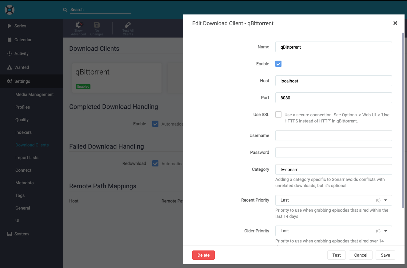

On 6/12/2021 at 6:47 PM, strike said:
When you read the faq to get the webui working it didn't occur to you to continue reading it? See Q27: https://github.com/binhex/documentation/blob/master/docker/faq/vpn.md
That isn't my problem. That's a solution for having containers inside the VPN network connect with containers outside the VPN network.
My problem is that containers inside the VPN network aren't even connected to the internet, let alone the VPN.
I also don't understand this part of the FAQ:
The other change you will need to do is when defining connections from an application to another application in the same VPN container network then you will need to set the host to 'localhost' and NOT the LAN IP address, this is because the applications are now bound to the same network and thus should communicate over 'localhost'.
Set the "host to localhost"? What host? Where?
Edited by Stubbs
host is the host field in sonarr/radarr/etc and 'localhost' is a set name that all containers have, it means the ip address of the machine the application is running on (127.0.0.1), an example screenshot from my sonarr instance demonstrating this, note the 'Host' field:-
Do you set the application to localhost before you remove all of the ports from the docker template? I am not able to enter the WebUI in order to enter this value once I remove the ports even after adding the WebUI ports to the correct spots in the Deluge template.
ok so you cant access sabnzbd web ui and its routed through delugevpn correct?, so ensure firstly that values for key 'VPN_INPUT_PORTS' are specified correctly, this should have a value set for the web ui port for sabnzbd, by default that is 8080, is this set correctly?.
My Bitwarden was set to 8080 before installing sabnzbd so I remapped it to 8989 but, yes. I had 8989 on VPN_INPUT_PORTS and also added a new port called sab with host/container port set to 8989.
you should not change the container side port, this HAS to be a set number, for sabnzbd that is 8080. leave host port as 8989 and ensure VPN_INPUT_PORT is 8989.
Apologies for the amount of ignorance here but, I’m new to anything unraid/docker that isn’t just click start to deploy and then it works.
Are you saying that I can’t change the WebUI port on the container I am trying to rout to the VPN container? Or are you saying that I should not add a new port in delugevpn?
I think I may have been unclear, I added the new port called sab in the delugevpn container along with adding 8989 to VPN_INPUT_PORT.
neither :-), what im saying is the 'Container Port:' value for the port you have added to delugevpn MUST be 8080, it cannot be changed, what CAN be changed is the 'Host Port:' this can be whatever you like as long as it's not already in use, an example of what i mean, note the container port number:-
Okay, so as long as I’m tracking correctly; in your picture above if I set my WebUI of that specific container to 1234 then in the Host I would set that to 1234 but then the Container would be 8080 because that is the default port of that specified container?
