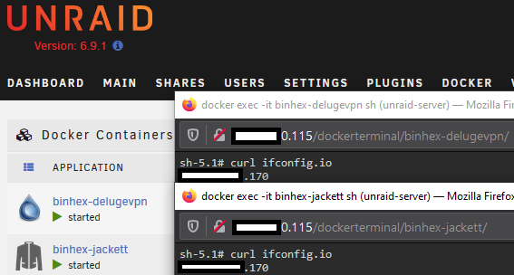

I have followed Spaceinvader One's video describing how to route the network traffic of one container through another on my Unraid 6.9.1 installation. Specifically, I have routed my binhex-jackett container traffic through my binhex-delugevpn network. To do so I first edited the jackett setup
  • Network type from "Bridge" to "None"
  • Added Extra Parameters: '--net:container:binhex-deluge'
Then edited the delugevpn setup
  • Added new port utilizing jacket's (9117, 9117, TCP)
Utilizing Spaceinvader One's trick to view the container's IP with `curl ifconfig.io` I can confirm that both containers share the same IP address. I can also view the logs of each container and both are running normally (based on what I have viewed in the log outputs before).
I have also performed the same steps to route another container's, netdata, traffic through the delugevpn container to see if it is just an issue with jackett. I can also confirm that it shares the same IP address and the logs "look fine". Though for either container if I navigate to my server's IP address with the specific port for a given routed container, the WebUI still does not load.
Interestingly. While the Web UI for jackett does not load, after it has failed it seems to have resolved to the '/UI/Dashboard'
Though, I have visited the Web UI prior to implementing these changes, so I assume that is just cached in my browser... But, this does not happen when attempting to navigate to netdata's address.
My only other guess is that I need to edit delugevpn's "Connection Manager" to allow for a new/another connection from the containers?.. I have tried a few seemingly logical connection settings to no avail.
Potentially, should I disable 'STRICT_PORT_FORWARDING' in the container setup? I assume this is related to the IP tables of the container and does not have much to do with the described situation though..

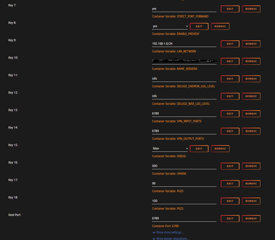

Hi @binhex. I'm trying to test the speed within the container, and I'm following @SpaceInvaderOne video here https://www.youtube.com/watch?v=m7Qly7a_-M0 When I try the command
pacman -S speedtest-cli
I get the following errors:
failed retrieving file 'speedtest-cli-2.0.2-2-any.pkg.tar.xz' from mirror.pseudoform.org : Protocol "rsync" not supported or disabled in libcurl
Anything I should do, don't do? Google results are showing to update pacman with "pacman -Syyu"

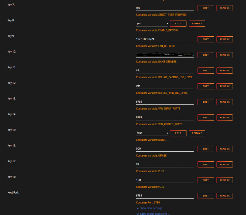

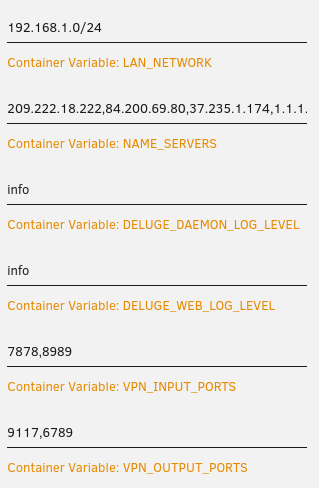

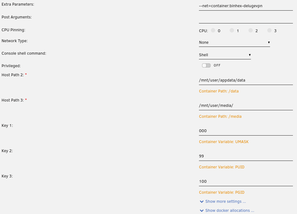

I'm finally getting around to updating and getting things working again after the tightening. I've followed the stickied post and spent hours in the FAQ trying to get this working, but I can not get other docker web GUIs to load. b-delugevpn settings:
Lan Network is correct and been verified using the tool in Q4 on FAQ. I followed SpaceInvader One's video on routing through deluge and when typing "curl ifconfig.io" in each of the container's consoles I'm getting the IP from the vpn. Radarr's configuration:
As you can see the extra parameters are set, the network type is set to none, and I've removed any port designations.
One thing I noticed is when the container starts, there's nothing under Port Mappings in the main docker page. See below:
I have never used NZB, I just downloaded it to see if the web gui would load, which it does not. I'm unable to get the web gui to load on any container going through delugevpn. I've changed ovpn files to try different servers, but still no web gui. Not using privoxy in Deluge. I've also made sure deluge was restarted then the other containers restarted once deluge is up and running, still no web guis.
Radarr Log Output
Deluge Log Output
I've checked for spaces or weird line endings in the extra parameters box on each container, it's all correct. At this point I have no idea how to get the web guis to come back Thanks for any help!
Radarr Log Output
Deluge Log Output
Hey mate. No idea why you are using this way to route traffic via binhex-delugevpn. Just leave the defaults settings for Radarr, but within radarr > Settings > General > Proxy eEnable it and under hostname use binhex-delugevpn ip and the contairner port.
I'm talking about this guide.
Radarr Log Output
Deluge Log Output

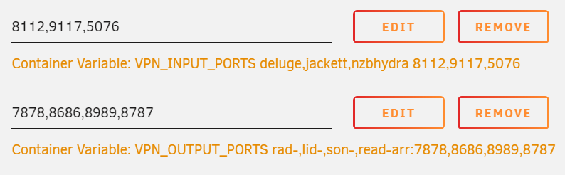

Check your vpn container env. variables.  I had to add the VPN_INPUT_PORTS variable per the FAQ recently to fix this.

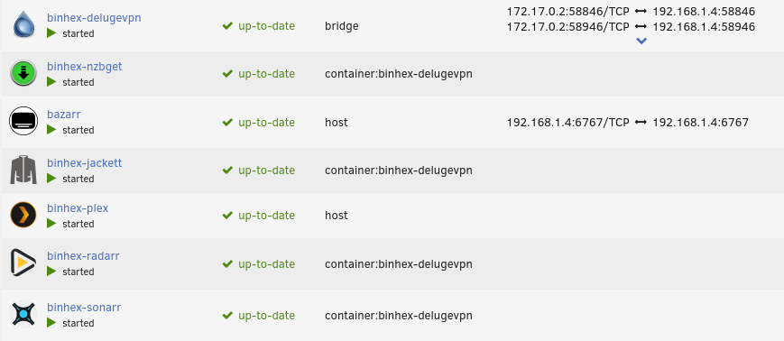

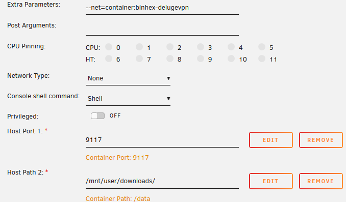

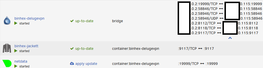

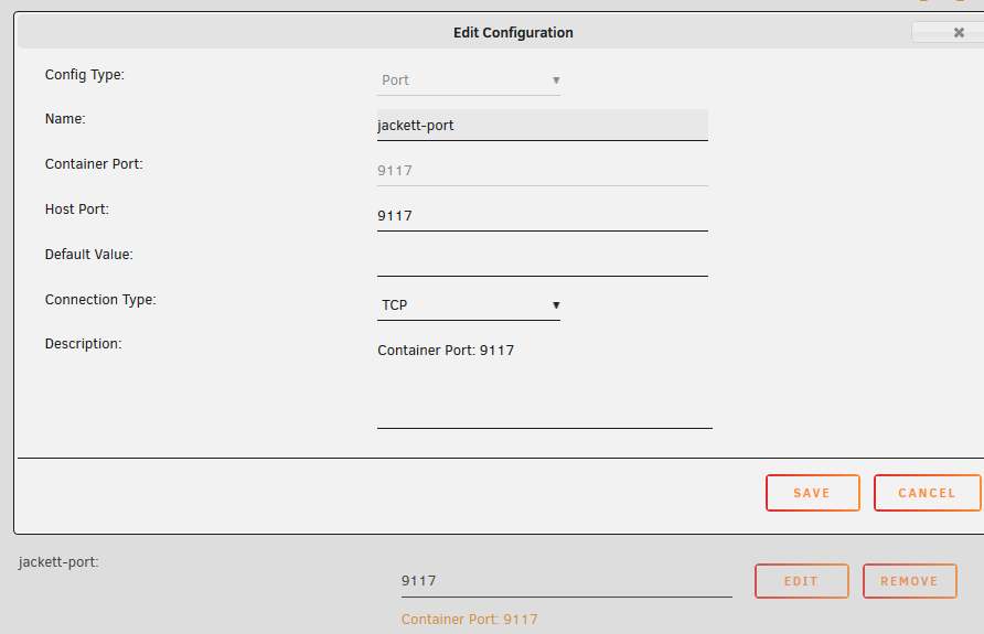

On 4/29/2021 at 9:32 PM, kevindckr said:
XPost from General Support
I have been going the same route and had some problems. Did you configure these ports in the binhex-delugevpn container config?
I missed this and was struggling until I had read and fully understood Q24-27 in binhex exelent guide:
https://github.com/binhex/documentation/blob/master/docker/faq/vpn.md
Radarr Log Output
Deluge Log Output
I'm using about the same setup, but I'm only routing Jacket and NZBHydra through binhex-delugevpn. Are you sure you haven't switched which ports go where for the VPN ports? My config is this:
Maybe It's me who got it wrong :-$ but I don't think so. Works fine between the dockers and Jacket and NZBHydra are accessing through the deluge VPN. There is no longer a WebUI alternative when clicking the docker, but that is not to be expected
After reading the Github Q&As, i got everything working but now my Nzbget is unreachable by my Sonarr and Radarr.
  • Sonarr and Radarr are NOT using proxy and are NOT using a VPN
    • The download client "nzbget" is pointed towards the 192.xxx address
  • NZBget is using binhex delugeVPN.
  • In binhex delugeVPN i've added Host Port for 6789. Port 6789 is added in VPN INPUT and OUTPUT ports.
  • NZBget container starts fine, and the webui is reachable. After a few minutes the webui is no longer reachable and sonarr and radarr cannot communicate to NZBget.
    • NZBget log has constant "[ERROR] Binding socket failed for 0.0.0.0: ErrNo 98, Address in use"
I'm really lost on what to do. Does anyone know why nzbget can be connected to by webui and sonarr/radarr for a few minutes and then it can't communicate/connect?
EDIT 1: Restarted the server and restarted docker multiple times. Immediately, I am able to connect to nzbget via the 192 local IP and port 6789. If i go into sonarr/radarr or close nzbget tab and try to go back into it, i can't connect to the webui and sonarr/radarr can't connect to it.
Ok, just my 5 cents here, because I'm no expert at this. But, shouldn't the Deluge port be added to VPN_INPUT? And, I don't think that you should have the same port in VPN_output - I'm sure that is adding confusion
See my config here:
Now, I don't have the same setup as you, but before I got NZBHydra added I only had Jacket routed through Deluge and Jacket do not need to access to any containers (except Deluge), it's just the arrs that need access to Jacket. Configured like that I didn't need any port configured for VPN_OUTPUT
When I added NZBHydra, that container needed access to the arrs and then I had to add these ports in VPN_OUTPUT
I hope that can help a little.
