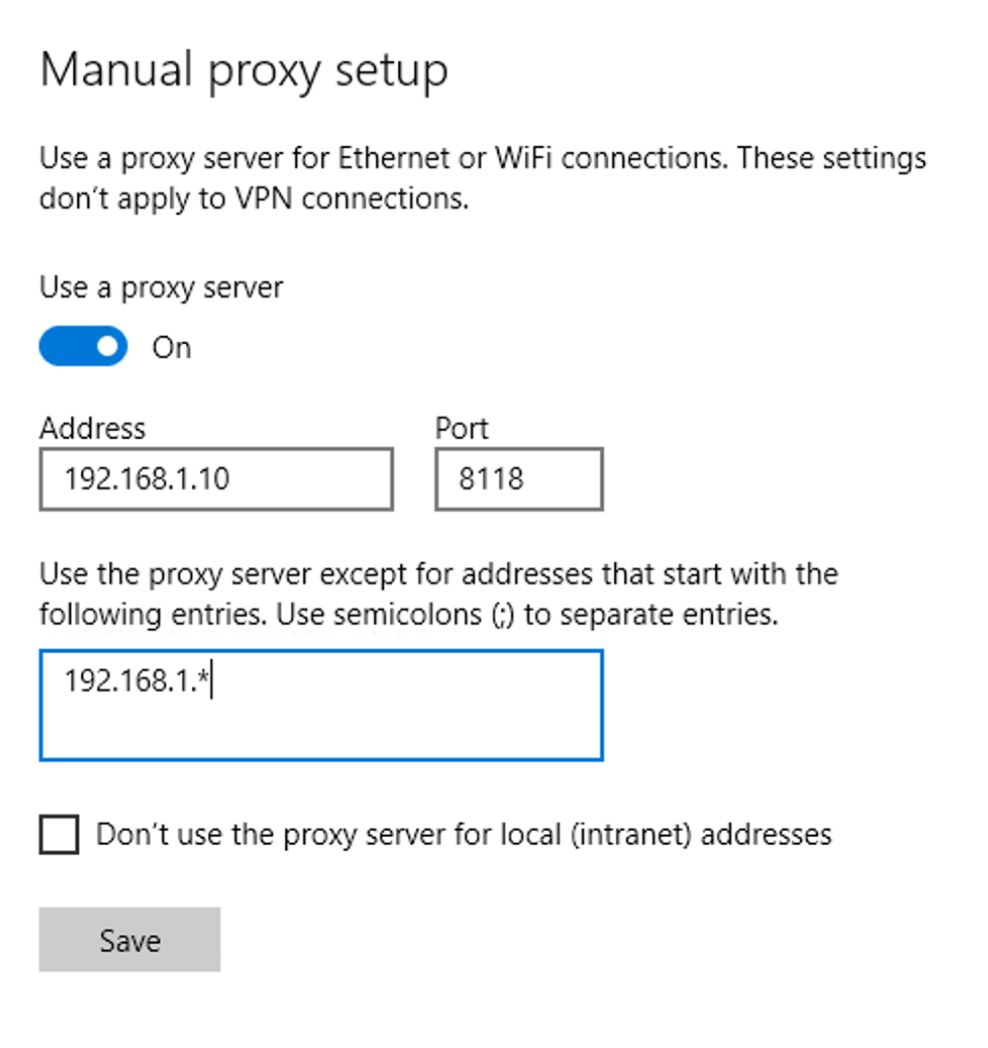

Same as well. Unable to access WebUI. Absolutely no changes. Haven't tried to use it in about a week as it was on autopilot until now. Works fine with VPN off..... So this is yet again a problem with PIA.
Thanks for detailed message.
So basically, you are saying that WebUI should work, but that network/OS/App is somehow not allowing that?
I'm accessing webUI from intranet, (no port forward), using default bridge. Tried 4 browsers, on several different devices, to no avail. No VLANs.
One of your questions was interesting....
"3. check firewall and ensure no blocking going on especially if you recently changed your firewall config, if no go:-"
---- I have explicit rule that permits access from pc (LAN1) to UNRAID (LAN2).
---- I did one-two changes on router, around DNS resolver, DNS servers, and DNS over TLS settings; in this case however, it might be a bit odd that I can access WebUIs of all docker containers, except Deluge's....I reverted DNS server changes to old settings, and I could not access Deluge's  WebUI.
Router logs explicitly show with timestamp, when I was accessing port 8112 on UNRAID from my pc, and the connection was permitted (not blocked) by my router.
But this is interesting.....
I installed on UNRAID Firefox docker. Using that Firefox, I could access WebUI.
However, I then changed network settings in Firefox to use proxy to Deluge's address [MY IP]:8118. When in Firefox I checked "whats my IP", the expected VPN's IP address was displayed, meaning Firefox docker was using Deluge docker's VPN service. When I now tried to access Deluge's webui at port 8112, I could not do so.
I'm not sure what to make of this.
this is expected, you need to bypass proxy for local ip addresses, not sure how you do this with firefox but in chrome you go to settings search for proxy and then enter in the network range to bypass, e.g.:-
