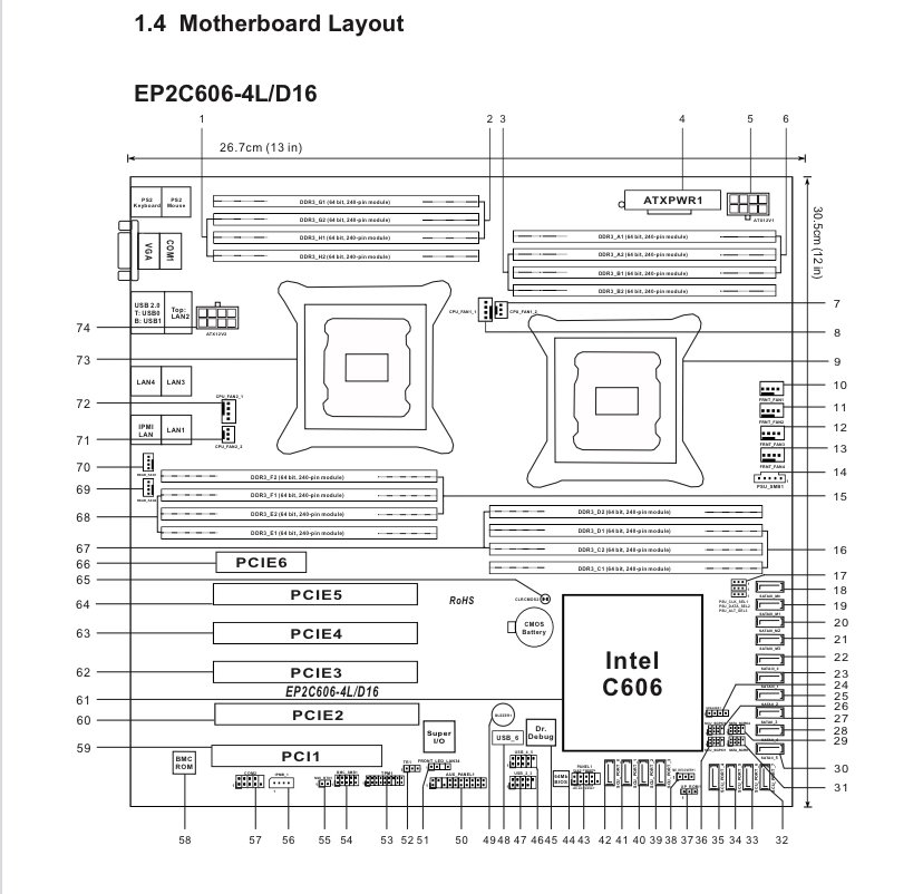

June 23, 20206 yr Community Expert Jun 23 07:10:30 Megatron kernel: mce: [Hardware Error]: Machine check events logged Jun 23 07:10:30 Megatron kernel: EDAC sbridge MC0: HANDLING MCE MEMORY ERROR Jun 23 07:10:30 Megatron kernel: EDAC sbridge MC0: CPU 0: Machine Check Event: 0 Bank 8: 8c000046000800c0 Notice the 0 Bank 8 notification. I saw some other Bank numbers also. I am no expert in this area but I believe this does tell which stick the error is on BUT you will need to do a bit of research in your MB manual or the manufacturer's website to figure out which one it is pointing to. You seem to have a lot of memory sticks in your server. This can cause problems in some cases if the MB is picky about memory. Are the sticks on the 'approved list' for this MB? Again, is this ECC memory?
June 23, 20206 yr Author I only have 4 sticks of ram (8GB each). my guess is that is CPU 0 (the one on the left) and bank 8, the bottom most below that socket.
June 23, 20206 yr Community Expert You are not doing any overclocking on CPU or memory??? (This is usually bad news with Unraid) IF you are going to replace memory, make sure to check to see if your MB is picky about memory. IF so follow the recomendations. And I would always plan to replace the pair involved-- not just one stick. Edited June 23, 20206 yr by Frank1940
