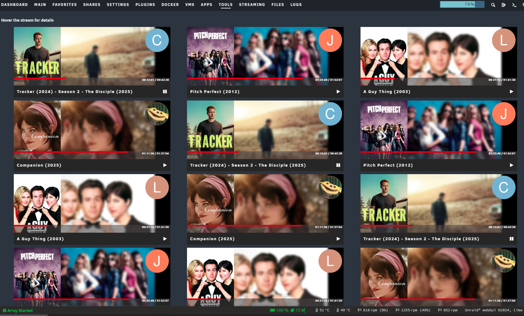

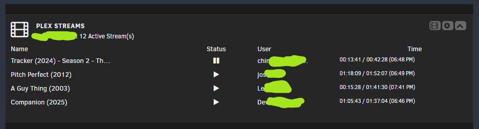

Hey just wanted to advise of an issue I'm having.
Basically the plugin counts three streams for every one real stream.
Right now I have only 4 streams going on at once but it says there are 12 and the streaming pages actually shows 12 of them.
Edited by DevanteWeary

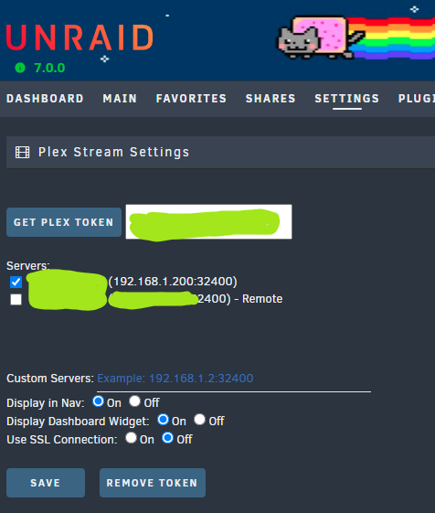

Can you show me your settings page, of course blurring out any keys
Sure thing!
