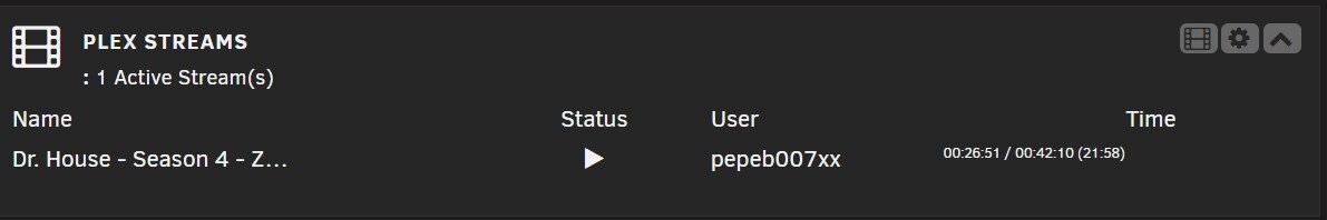

hi all, how can i change font size of timestamps pls? I want to have same size like name
