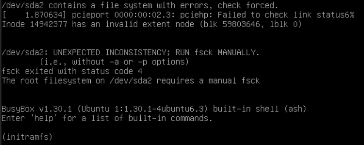

Does anyone know why my VM using 'Unassigned devices' will no longer work after the most recent 6.9.1 update?
Disk is pushed using:  /dev/disk/by-id/
The error is keeps referring to /dev/sda2, even though the unassigned disk is /dev/sdc.
Running fsck states /dev/sda2 is not existent
It's very difficult to help you with this limited information.  Please post diagnostics.
Hi See attached, Cheers
Edited by DaFr0n
That disk has errors:
Mar 10 09:07:57 unRAID unassigned.devices: Mount drive command: /sbin/mount -t vfat -o rw,auto,async,noatime,nodiratime,nodev,nosuid,iocharset=utf8,umask=000 '/dev/sdc1' '/mnt/disks/ST1000DM003-1CH162_S1DETV80-part1'
Mar 10 09:07:57 unRAID kernel: FAT-fs (sdc1): utf8 is not a recommended IO charset for FAT filesystems, filesystem will be case sensitive!
Mar 10 09:07:57 unRAID unassigned.devices: Successfully mounted '/dev/sdc1' on '/mnt/disks/ST1000DM003-1CH162_S1DETV80-part1'.
Mar 10 09:07:57 unRAID unassigned.devices: Adding disk '/dev/sdc2'...
Mar 10 09:07:57 unRAID unassigned.devices: Mount drive command: /sbin/mount -t ext4 -o rw,auto,noatime,nodiratime,async,nodev,nosuid '/dev/sdc2' '/mnt/disks/ST1000DM003-1CH162_S1DETV80-part2'
Mar 10 09:07:58 unRAID kernel: EXT4-fs (sdc2): warning: mounting fs with errors, running e2fsck is recommended
Click on the check mark when the disk is unmounted and UD will check the disk and fix the error.
Why are you using a VFAT file system for a VM?  It would be better to use BTRFS, or XFS.

Sill get the same issue:
FS: ext4
/sbin/fsck.ext4 -v -f -p /dev/sdc2 2>&1
/dev/sdc2: UNEXPECTED INCONSISTENCY; RUN fsck MANUALLY.
(i.e., without -a or -p options)
I only use this VM for Lancache, if i need to reformate due to the above error i will correct, i cant remember setting this originally.
VFAT is not a good choice.  I would reformat the disk.
Ok, will do. Cheers.
Is there anyway to pull the data first so i dont lose all the cached downloads?
Edit....
Got it sorted with:
cp -avr /mnt/disks/ST1000DM003-1CH162_S1DETV80-part2/home/david/lancache /mnt/user/LANCACHE
Once complete i will format to XFS and resetup the VM & Lancache
Cheers for the quick advise
