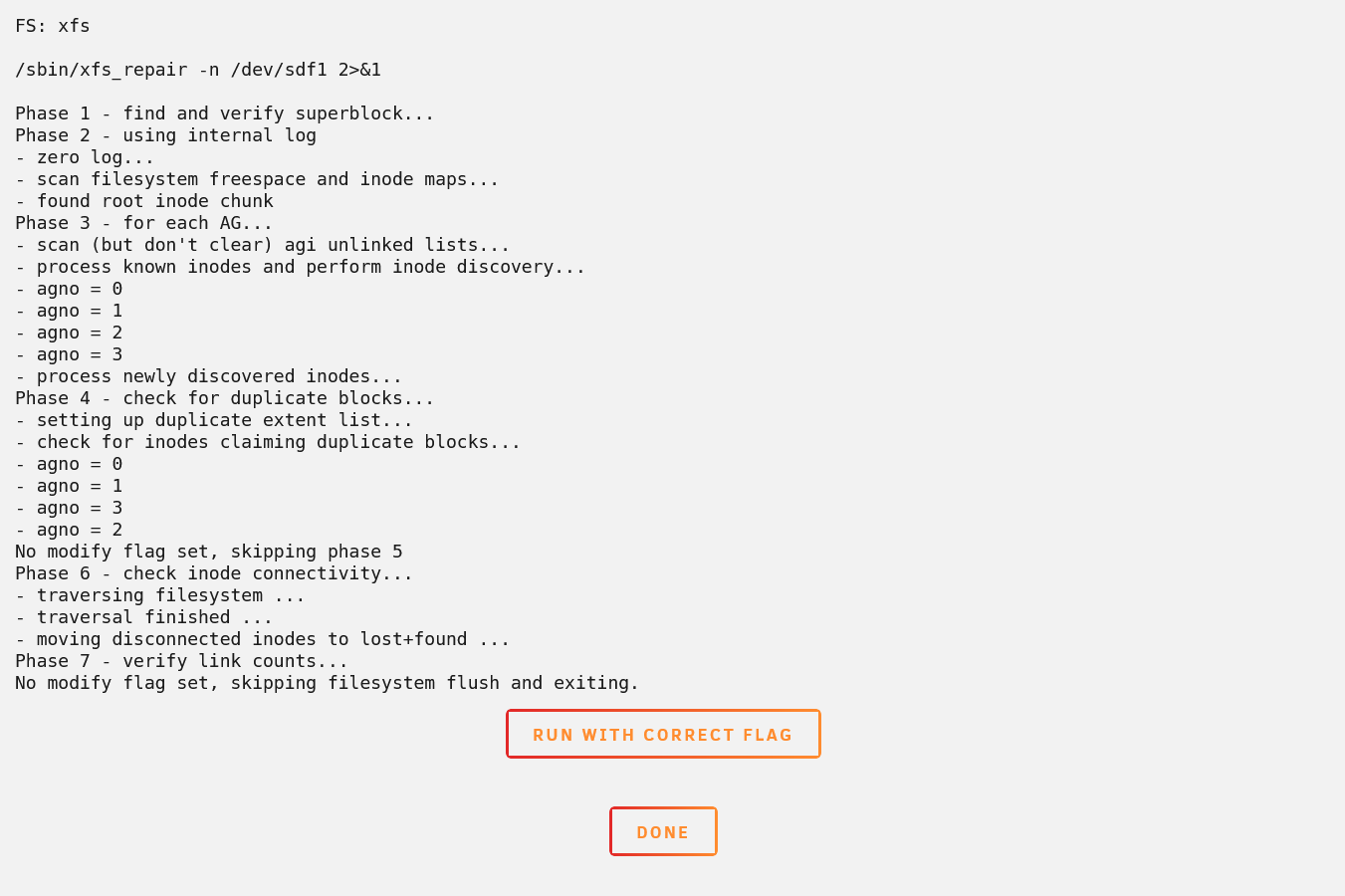

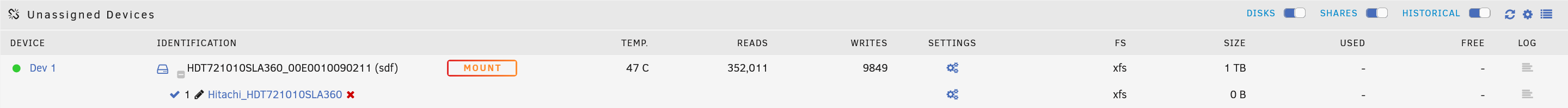

While preparing for a backup, I pre-cleared a 1Tb external USB-Harddisk  with unassigned disk plug-in
After 18hours it was finished successfully...
Now I format the disk XFS with unassigned disk plug-in - however after short time a "FAIL" pop-up window appears and the UD-log shows:
FS: xfs
/sbin/xfs_repair -n /dev/sdf1 2>&1
Phase 1 - find and verify superblock...
bad primary superblock - filesystem mkfs-in-progress bit set !!!
attempting to find secondary superblock...
It already runs for half an hour...
What to do ? just wait ....
The number of reads and writes is still growing - so there is something running in the background....
Thanks for advice
It seams, I need to be more patient...hi
As I wrote my previous post, the formatting seemed to be repaired ?!
I could also mount the USB disk now
The log shows now:
So , I believe the issue is solved and I can start the backup on this USB disk , right ?
Can someone explain to me what happened before - why the format procedere throwed the alert pop-up "FAIL" before?

Post diagnostics.
4 minutes ago, ullibelgie said:
Here is the Diagnostics file:
Your disk has a problem:

I wouldn't use the disk until you sort this out.
