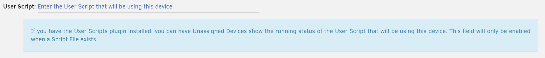

what does the user script option do  in the Gear Settings?
i figured  it ran one of my scripts   either choosing the word "Name" or "Script
so when the drive got mounted it run that script but it never did
i ended up  copying the code in my user script and then adding it to the "ADD" spot when you do the default Script.. so that when the SSD is mounted  it will auto run the script
but was curious what the user script option does?
  • Replies 11.9k
so does that mean if the cron is running every hour say on  "move files to SSD"  that it will show up on the assigned device?  and if so where do you see it.. as i know the LOG for user scripts ...  so i totally not sure what that option is or where it displays it..  least for me its kinda confusing
as the script i have moves files to the usb SSD  every hour .. but where do you see the running status?  does it pop up a notifcation or something?
oh so it will show  RUNNING
where the Mount/Unmound Icon is for that specific UD
gotcha   i didnt know and i couldnt figure it out
thanks  i not that smart sometimes 🙂

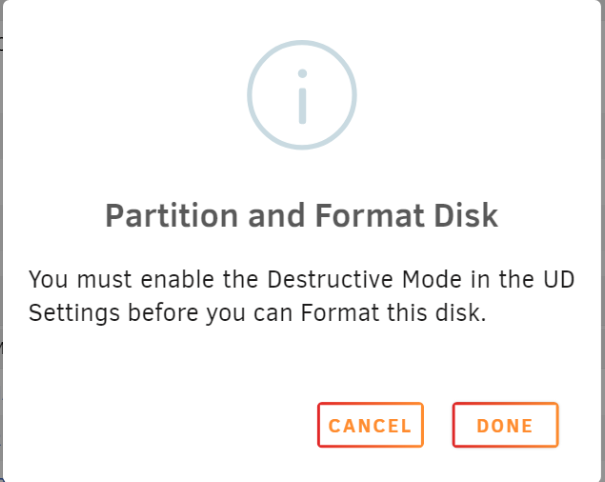

Feature Request:
Make Destructive Mode default and/or make greyed out format button more self-explaining.
This is a repeating question in the german forums as the user is not able to directly understand the reason for the greyed out button.
51 minutes ago, mgutt said:
Feature Request:
It's pretty clear in the first post in UD;
To format a disk:
  • Destructive Mode must be enabled.  You will need to install the 'Unassigned Devices Plus' plugin to enable Destructive Mode.  UD Plus will install the 'parted' package needed for formatting and deleting partitions.
  • Disk must have all partitions removed.  Unmount the disk, click on the '+' icon next to the serial number, and click on all red-X to delete partitions.
  • If the disk has been precelared and shows a grayed 'Format' button, click on the '+' icon next to the disk serial number, then click on the red-X to delete the preclear status file.
and in the Help:
To format a disk:
  • Destructive mode must be enabled.
  • Disk must have all partitions removed. Unmount disk, click on the  icon,, and click on all  icons to delete partitions.
  • If the disk has been precelared and shows a grayed 'Format' button, click on the  icon, then click on the  icon to delete the preclear status file.
I guess it's too much to ask people to read.  Because of the requirements to enable the 'Format' button, it is a challenge to let users know there is a problem.
What I might look into is enabling the 'Format' button and then telling them what they need to do to format a disk if it's not already been done.
A user and for sure a German user, does not read in the (English) forums while using Unraid.
It's hard to read an English help text, if you a) don't speak English and b) don't know how to display it.
I don't really understand why typing the word "yes" isn't challenging enough, but this is your design decision. I think an user-interface should be self-explaining.
P.S the same is valid for the +-button. The question regarding "missing partitions" is recurring as well.
I propose to collapse it by default (changeable through the settings) and to solve the format button issue: Link it with the UD settings page as follows:
http://tower/Settings/UnassignedDevicesSettings#:~:text=Destructive%20Mode
Browsers have a page translation capability.
The Help text is translated:
Zum Formatieren eines Datenträgers:
  • Muss der Partitionierungs Modus aktiviert werden.
  • Alle Partitionen müssen vom Datetnräger gelöscht sein. Datenträger auswerfen, auf die Seriennummer klicken und auf alle  Symbole klicken um die Partitionen zu löschen.
  • Wenn der Datenträger Precleared wurde und einen grauen 'Formatieren' Knopf anzeigt, auf das  Symbol klicken, danach auf  Symbol klicken um die Preclear-Status-Datei zu löschen.
As far as displaying the Help text, that's really something they need to learn for Unraid in general as it applies everywhere.
Sorry, what I meant is for UD to check all the conditions and make it clear to the user what needs to be done.
I'm working on a solution that will display a dialog when then a user clicks the format button and a format can't be done.
I agree, but a user has to take some responsibility to read and understand how a plugin works, especially UD with all it's capability.
The reason for the destructive mode is to be sure users don't make a mistake and accidently delete data.  We'd never hear the end of that if it was too easy to delete data.
Defaulting this enabled is not in the best interest of all users.  There is a Tool Tip shown when a user hovers their mouse over the '+'.  It looks like it has not been translated.  I'll look into why it hasn't.
The users don't understand that they needed to click on the button at all. I don't think the tool tip solves this. Maybe the first mount button is renamed to "partitions" and this collapse the partitions, so you could remove the + button at all?!
This is an issue for the first time users.  Once they understand how it works, it shouldn't be an issue.  This has been this way for a very long time and the old timers are used to it.  I'm reluctant to make that kind of change.  It will be confusing to the old timers.
Probably the best solution is to set the show partitions to default 'On' when a new disk is installed.  They can then set the 'Show Partitions' 'Off' to not show the partitions.  This will help the new users, and old timers can just set it to 'Off' if they don't want to see the partitions.
Edited by dlandon
+1
I read through the German post about UD and think I owe you an explanation on why I have decided to do things differently than your suggestion.  You commented that I was not receptive to your ideas.  I am, but I have to consider all users and not just a few and the technical considerations.  It is not a good idea to make changes just to accommodate a small group of users, at the expense of others.
The following are the reasons your idea would be difficult:
  • The '+' button shows partitions so you can manage them.
    • Rename mount point by clicking on the existing mount point.
    • The mount point becomes a browsing link when the partition is mounted.
    • You can unmount/auto mount each partition individually.
    • If the 'Mount' button was turned into a 'Partitions' button to show the partitions, how do you unmount the disk?
    • If the '+ button is removed, the above functionality would be lost.
I've made a change so the partitions are shown when a new disk is installed.  It can then be turned off if desired by changing the device Settings.  This gets you what you are looking for and does not cause issues with existing users.
As for the 'Format' button not being enabled:
  • The Destructive Mode was implemented so users don't accidentally format a disk.  Accidental data loss would be an issue.
  • Formatting a disk with UD requires a partitioning package that is installed with UD plus.  Why install a package that is not required for all users and used only infrequently?
  • There is a confirmation when formatting a disk.  You have to enter 'Yes' to confirm the format.
I have changed the 'Format' button to be enabled at all times and the following dialog shows if the Destructive Mode is not enabled:
I think this is the best solution all things being considered.
Before you consider me un-cooperative or dismissive, please take the time to understand my reasoning behind the decisions.  I realize you feel that your ideas are the best, but I need to consider all aspects of any changes:
  • How does it affect other users?
  • Backwards compatibility?
  • Is it in line with LT direction?  Yes, I do coordinate closely with LT with any changes to UD.
  • Minimize data loss.
  • Consider any security issues.
New release of UD.  Notable changes:
  • No one has reported it yet, but I have found that my Windows 10 share would not mount.  The issue seems to be related to IPv6.  The suggested solution is to turn off IPv6 on the Unraid server.  I didn't feel that this was a good answer and implemented a fix so the Windows 10 share mounts using IPv4.  Existing Windows shares will work as they are.
  • The 'Format' button is enabled at all times and if Destructive Mode is not enabled, a dialog will remind the user to enable Destructive Mode.  There has been confusion as to why the 'Format' button is grayed out.
  • Because of some confusion about partitions on disk devices, the 'Show Partitions' switch will now default to enabled on new devices.  This will show all partitions.  You may see this on disks where it did not act this way before.  Just go to the device Settings and turn off the 'Show Partitions' switch.
My suggestion didn't reflect my personal needs, it was a feedback as moderator of the German sub forums. If it was only a small group I wouldn't have posted it.
I wasn't able to test it, but regarding your changelog I think you covered the problems with the new version perfectly. We will see in the next days if some long-time users don't like it 😅
Next step is to get more attention for this feature request as it is another thing which happens frequently to new users.
