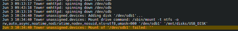

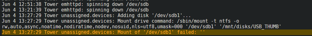

CAN'T MOUNT NTFS THUMB DRIVE/EXTERNAL HARD DRIVES USING UNASSIGNED DEVICES
I have had little to no issues with Unassigned Devices in the past, but am getting errors attempting to mount usb devices which are NTFS formatted.
Any assistance would be appreciated.
Post diagnostics.

It didn't mount.  This is off the wall, but change the 'USB_DISK' mount point to another name.  Also, try the disk in another computer to see if it mounts.
Why are you mounting a USB stick with ntfs?  Reformat it to vfat.  Windows will able to read it.
I am mounting NFS with the thumb drive to test mounting external disks which are multi-terabyte drives.  Once i am able to mount this this thumb drive I should be able to mount the external drives which contain data to load onto the array.  The thumb drive mounts with no issue on all other windows computers in my environment.  I tried changing the mount name to USB_THUMB and it still will not mount.
I tried unplugging and replugging in as well, no joy.
Let me see if I can reproduce the issue.
