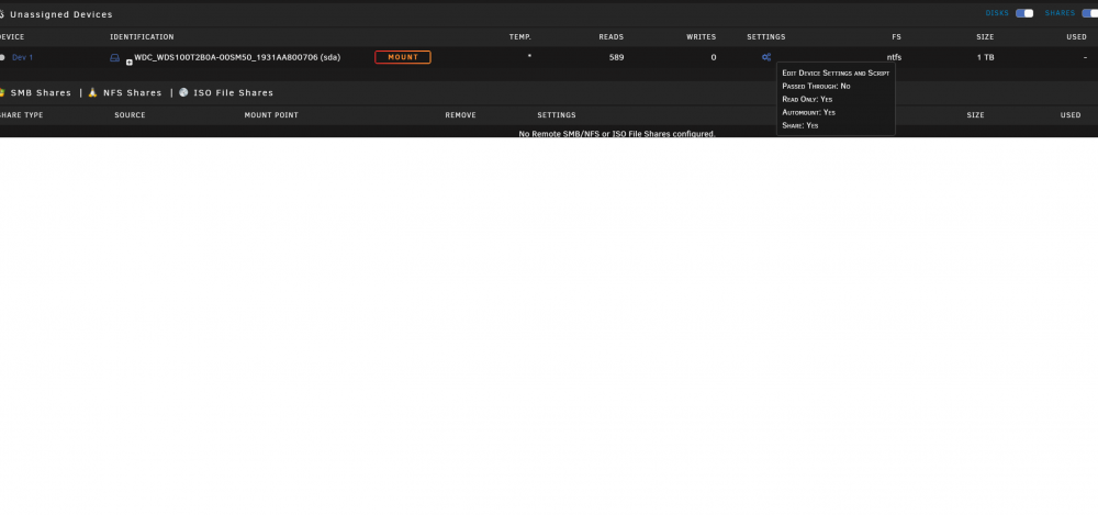

how do you disable  Automount , Auto Share  of unassigned devices???
no matter what you change in the Gear Setting,  if you toggle on off Auto Share Auto mount
it still tells you YES  when you hover the mouse  over the gear..      if i do the Pass Through  that works Toggling Yes to No or No to Yes
but seems to be a bug  that no matter what you do Auto mount Auto Share  stays on YES even when i set to no
is there something i can do
I'm not seeing it.  Have you updated to the latest version of UD?
all plugins and dockers update every night
running 2021.06.11

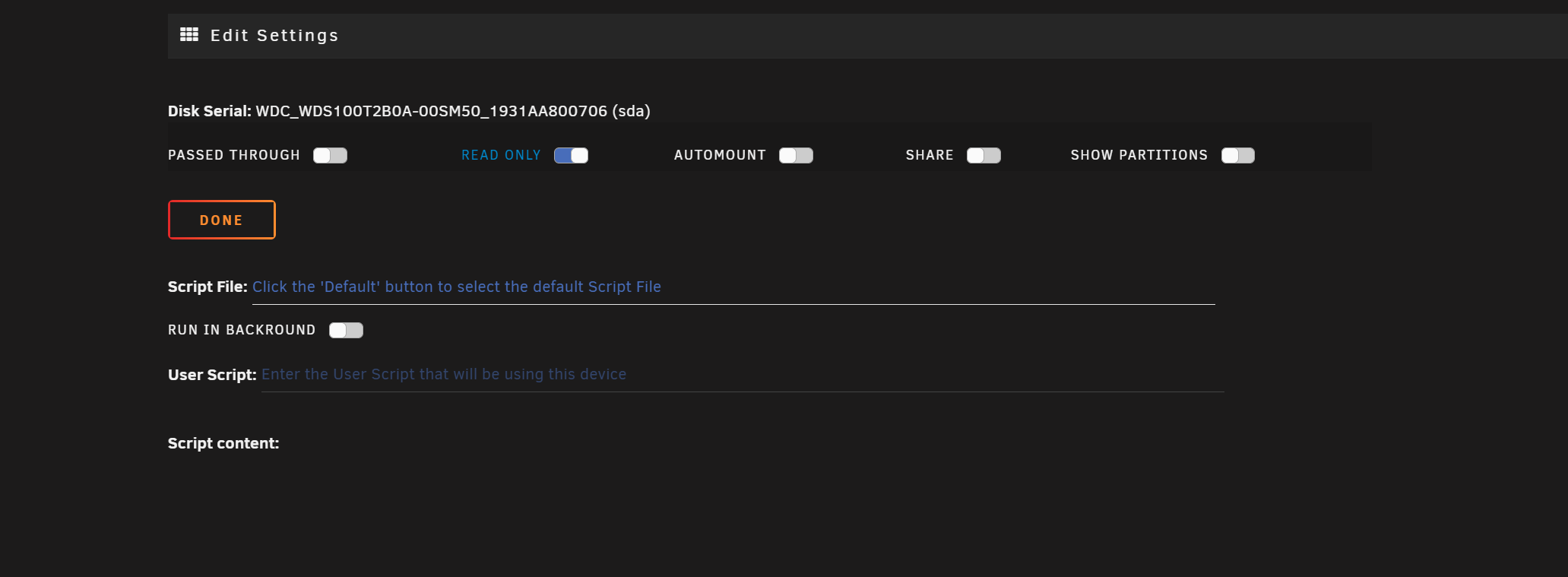

you can see i set the Read Only on   but the other 2 are on when should be off
i even did the default script that doesnt help either
running 2021.06.11
I suspect you have a corruption in the config file.  The disk appears to be a USB disk.  Unplug it and you will then see it in the Historical devices.  Delete it in the historical devices and then plug it back in and see if it fixes the switches.

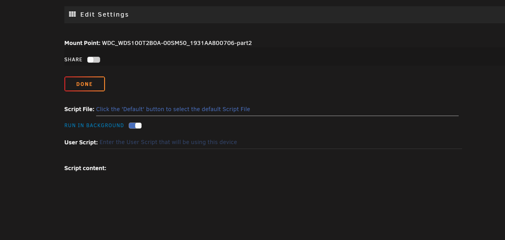

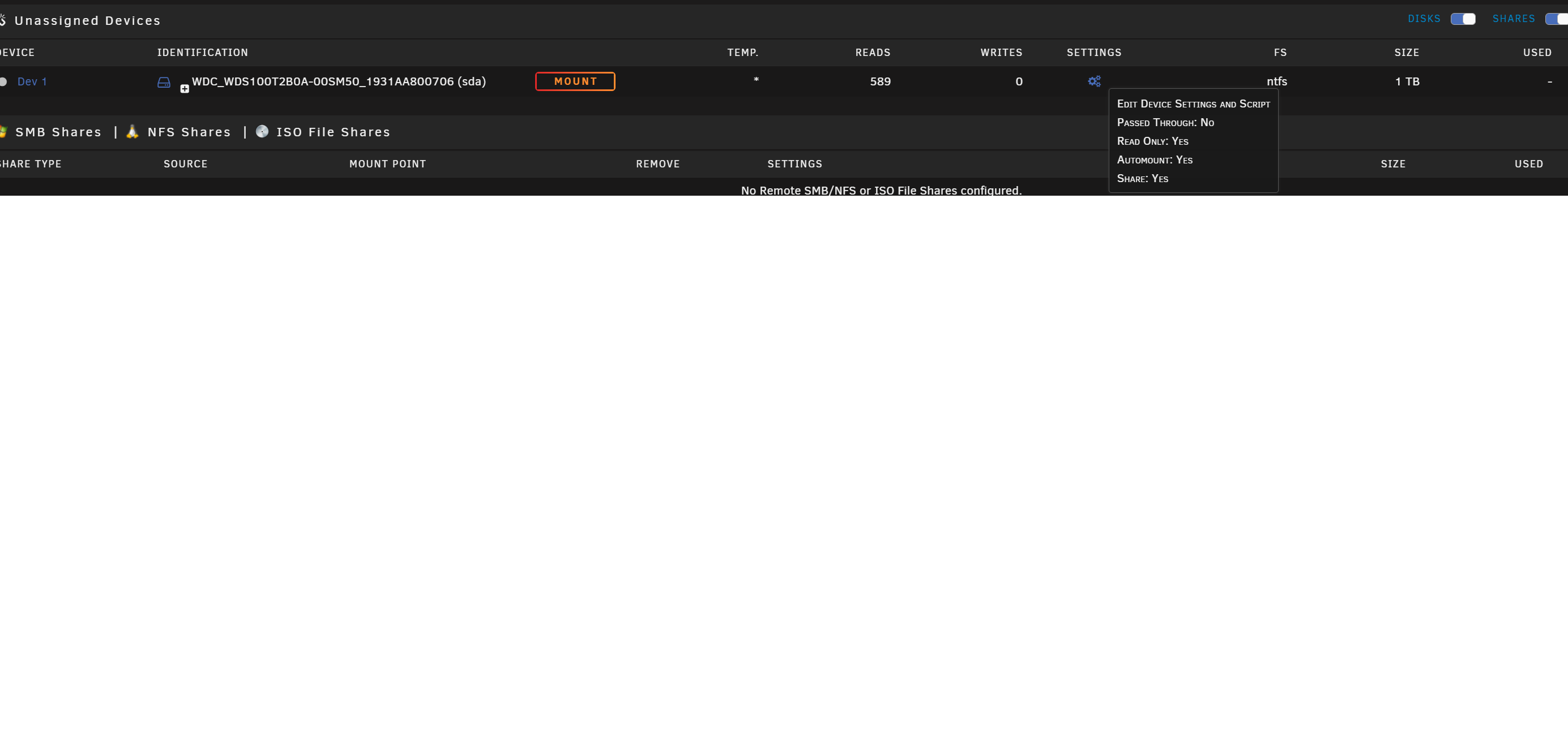

didnt work
so i shut off the usb drive. deleted the historical file..  before that i looked in it..  only thing that was set was Read Only
but i deleted it.   turned on my usb enclosure..  and both still set to yes  Auto Mount Auto Share..
it still shows when you Hover over the Gear those 2 are YES..  but when you actually click the gear
everything is toggled OFF
Edited by comet424
its a windows disk  so i dunno if that matters?..   i did check each gear   if you mouse over its YES
but if you actually click each gear its OFF

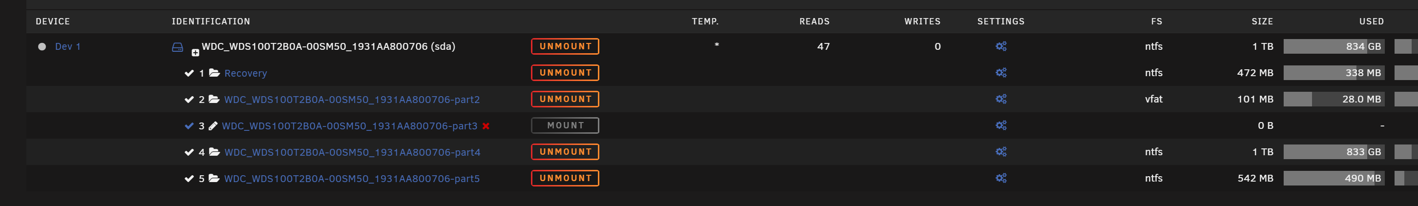

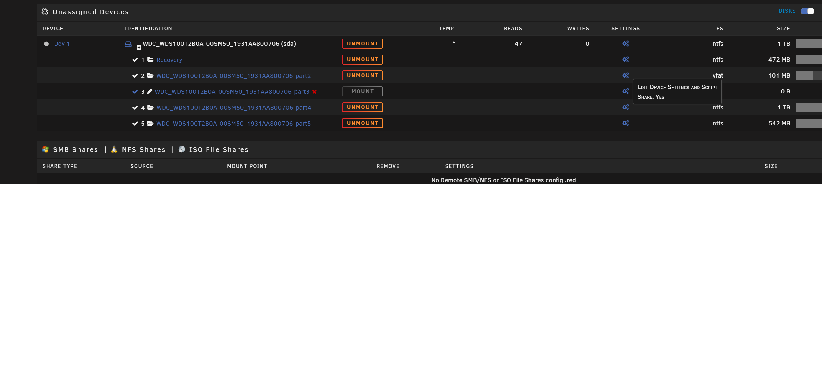

Your disks have 5 partitions on them.  That might be the issue.  I'll have to try to reproduce that situation.
ah ok ya its like Windows Install and it created the partitions that way for windows 10 install.
but ya  i even tried a reboot of unraid didnt help  still automounts and still auto shares
even when you double check  shares are off for each partition  and you do a reboot of unraid.. i figured maybe thats the issue  and rebooted but it didnt help either..
i figured maybe its a Windows 10 thing that causes it

Post your diagnostics.
Just found it. There is a setting in UD to automount USB devices automatically regardless of the the device "Automount".  Go to the UD settings and set 'Auto Mount USB Devices?' to 'No' and the devices won't be automounted.
Edited by dlandon
@dlandon ok thanks that fixed it..  I didnt even notice there were settings .. i just thought it was a plugin like the some others... there are no settings to change its just a plugin and you just accept it..
but it works  thats great as i thought i was going crazy..  least its work  to not share
