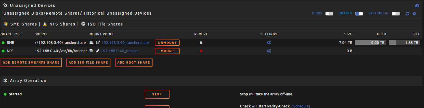

Can't mount NFS since upgrade to 7.0. Finds it fine, just wont mount it.
Aug  2 22:08:38 TheLibrary unassigned.devices: Mounting Remote Share '192.168.0.40:/var/lib/rancher'...
Aug  2 22:08:38 TheLibrary unassigned.devices: Mount NFS command: /sbin/mount -t 'nfs' -o rw,soft,relatime,retrans=4,timeo=300 '192.168.0.40:/var/lib/rancher' '/mnt/remotes/192.168.0.40_rancher'
Aug  2 22:08:38 TheLibrary unassigned.devices: NFS mount failed: 'mount.nfs: mounting 192.168.0.40:/var/lib/rancher failed, reason given by server: No such file or directory'.
Aug  2 22:08:38 TheLibrary unassigned.devices: Remote Share '192.168.0.40:/var/lib/rancher' failed to mount.
thelibrary-diagnostics-20240802-2209.zip
Edited by DuzAwe

The remote mount seems odd: /var/lib/rancher.  Check that the directory is a correct mount point and it is exported properly.
It was mounted a few days ago. Had been mounted since the last time I posted about an issue. So a few months.
The same path mounts with samba.

Verify it is exported with NFS.  Check the exports file.
/var/lib/rancher        *(rw,async,no_subtree_check,anongid=100,anonuid=99,no_root_squash)
#/var/lib/rancher        192.168.0.0/24(rw,no_root_squash,subtree_check,fsid=0)
root@PiBox:~# exportfs -rav
exporting *:/mnt/dietpi_userdata
exporting *:/var/lib/rancher
Samba mounts no issues. NFS has stopped working, It was working according to my logs at 11am on the 2nd and stopped by 6pm.
Try adding fsid to the uncommented line.
 Done! Still no change. I can list and see the mount available but it won't mount. Via CLI or the plugin.
Aug  3 15:50:27 TheLibrary unassigned.devices: Mounting Remote Share '192.168.0.40:/var/lib/rancher'...
Aug  3 15:50:27 TheLibrary unassigned.devices: Mount NFS command: /sbin/mount -t 'nfs' -o rw,soft,relatime,retrans=4,timeo=300 '192.168.0.40:/var/lib/rancher' '/mnt/remotes/192.168.0.40_rancher'
Aug  3 15:50:27 TheLibrary unassigned.devices: NFS mount failed: 'mount.nfs: mounting 192.168.0.40:/var/lib/rancher failed, reason given by server: No such file or directory'.
Aug  3 15:50:27 TheLibrary unassigned.devices: Remote Share '192.168.0.40:/var/lib/rancher' failed to mount.

You said everything was working fine, and then it didn't.  What changed?  An update somewhere?
Maybe check permissions on the remote server?
There were no changes to the remote around the time it stopped mounting. Last package update was a few weeks ago.
The only change is Unraid 6.12 -> 7
The error you are experiencing is because the remote server is reporting the directory does not exist.
I would try removing the remote mount from UD and then recreating it.  I guess there is a remote possibility the configuration entry got corrupted.
