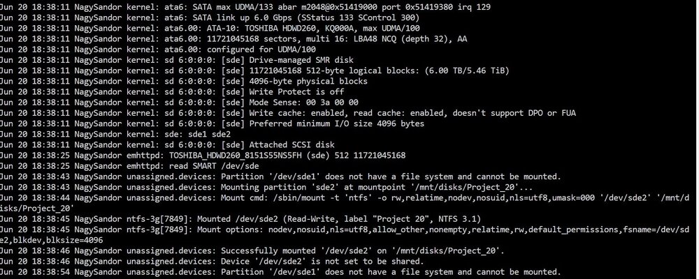

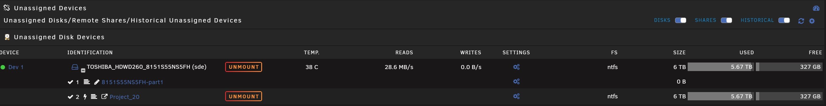

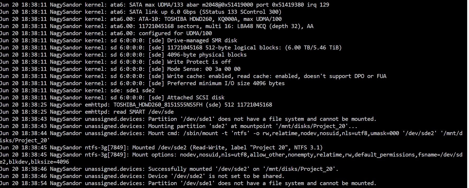

On 6/20/2024 at 7:53 PM, sp4rk said:
Hi!
I have a 6TB NTFS drive formatted on Windows full of data. I wanted to copy the contents to my array through USB by using a SATA dock, but it did not mount. Logs attached.
I have attached the drive directly to the motherboard with SATA cable, and it mounts fine now!
So the dock seems to be the problem. I have tried two completely different SATA to USB solutions without luck. I would prefer to use a dock so i can attach drives more easily, is there a way to make it work?
Thanks for any input!

I have updated Unassigned Devices plugin, and now my NTFS SATA HDD mounts through USB dock!

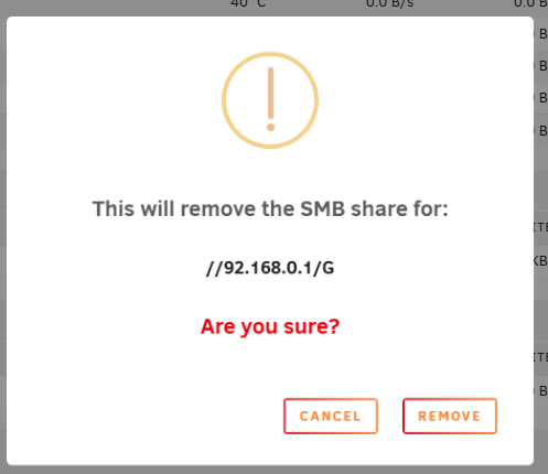

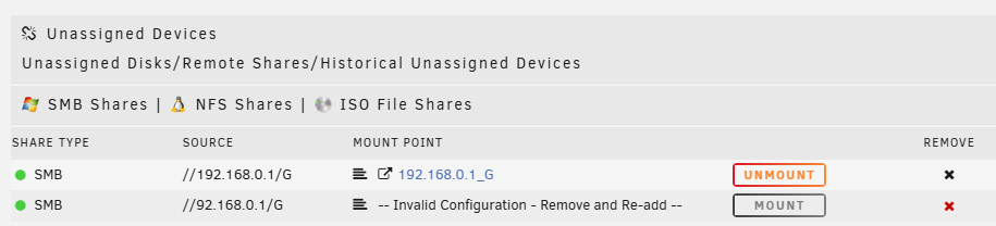

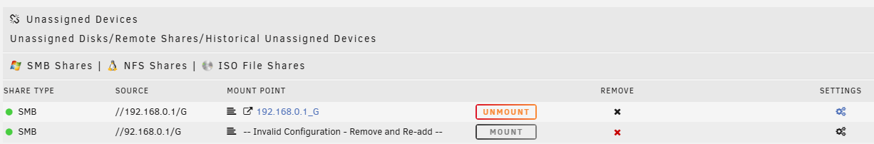

I remove and it say success, but nothing success!!
