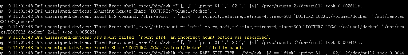

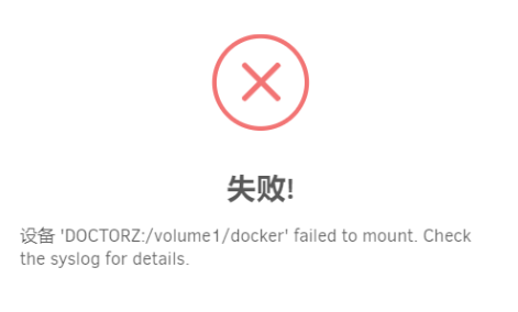

Hi, I'm a newbie and I just started playing with unraid. I use unraid as the underlying system and then run Synology in a virtual machine. Synology uses NFS to share folders, and unraid can add them, but I can't mount them on unraid anyway. Is there something wrong with my settings?
image.png.68547199f05b4ef3884edb6437f2db13.pngimage.thumb.png.8bd38c3e86764bee5d531cfe0a17336c.png
Do the following:
  • Go to Settings->Unassigned Devices and set the "Debug Log Level" to "None".  The UD debug will flood the log.
  • Go to Settings->Unassigned Devices and set the "NFS Version to use when Mounting Remote Shares" to "Auto".

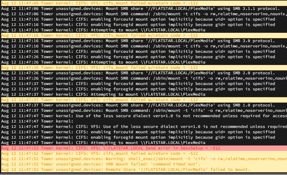

Am I understanding these logs correctly that the 112 is due to a protocol mismatch, and unraid steps down to samba 1.0, and then actually gets a 512 error on samba 1.0? Whats a 512?
image.png.a4f4029e08301ebd1592508b28fb3621.pngimage.png.4c7db7210f81947ff996aab7c7ed822d.png
UD polls the remote server to determine which protocol the server supports.  The -112 means the remote server connection failed for network reasons.  It doesn't seem to be a protocol issue.
Whats a 512?
The mount command timed out:
Aug  7 10:02:49 Tower kernel: CIFS: VFS: cifs_mount failed w/return code = -512
Aug  7 10:02:49 Tower unassigned.devices: Warning: shell_exec(/sbin/mount -t 'cifs' -o rw,relatime,noserverino,nounix,iocharset=utf8,file_mode=0777,dir_mode=0777,uid=99,gid=100,vers=1.0,credentials='/tmp/unassigned.devices/credentials_FLATSTAR_PlexMedia' '//FLATSTAR.LOCAL/PlexMedia' '/mnt/remotes/FLATSTAR_PlexMedia' 2>&1) took longer than 15s!
Aug  7 10:02:49 Tower unassigned.devices: SMB mount failed: 'command timed out'.
Aug  7 10:02:49 Tower unassigned.devices: Remote Share '//FLATSTAR.LOCAL/PlexMedia' failed to mount.
SMB 1.0 may not be supported on your drobo server.
Try this:
Go to Settings->SMB and enable NetBIOS.
It shouldn't be needed unless Unraid is acting as a SMB v1.0 server.

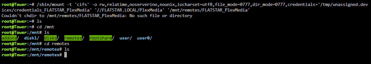

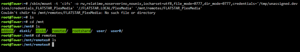

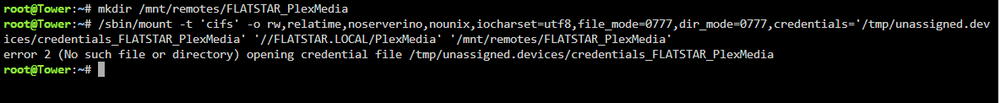

2 minutes ago, root1657 said:
Run this command first:
mkdir /mnt/remotes/FLATSTAR_PlexMedia

Tried mounting with the new procedure (image attached), no joy. Tried adding a new mount, and it cant see any shares (I swear the credentials are correct and working on every other device, and they haven't changed, the problem is in unraid or the plugin somewhere, lets not blame the smb server again...)
I have made peace with the fact that unassigned devices is no longer capable of mounting SMB. I'm just going to have to engineer another array and let the windows workstation handle the migration.
