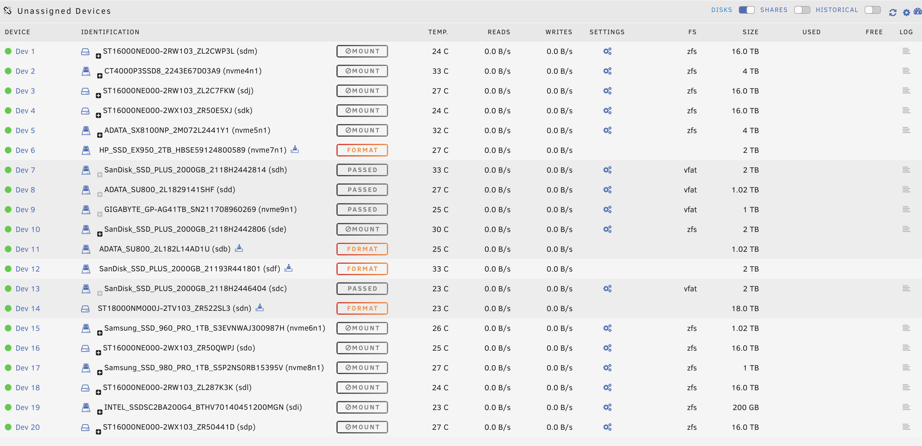

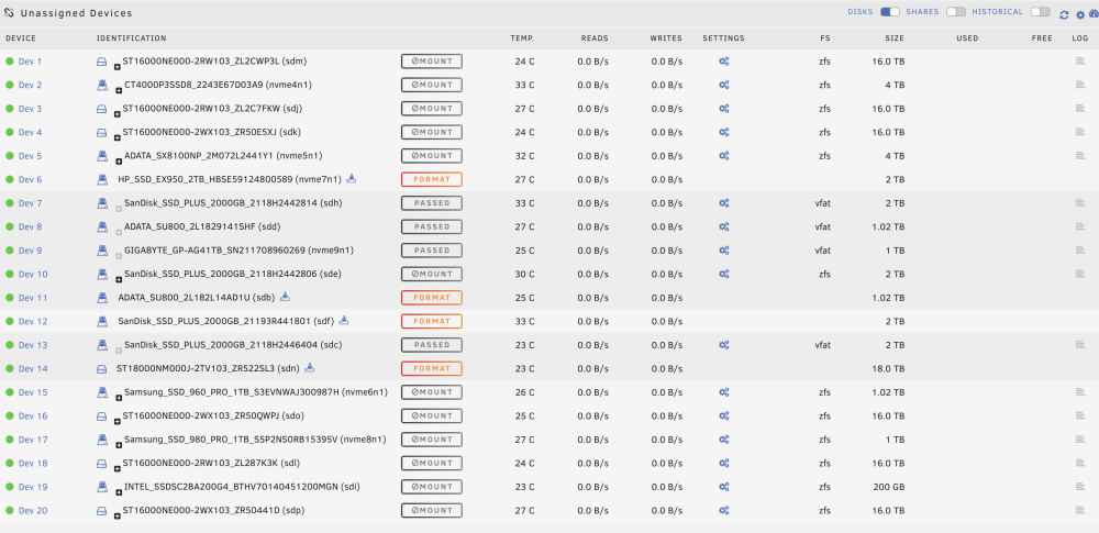

Would it be possible to add a feature so one can hide certain disks from being shown in the UD list?  The majority of the disks listed in my UD are in ZFS pools and I'd like to hide those disks so the UD list isn't so cluttered. It's hard to find particular disks as the list is so jumbled and Linux has a bad habit of rearranging the list every boot.
The issue with hiding the disks is the ability to un-hide them.  How could one do that?  If they are hidden from UD, how do you access the disk to un-hide it?
You have several options:
  • Turn on the "Disable Mount Button" and the mount buttons will be disabled.
  • Set an alias disk name that will sort and move them in your list of UD devices to make it easier to understand.  Start all your alias disk names with "Z" and they will show up at the bottom of the UD list.  Maybe do something line "Zpool1", "Zpool2", etc.
  • Turn on the  "Passed Through" switch so the mount button will show "Passed" and UD will not allow operations on the disks.
  • Wait for 6.12 with native ZFS support and your disk pools will not be shown as UD disks.
There could be an option in UD's config that could list all hidden disks. Or maybe a better option would be to show hidden disks in the Historical section since you can already hide that section.
I already have disabled mounting of ZFS disks but the disk list is so scrambled with non ZFS disk spread all over as well.
As you can see in the screenshot disks are all over the place and the order changes with every reboot.

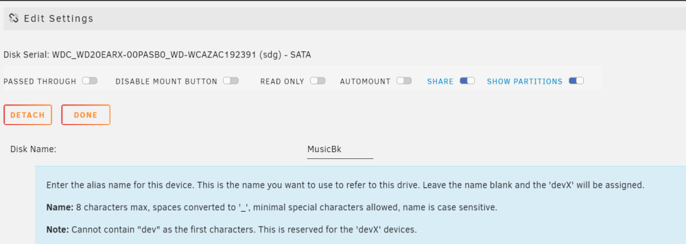

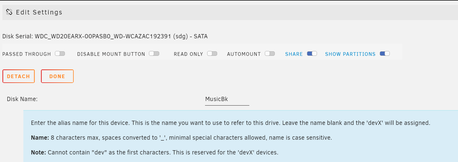

You should assign alias disk names to organize the disks.  As I suggested, name them "Zpool1", "Zpool2", etc and they will show at the bottom of the list because UD sorts the disks based on the device (alias) name.  Actual UD disks will be at the top.  A reboot will not change the alias disk names and disks will not show a different order.
I have no idea how to do that.
