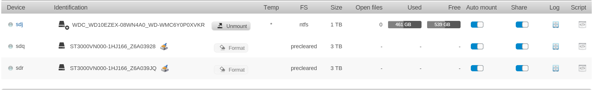

I posted about an issue I was having with keeping drives spin down a few weeks back.
https://forums.lime-technology.com/topic/44104-unassigned-devices-managing-disk-drives-outside-of-the-unraid-array/?page=54&tab=comments#comment-577816
I thought I had the problem solved, following some suggestions to use User Scripts to spin the drives down and set the spin down parameters.  This seemed to work.
However now what I've found is while the script does initially work. for some reason the two drives which ARE NOT mounted, spin down and then spin back up within 15-30 minutes.  The single drive that is mounted and shared by UD actually stays spun down and doesn't spin back up on it's own.
Does anyone have an idea how or why this would happen?  Can I enter the script lines at the device level using UD and would that help?  (see right hand side of UD window has a "script" button for each drive).

1 minute ago, TODDLT said:
 I wonder if I mount but don't share the other drives, will that allow them to stay spun down.
Probably.

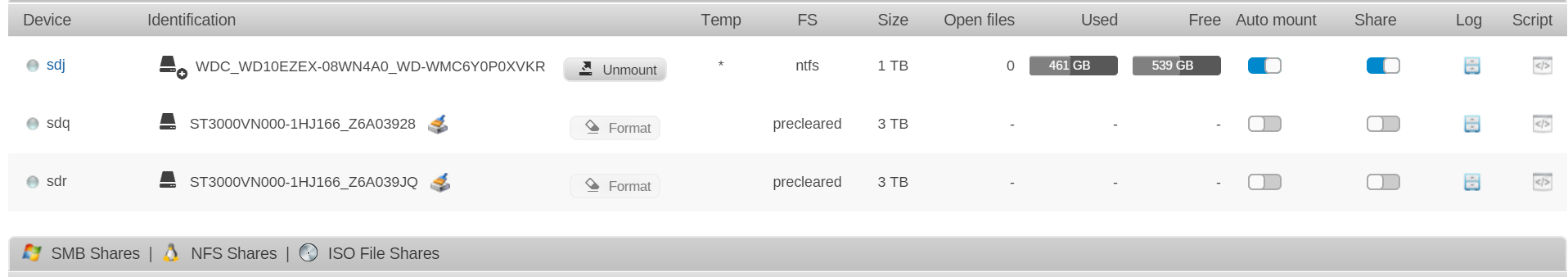

8 hours ago, TODDLT said:
It's interesting that it doesn't affect the drive UD has mounted and shared.  I wonder if I mount but don't share the other drives, will that allow them to stay spun down.
8 hours ago, dlandon said:
Probably.
OK tried that tonight but no luck.  I even clicked both the mount and share switches but they still spin back up.
The only difference is these aren't formatted.  I would format XFS for later use, but the "format" button is grayed out (see image).  How do I get to where they can be formatted and mounted?  I think the one that is currently shared was formatted on a PC NTFS, not via unRAID.
Thanks.
Thanks.
You need to actually mount the drive.  To format, be sure destructive mode is on in Settings->Unassigned Devices.  Then click on the disk name and click the X to delete the preclear file.  The format button should then be active.
 Once I turned on Destructive Mode, the format button opened up and allowed me to start the format.
The disk name would not allow me to click or open it, so I never saw a "preclear file" to delete.
It did let me format and mount both disks.  It "appears" to be working at the moment.  The first 3 times I ran the script to spin the drives down, one didn't or it did briefly and then spun right back up.   The 4th time, they both seem to have stayed spun down.  I'll keep an eye here and post again if it continues to be an issue.
Thanks for the help.

Any idea how I could figure out why my drive is showing with red Used amount on the Main page, rather than green like it has been up until now?
SMART doesn't show any errors. The log's empty. The partition is green...just the drive isn't.
Thanks.
It looks like the latest version had a "colors" fix in it. Unfortunately, now they're more confusing (now orange in both Used spots and the Free spot for the partition).
Looks good with the latest update! Thanks!
