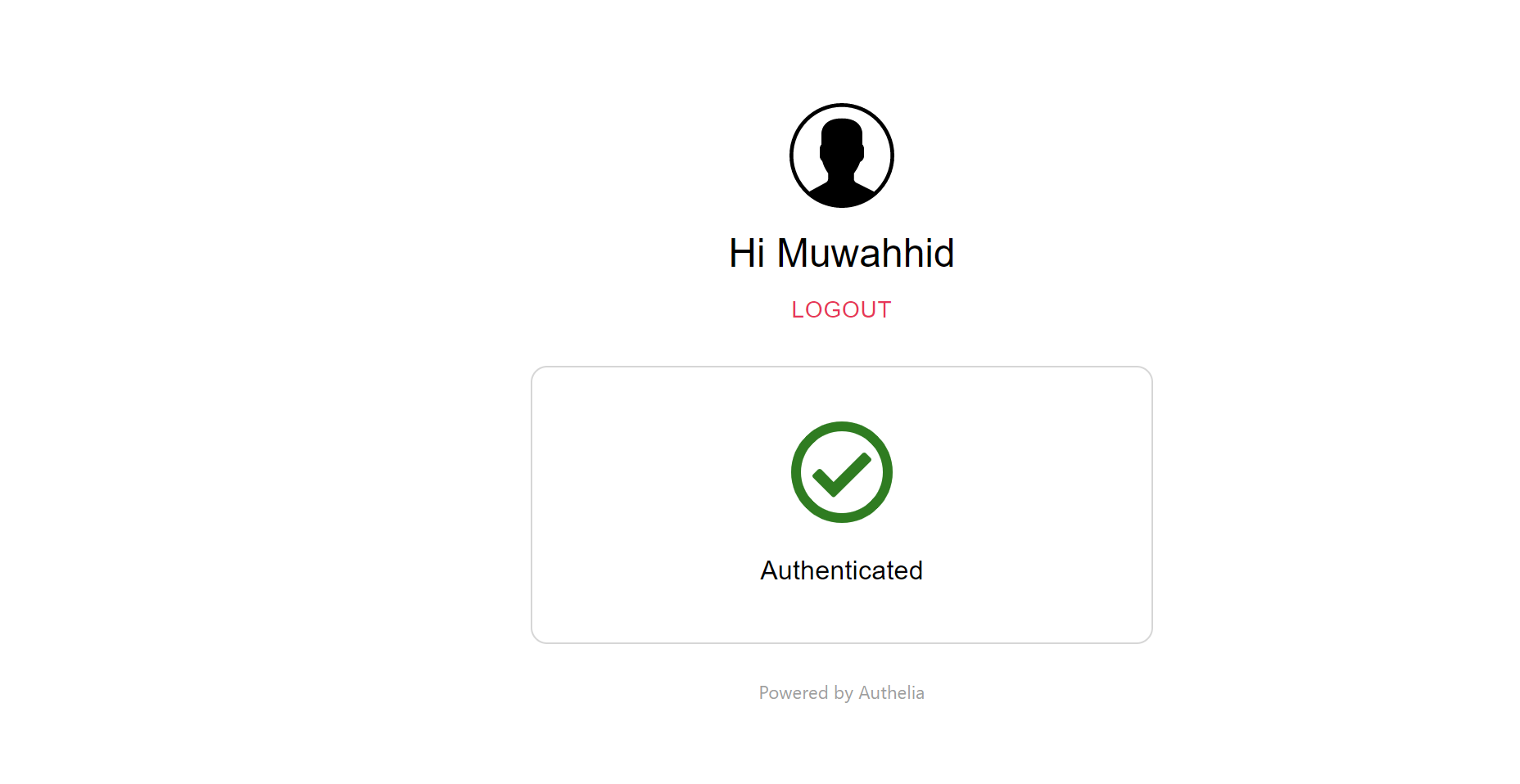

I successfully launched the container, created the user, logged in. Now I settled on the NPM configuration item.
I have MyDomain.ru (my main domain), auth.MyDomain.ru (with local ip Authelia) and radarr.MyDomain.ru (with local ip Radarr).

authentication portal.conf needs to be copied and pasted into /NPM /edit proxy Host- /Advanced (auth.MYdomain.ru)?
and protected endpoint.conf needs to be copied and pasted into /NPM /edit proxy Host / Advanced (needProtect.MyDomain.ru)?
Edited by muwahhid
@muwahhid Correct the Authentication Portal.conf goes into the advanced config for your Authelia proxy.
The Protected Endpoint goes into whichever service you want to protect. For example, Radarr or Office etc.
You must edit these files to suit you, replacing the referenced placeholders such as SERVERIP or CONTAINERNAME.
In the information you posted to Discord I can see the formatting is incorrect which (maybe) giving you issues. For example:
http://192.168.31.100:4430/;
There is a '/' at the end of your IP. A trailing slash can sometimes cause issues. In the template it looks like this:
set $upstream_CONTAINERNAME http://CONTAINERIP:CONTAINERPORT;

It’s not me who wrote the discord) But you are right, the problem I had was in "/". Thanks for the clarification. If you do not mind, I will still write if questions arise. I'm starting to customize Authelia and all my web applications.
