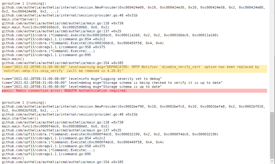

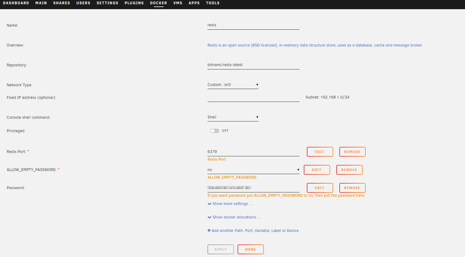

EDIT: I found the issue. Do not use a password that starts with an "!". I changed my password to something without a special character at the beginning and BOOM, fired right up.
Cant get Authelia to start, getting the following error: (Did not set up SMTP since this is only testing)
Redis configuration:
configuration.yml:
Verified IP, Port, and password match
Has anyone had this issue?
configuration.yml:
Glad to hear it
