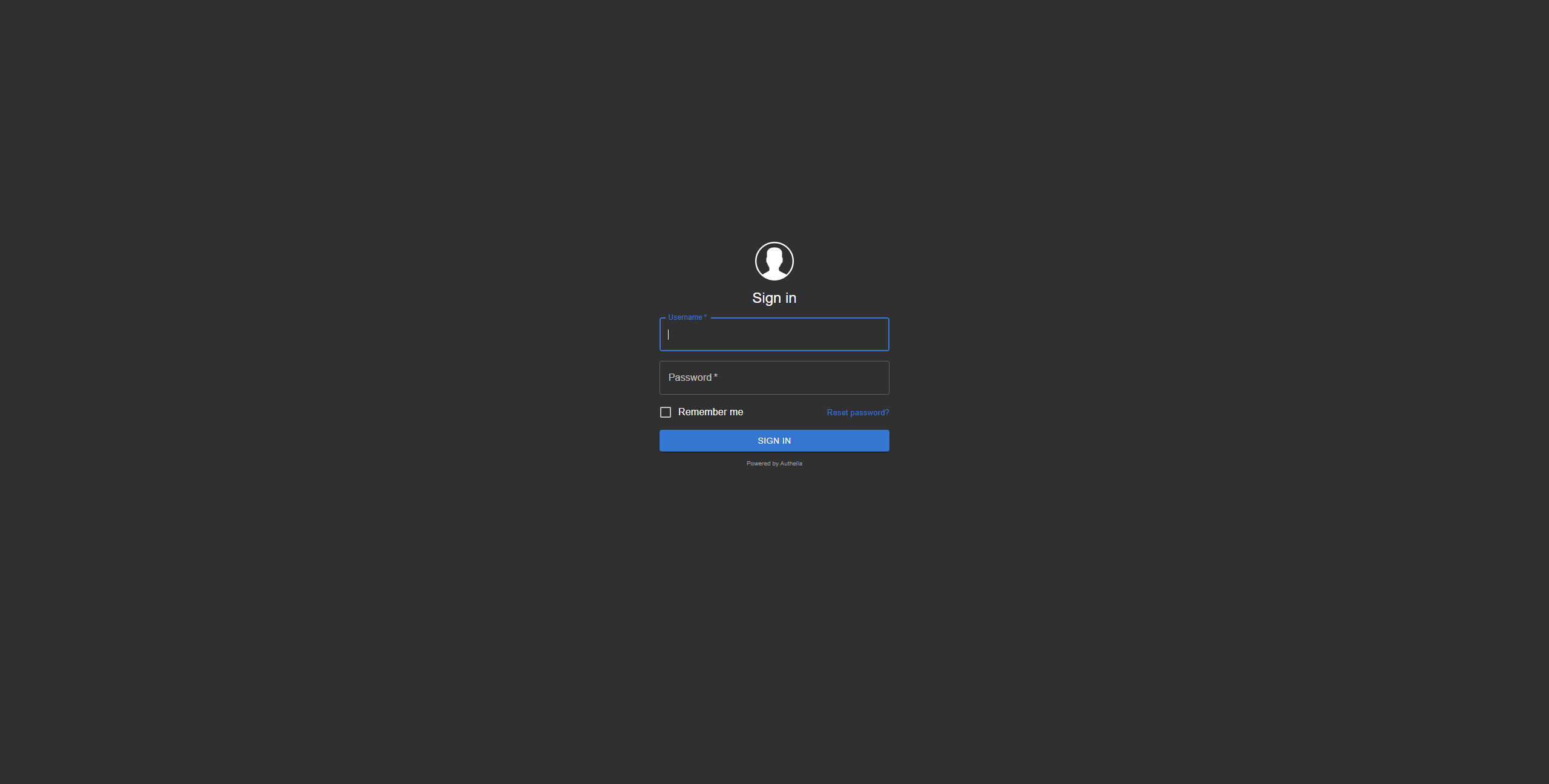

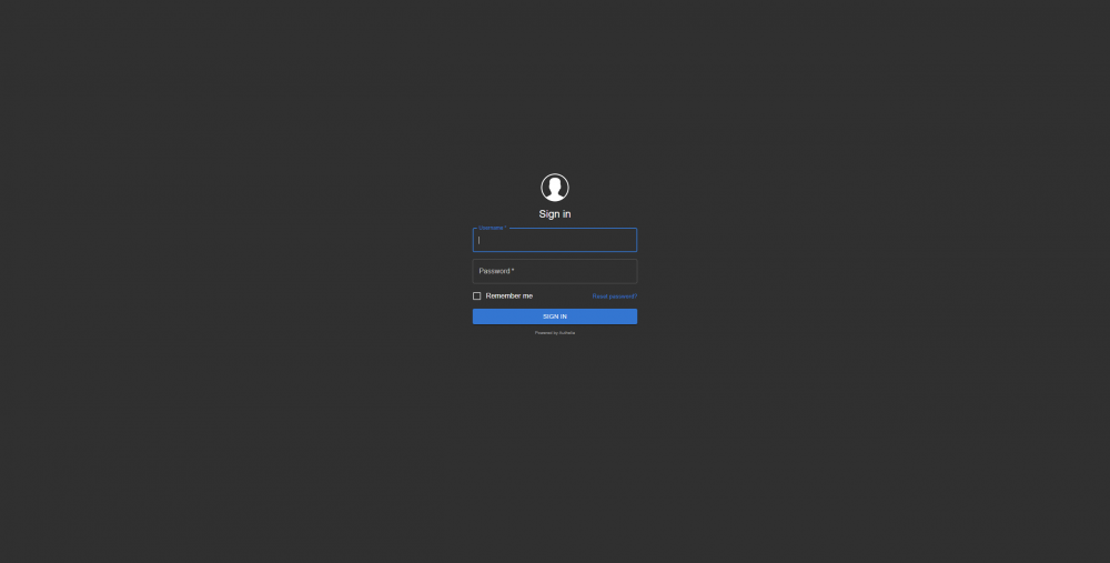

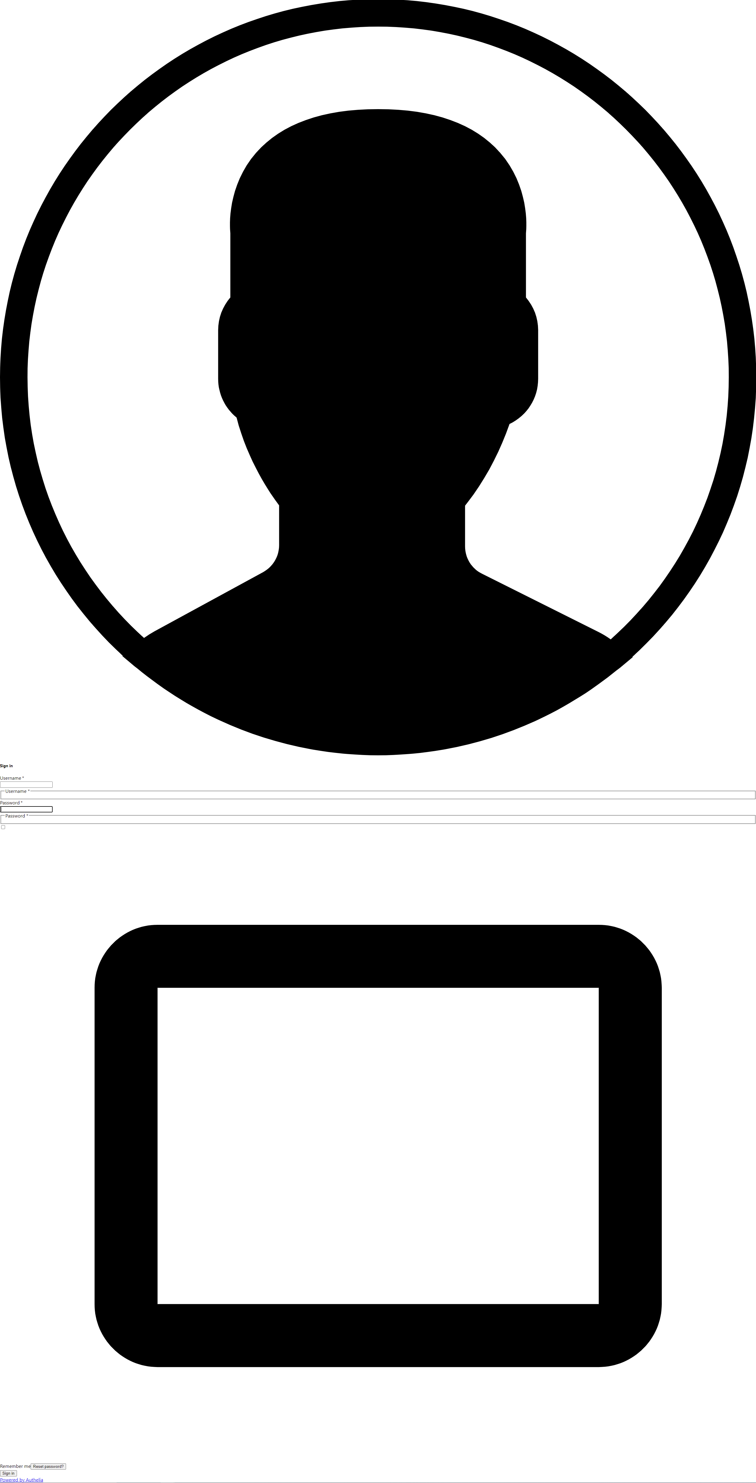

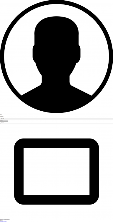

I am using Authelia together with Nginx Proxy Manager. Both are installed with Docker containers on the same host. I have got the setup working with most of my services, but for some reason when trying to get it to work with VSCode (using linuxserver/code-server) I only get a white/blank screen after login. Anyone have any tip as to what might be wrong? I am using the same endpoint configuration for all the services just changing out the address and port number. I have no trouble with VSCode when not behind Authelia.
First off, thank you @Sycotix for your Authelia CA container as well as your video series on YouTube. Very helpful and detailed!
I've set up Authelia using a combination of your video and this blog post by Linuxserver. I mostly followed your video except for the end where I used SWAG instead of NPM.
I've tested Authelia by protecting two endpoints: Syncthing and Tautulli.
A few questions:
1) When I go to https://syncthing.mydomain.com, I get a distorted Authelia login page (please see attached images), whereas when I go to https://tautulli.mydomain.com, I get the usual Authelia login page. This is the case on desktop Firefox, Chrome, and Edge. I don't suppose you've seen this before? Any ideas as to why this might be? The distorted page is still functional (just not as pretty).
EDIT: tried on mobile Chrome (iOS) and mobile Safari. For both mobile browsers, both Syncthing and Tautulli give me the distorted Authelia page.
2) In any case, once I login, I get to another login prompt. Obviously this is from the authentication I enabled before Authelia was set up. So, now that Authelia is protecting these services, am I good to just disable the "internal" (for lack of a better word) authentication for these services?
2a) I disabled the basic GUI auth for Syncthing. And while Authelia of course still protects Syncthing, I do now get a bright red warning message from Syncthing that I need to set GUI authentication. Is there any way to make Syncthing aware of Authelia or link them in some way so that the warning message goes away?
3) For the majority of my reverse-proxied services, I will probably be the only one who needs to access them. But for certain services (e.g. Ombi) where I would have multiple users, how do I set it up such that userX and userY logging in via Authelia automatically signs in userX and userY, respectively, to the desired service?
Thanks for any and all help!
