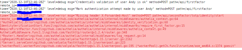

Anyone have any insight on this - I feel like I'm missing something stupid, or I've got the configuration all wrong - here is the output when I 'successfully' authenticate to the portal.
After this nothing happens when the config is set as shown below:
If I set the policy to bypass I pass right through to the redirected site, but as soon as I set the policy to two_factor it just reloads the page and the log shows Credential validation is okay. The page is waiting for something but just reloads. I can not seem to get it to pass over to Duo for MFA.
I'm pretty familiar with Duo so I don't believe its a misconfig there its as if I am missing some redirect to a 'special MFA page.'
There is no interaction with NGINX or proxy configs yet, I'm strictly trying internally, the default_redirection_url is simple google.com I just want to see how the MFA functions and get the push to allow me onto my next destination. I may be looking at this entirely wrong but the guide seemed sound just feel like I missed something.
I can hit the portal but can't setup 2FA etc.
Thanks for any help

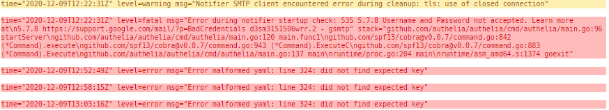

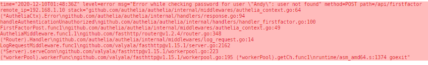

Can anyone shed some light on this? Otherwise I think ill have to start again from scratch.
Heres what ive done/noticed so far:
1. Copied your config and pasted over the one created and continued to follow the instructions.
2. At this part I wasn't sure if I had to literally type in 'YOURPASSWORD' or replace it with one of the 128bit keys or a normal txt password, So i used a 128b key.
3. When trying to start up I keep getting these errors which seem to relate to smtp which I do not have setup yet?:
4. Commented out smtp part of the config and set up txt file for notifications, tried true and false for notification check made no difference.
5. Line 324 in my config doesn't reference a key so not sure what's going on?
I'm sure its just something stupid I've done, but any help is appreciated otherwise I will delete it all and start over.
2. YOURPASSWORD is whatever you like. Obviously the more secure, the better. Just make sure it's the same in your Authelia config.
3-5. If you don't want Authelia to test for SMTP, you need to set "disable_startup_check: true". Source: https://www.authelia.com/docs/configuration/notifier/
I would recommend you actually just use SMTP such as Gmail (or your own). Because if you like it, you will need to set it up anyway.

Thanks for the reply :)
Ive tried "disable_startup_check: true" but seems to come up with the same errors. Ill try a few more things then ill re do it all over from the start.
I have 1 more question.
How else are people editing their config files?, because of the permissions I cant edit it within app data, All I can do is edit a file on my machine then copy over the file using the config edit app plugin. Which is also most annoying.
Edit: 10/12/20 - 02:00am:
Mananged to get it working by starting the config conf file from scratch, might of been a space somewhere it should of been but not 100% either way started up the container got to the UI, tried to log in using the display name and password I set in the users_database.yml and It states incorrect username and password with this error in the log:
Getting closer to having it working but im getting blocked at every turn lol. Any ideas?
examples of my config and users database file for ref:
Edit:10/12/20 10:16am
ok so after doing some more fine checking, changed the users yml to this:
also made sure that database_index: 0 was included.
Now when I try and log in it doesnt seem to throw any errors but doesn't redirect away from the login screen. I think I read others were having that issue in this thread so will go back and read up.
After doing some reading I went ahead to the next step with NPM, got my ssl for the domain with lets encrypt fine, added in the info but when going to the domain i get an error to many redirects?
Firefox gives me this:
any ideas?
Update: 12:41pm
after much hair pulling, googling, reading, shooting scrubs on Arma 3. I found out that the ssl/tls settings on cloudflare were the cause of indefinite redirect issues. I can now also log in but am unable to set up the second factor part, I now get this error:
To Overcome this error I continued on as mentioned in an earlier post. I also had to make sure that my container name was changed from binhex-jellyfin to just jellyfin in the protected endpoint config.
now to set up smtp as it trys to send the 2fa setup process via email.
Finally we are getting there xD
