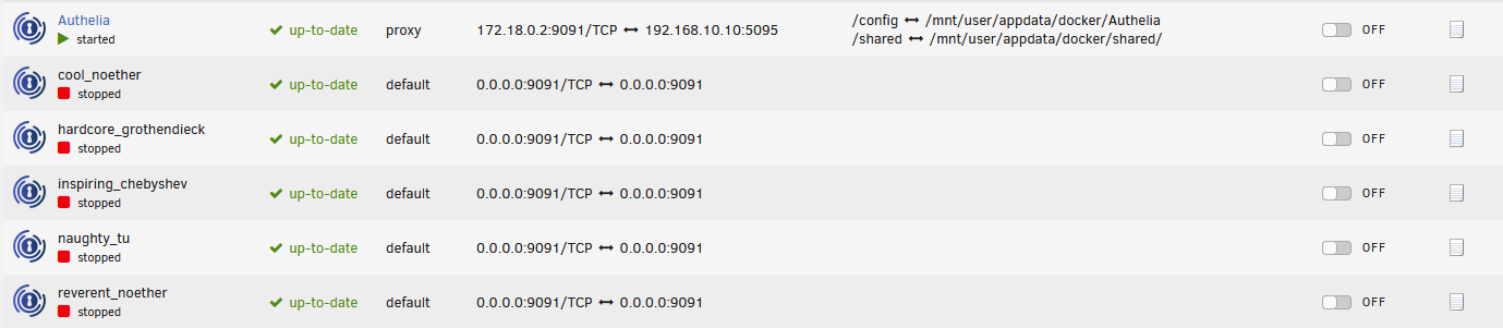

Any ideas why Authelia seems to be creating these docker containers automatically but serve no purpose?

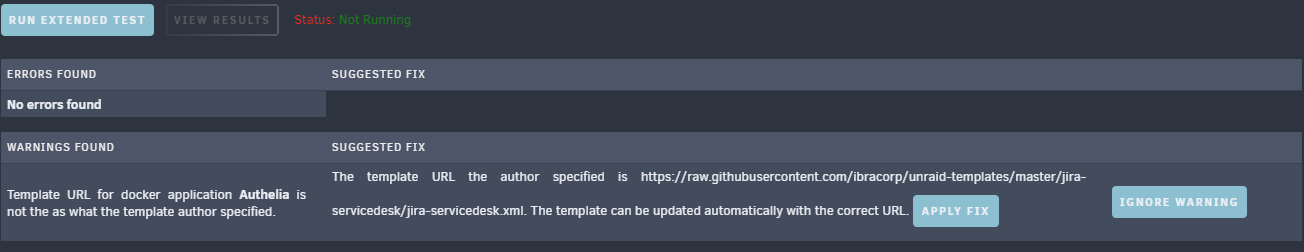

Not sure if you changed something with your templates but as of this morning I started receiving this warning in my Fix Common Problems plugin and as soon as I press apply fix and rescan the error still persists showing that the url should be pointing to authelia. I think you have two templates (Jira service desk and Authelia) both pointing to Authelia docker?image.thumb.png.42d1214f77f928f706ac6b904aac0156.png
Thank you again, appreciate you coming back here to report it. Indeed, the issue was the JIRA template had Authelia repository linked. Should now be fixed, if you could confirm that would be great. Changes should take effect within 2 hours.
Can confirm it's fixed now! thank you
Thank you mate appreciate that. Cheers
