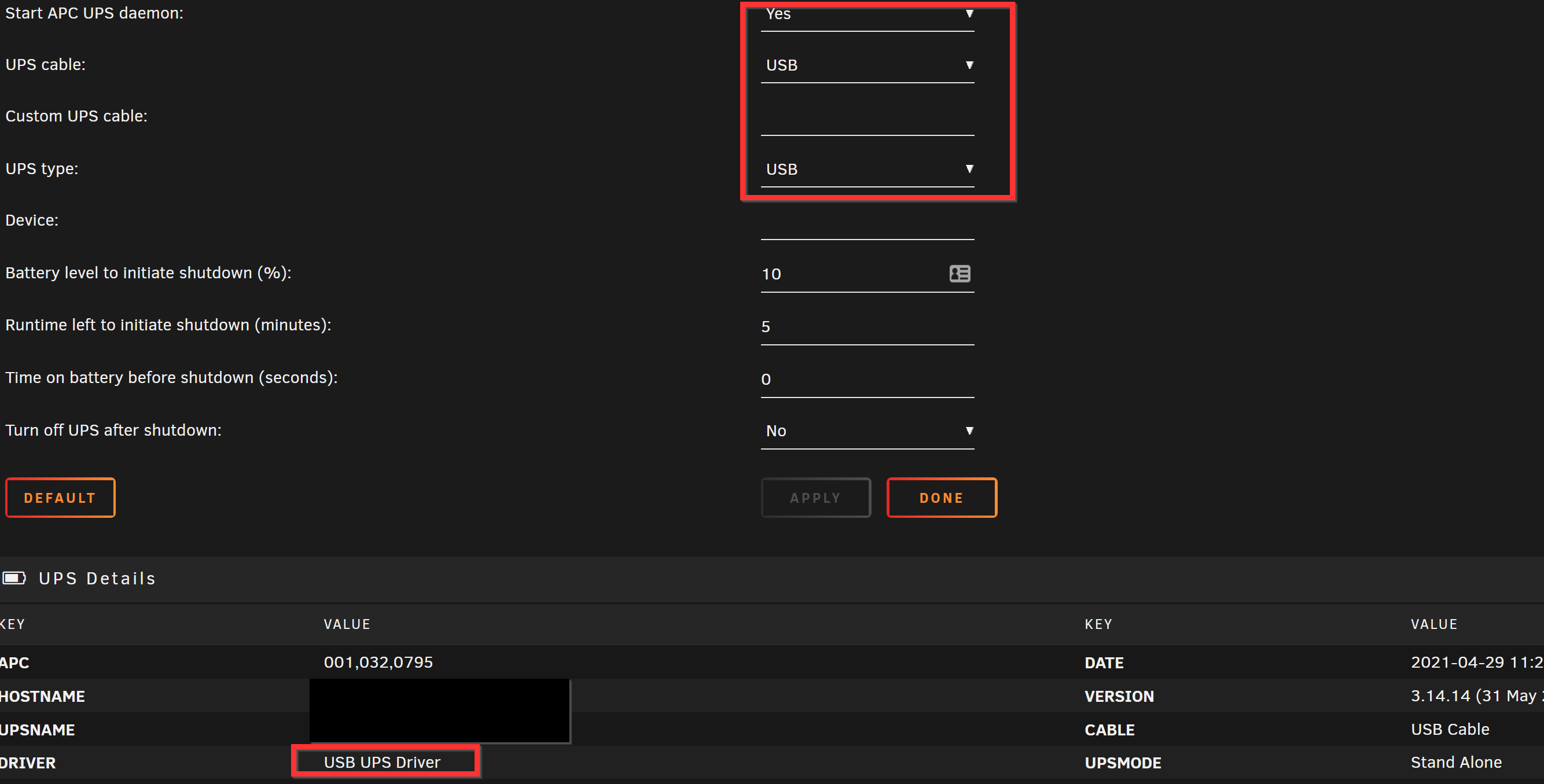

April 28, 20215 yr On 7/16/2020 at 8:17 AM, Jaster said: Update here: Bluewalker/Powerwalker works. Can I ask how you got the Bluewalker UPS to work with Unraid? I've got a BlueWalker PW VI 2000 UPS that I've been unable to establish connection to Unraid with so far.
April 28, 20215 yr Author what version of unraid are you running? I'm on 6.9.x. I just plugged it into an USB port (2.0!) and could detect it via the USP settings. I'll be testing LAN soon...
April 28, 20215 yr 10 hours ago, Jaster said: what version of unraid are you running? I'm on 6.9.x. I just plugged it into an USB port (2.0!) and could detect it via the USP settings. I'll be testing LAN soon... I'm running latest version of Unraid? But which interface are you using? Native UPS support in Unraid or NUT addon? Could you take a screenshot of the settings?
