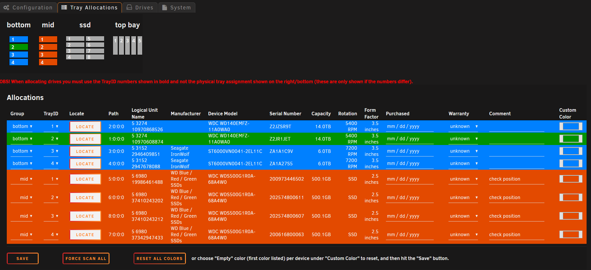

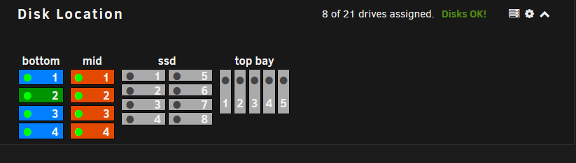

One easy way is to use the plugin Disk Location :
Replicate the disk location of you case on the plugin and note what drive is in each location.
You can create various type of setup and mix several.
You can then know quickly where to look for the issue. :)
Here is an example with my 3 data drives, 1 parity and 4 pool drives on the setup screen and on the dashboard.
