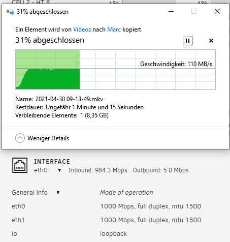

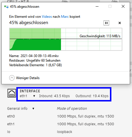

But finally it does not work as eth1 is not used:

So the first step was to disable RSS on the clients adapter:
But still no activity on eth1:

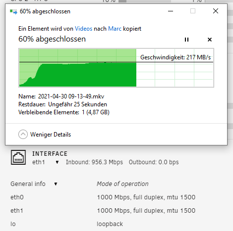

And now it works:

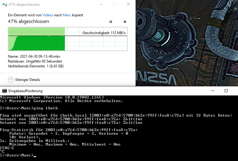

Was it because of disabling RSS? No, after re-enabling IPv6 and rebooting, it does not work anymore:

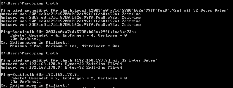

As you can see "thoth" resolves to an IPv6 address. I tried to copy to both IPv4 addresses of the server, but it does not enable SMB Multichannel:

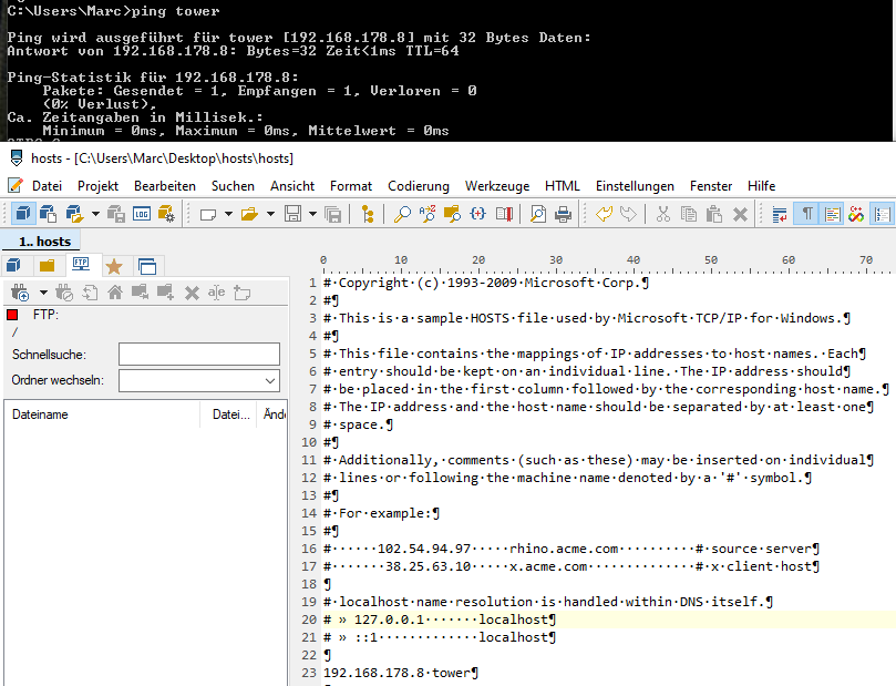

Maybe SMB multichannel works only for SMB server names? Let's try it out by adding "tower" as a new server name for .8:
again no success after copying to "tower":

And the client resolves with "ping" the smb server name with an IPv6 address, too....

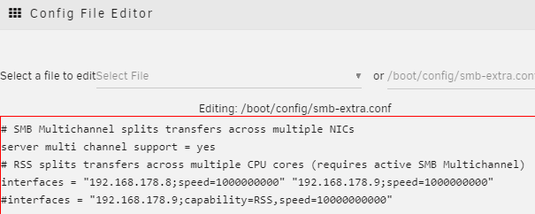

Just for fun I added the IPv6 addresses to the smb conf:
interfaces = "fd00::b62e:99ff:fea8:c72c;speed=1000000000" "fd00::b62e:99ff:fea8:c72a;speed=1000000000" "192.168.178.8;speed=1000000000" "192.168.178.9;speed=1000000000"

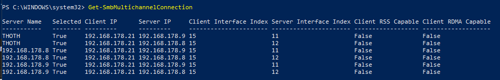

And ironically the Windows client now reaches the server through one (?!) IPv6:
Get-SmbMultichannelConnection
Server Name Selected Client IP                             Server IP                 Client Interface Index Server Interface Index Client RSS Capable Client RDMA Capable
THOTH       True     192.168.178.21                        192.168.178.9             13                     11                     False              False
THOTH       True     2003:e0:a71d:5700:e988:c813:e0d4:a16a fd00::b62e:99ff:fea8:c72c 13                     12                     False              False
But transfer speed is still capped to one....
Next try. Disable IPv6 on the client, force SMB to listen only to IPv4, set 192.168.178.8 as the IP of "THOTH" through the windows hosts file and reboot the client, but still no success 🙈
# SMB Conf:
interfaces = "192.168.178.8;speed=1000000000" "192.168.178.9;speed=1000000000"
bind interfaces only = yes

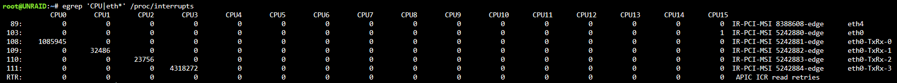

On 9/24/2020 at 1:14 PM, mgutt said:
egrep 'CPU|eth*' /proc/interrupts
It must return multiple lines (each for one CPU core) like this:
egrep 'CPU|eth0' /proc/interrupts
            CPU0       CPU1       CPU2       CPU3
 129:   29144060          0          0          0  IR-PCI-MSI 524288-edge      eth0
 131:          0   25511547          0          0  IR-PCI-MSI 524289-edge      eth0
 132:          0          0   40776464          0  IR-PCI-MSI 524290-edge      eth0
 134:          0          0          0   17121614  IR-PCI-MSI 524291-edge      eth0

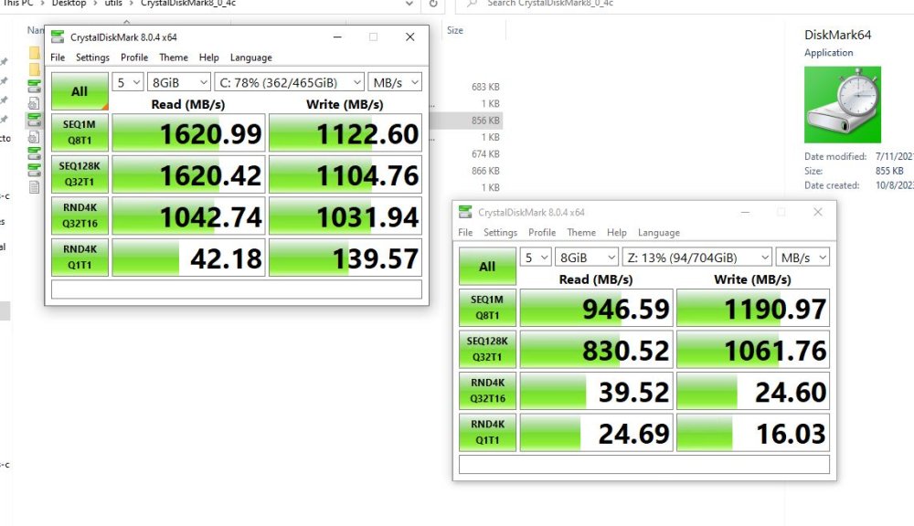

I've been trying to enable SMB Multichannel for a week. with the command, however, only 1 line was displayed for eth0. When I was in the network.cfg "old" NICs had been deleted and so on 4 lines were displayed to me

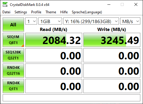

8 minutes ago, mgutt said:
Not sure why you are posting here as you probably having a hardware issue.
Actually I believe it is a settings issue. I have swapped out the hardware for testing and I still get the same results. I think the issue could be related to SMB multi thread. iPerf is giving me 6.7gbps which is way faster than what I am seeing in uploads to Unraid. Unraid is running with defauly network settings other than some Jumbo frame testing I did which made no real difference.
Which is still extemely bad. I mean 10G is 10G. Why should you only reach 6.7 while using RAM only (iPerf default).
Are you sure your cabling is good enough? Maybe you are having interferences. Try PING for a longer period and check if you have fluctuations or even package loss.
24 minutes ago, crowdx42 said:
Jumbo frame
The impact of these is low. I use the default MTU and I reach 1 GB/s without problems.
For the iPerf result I got above, I was using a Mellanox MCX311A with TP-Link SPF+ transceivers on both ends and connecting using a 25ft fiber cable. I also tried 10GTek transceivers with the same results. On FB, people said I might need to use Parrallel Threads of iperf to max the bandwidth, I am not sure how true that would be due to, if I directly connect the Unraid server to the Windows PC I get over 800MB/s. I have tried both the current TP-Link switch which is SFP+ ports only and I also tried a Mikrotik switch which has RJ45 and SFP+ on it and the results were the same.
Yes in some case / setup.

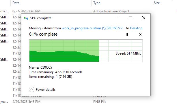

On 2/3/2023 at 12:42 PM, crowdx42 said:
I am getting around 400mbytes upload
I also got similar speed with NVMe, never reach 10G when I test in longtime ago,  but if test use memory cache, I will got full 10G SMB speed ( MTU also 1500 and no need SMB multi-channel ) ...... so since then I basically not use NVMe / SSD for cache purpose.

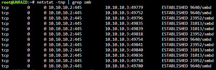

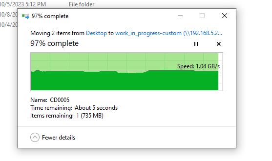

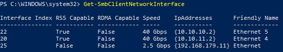

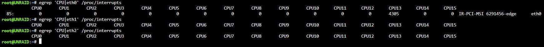

For some reason I can't get RSS to work. I have two Mellanox MCX354A-FCBT in a peer2peer config and in Windows they show as RSS Capable:
But in unraid I get zero lines with "egrep 'CPU|eth1' /proc/interrupts":
(eth0 is the non RSS capable onboard NIC)
And SMB Multi Channel is also not working. My Samba config looks like this:
server multi channel support = Yes
interfaces = "10.10.10.1;capability=RSS,speed=4000000000" "10.10.11.1;capability=RSS,speed=4000000000"
 I can write with 1,6GB/s to the Server and read with 900MB/s. Not bad of couse but the NVMe drives and 40GbE should be able to performe better.
This is related to the driver. You need to ask Limetech why this limitation exist. But at first you should boot with Ubuntu and verify that it is not a general issue under Linux.
I've replaced the hardware on the client side and RSS is working now.

Is it normal that it shows eth0 multiple times even though the NIC I use for SMB is eth1?
CrystalDiskMark Benchmark
Copy file to the server:
Copy file from the server:
Edited by meganie
Maybe need the MCX354A-FCCT to support RDMA, because it’s a ConnectX-3 Pro card, instead of non-Pro?
I’ve just been specing this out recently.  Seems like this is a major distinction between the two, at least according to Bing Chat. ;)
The non-pro variants support RDMA just fine: https://network.nvidia.com/pdf/user_manuals/ConnectX-3_VPI_Single_and_Dual_QSFP_Port_Adapter_Card_User_Manual.pdf
"Client RDMA Capable: False" is just listed because Windows 10 Pro doesn't support RDMA. That's why I would have to upgrade my client to Windows 10 Pro for Workstations to support it.
But as far as I know Unraid/Samba don't support it, still listed as prototype: https://wiki.samba.org/index.php/Roadmap#SMB2.2FSMB3
